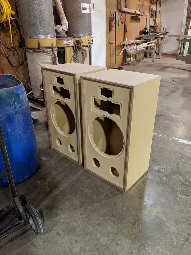

I did pick up a set of drivers for some Klipsch Chorus speakers so I decided to build some cabinets for them.
After a lot of back and forth I decided to give MDF and veneer a go, mostly because I've never done a lot of veneer and I wanted to learn the skill.
I'll probably go back and build some nice solid walnut cabinets at some point but this has been a fun distraction for a bit!
I'll post up some finished photos when I get the veneer on, be they good or bad lol

Those will sound great. Did you brace them, MDF can flex?
I used 1" for my subs but I may try birch ply for the mids and tweeters.

MDF or high grade plywood with no voids are the best wood materials for speakers.

Yep the face has another linated piece of 1/4 cabinet ply on the back to make the baffle 1", and I still have to get around to glueing in some more bracing for the large panels.
Irk those look great! I'm using a 2ply wood backed Walnut with contact cement. We shall see how it goes. Small tests look good so once the bracing is in it's time to give it a go!
Yep mdf is the best sonically. Or HDF really, but as a woodworker it just feels cheap and shitty. We shall see if I can live with them or rebuild some nice ones!

Yep, it's amazing on the CNC, comes off ready to glue with zero cleanup. It's really just sawdust and glue :D The first picture is straight off the CNC.
Stability is a huge plus too. Don't have to worry about leaving the door open, spiking the humidity and cracking a speaker.
But it still doesn't feel right to me :D
