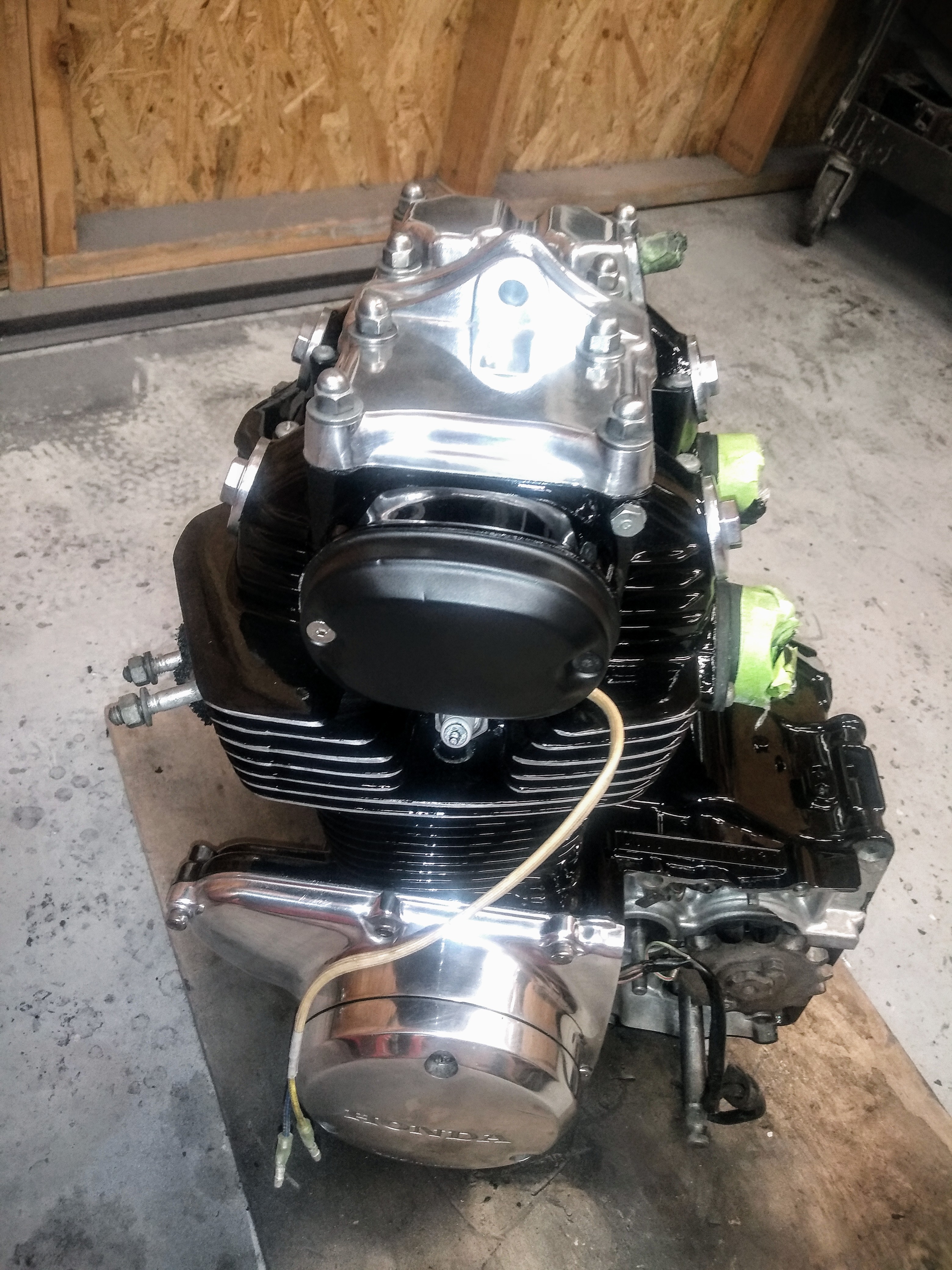

I got my cb350 engine painted, some parts powdercoated and put together.

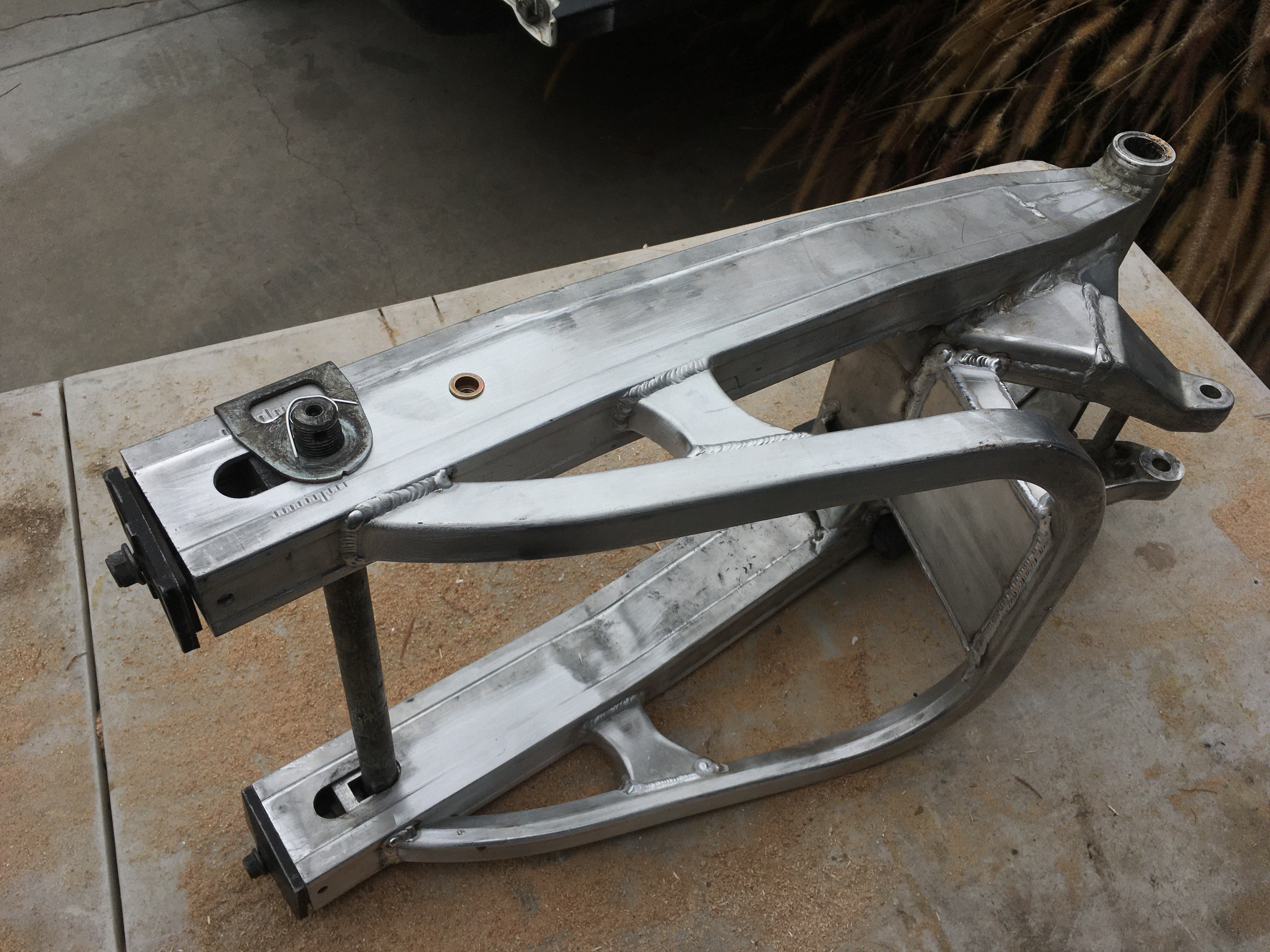

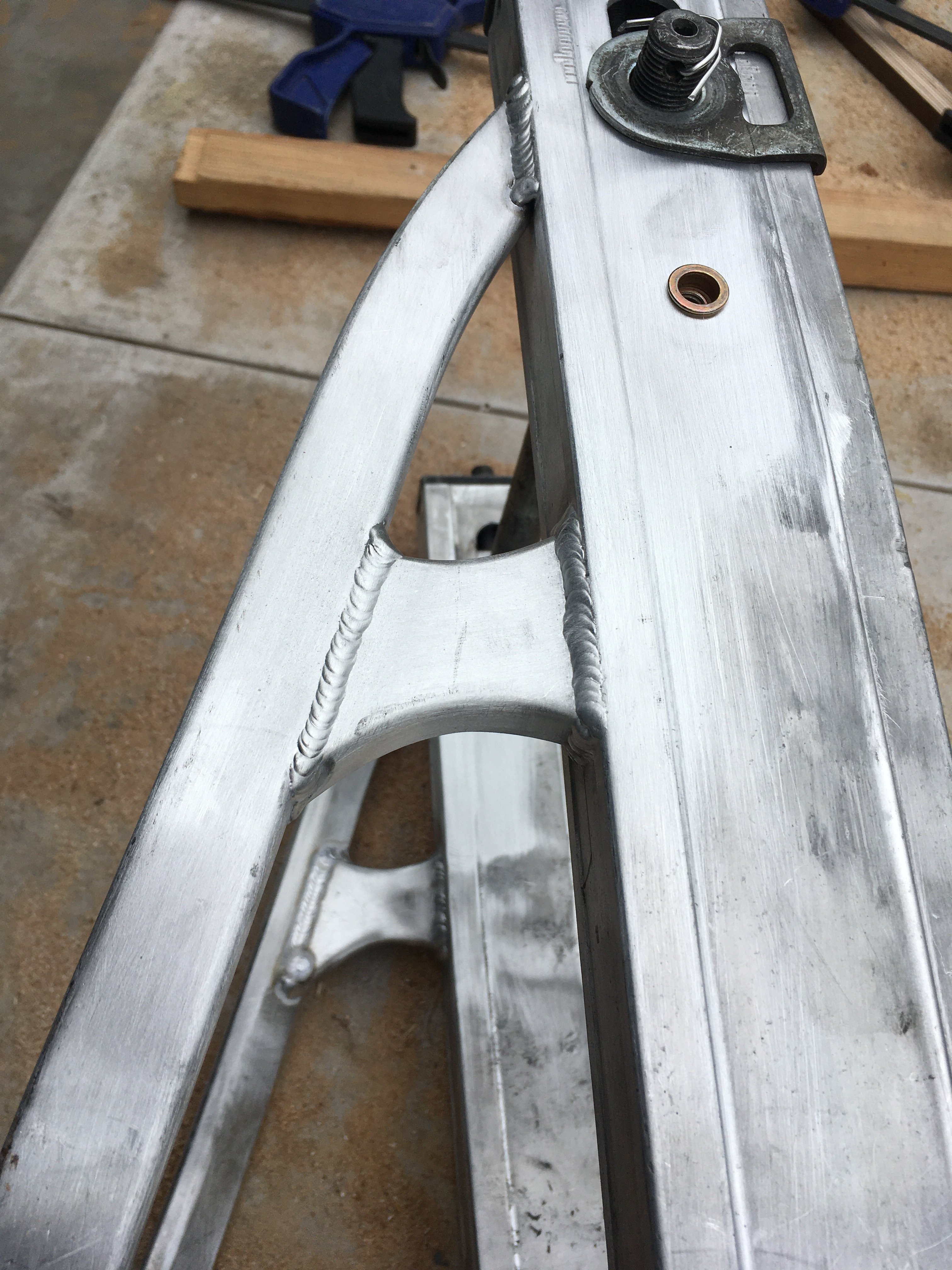

Braced a friends GSXR1100 swingarm and added a M8 rivet nut so he can use spools.
thanks guys, its nothing fancy, just my old faithful Eastwood TIG 200, going on 10 years no issues. Definitely at the limit of what it can handle at 150amps AC. its an air-cooled torch and i was having to take breaks to allow the torch to cool.
The more I weld aluminum the more i have realized the torch angle is critical for getting a good weld. I have been looking at the CK Flex-loc torch as it allows you to position the torch head in whatever angle necessary.
Right on man.. I was curious about Eastwood welding products.. I havent met anyone that had any experience with their TIG machines.. good to hear that its a quality machine.. I have a little air cooled lift-arc machine at the moment but I am looking to upgrade this winter.
I ran a CK Flex-Loc a year or two ago. It works well, but its a bit on the fragile side. I'm admittedly a bit hard on stuff, (after watching your builds, id say a bit harder on stuff than you lol) but a slide off the table onto the shop floor ended its days. Now I usually just run a flex neck Weldcraft A-150. It may not be as neat as the CK, but seems to hold up better.
Really nice looking welds. Fillets like that aren't the easiest to achieve.

Question about using rivnuts for spools... Have you done this before? And to what degree of success?
My experience has been that rivnuts tend to loosen up with repeated side loading. This may entirely be isolated to just my experience though.
I'm not bashing or flaming, just trying to learn/understand.
They are pretty lightly loaded, less than 100 pounds each. Also this is how Yoshimura did them on the GSXR 750. I think it will be fine. Worst case I drill them out and go up one size.

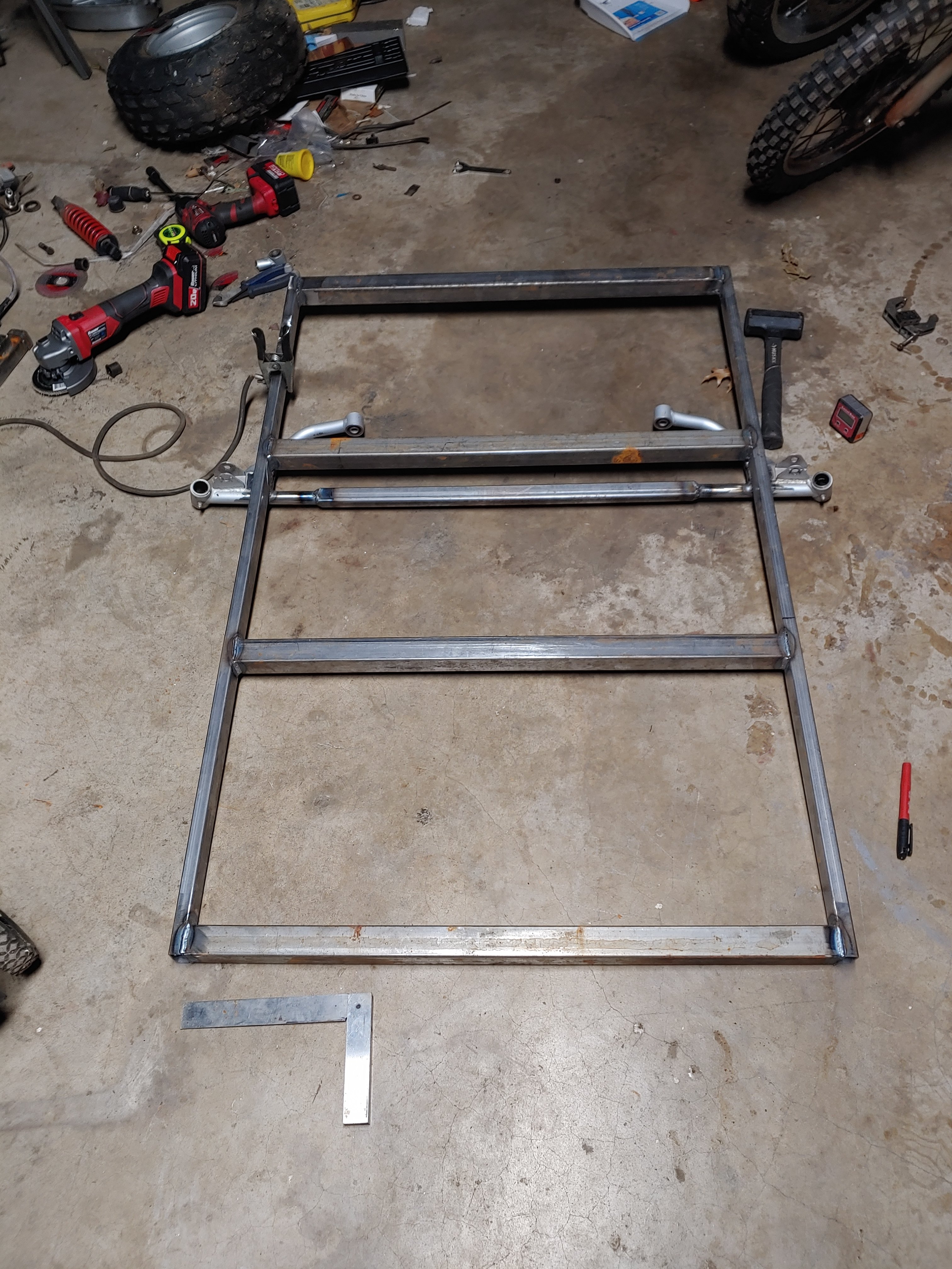

Working on a small trailer to tow behind the atv. 32"x48" bed, it's using the spindles from an outlaw 90 atv for the wheels brakes and hubs. So far the frame is made out of scrap from an ATV crate. Still needs a tongue and expanded metal for a floor. I'll probably add a few braces to help stop the expanded metal from sagging.
Just for yard cleanup?
