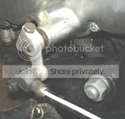

Had to go back to the rocketbike junkyard where I got the rearsets and get the factory linkage yesterday.
Seems as if one side of normal thread, and the other side is reverse thread. So I figure it will be easier to have
the stock linkage lengthened then to make one from scratch. Always helps to have friends who build
7 sec racecars a phone call away ! ;D
Here's some pics of the finished rearsets on the CB/CL450 Project...
Once the bike gets running better, I plan to move the up and forward alittle, as now it is alittle
hard to shift (way too far back)...
