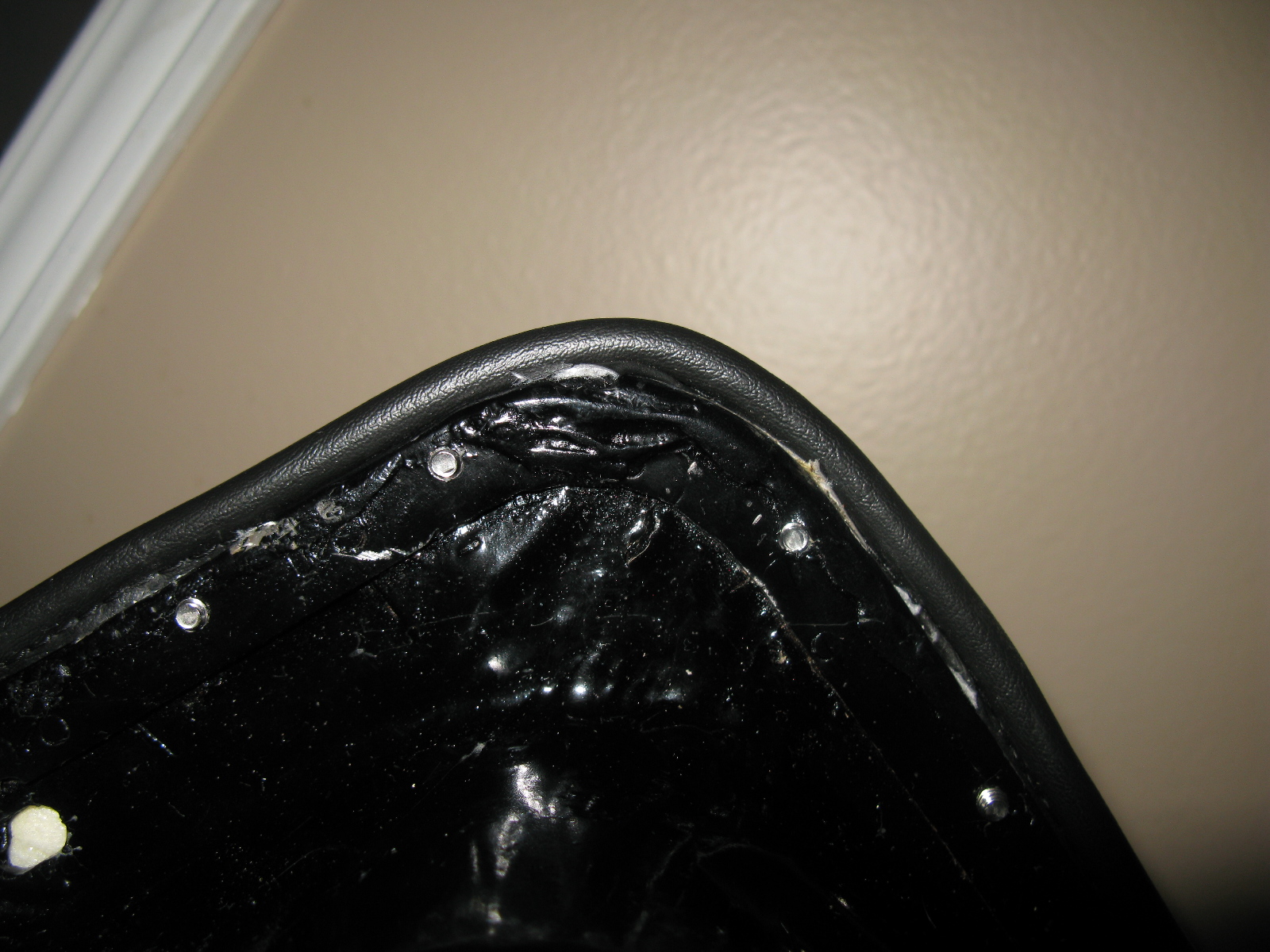

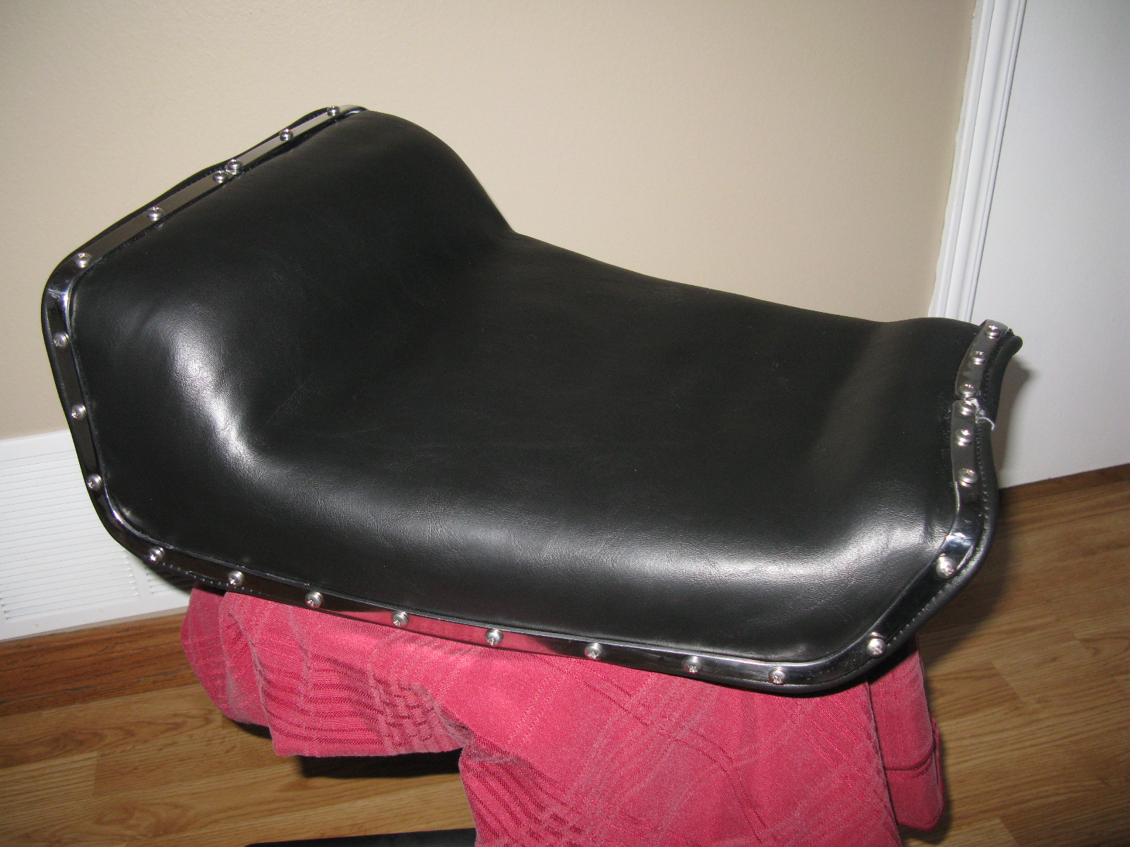

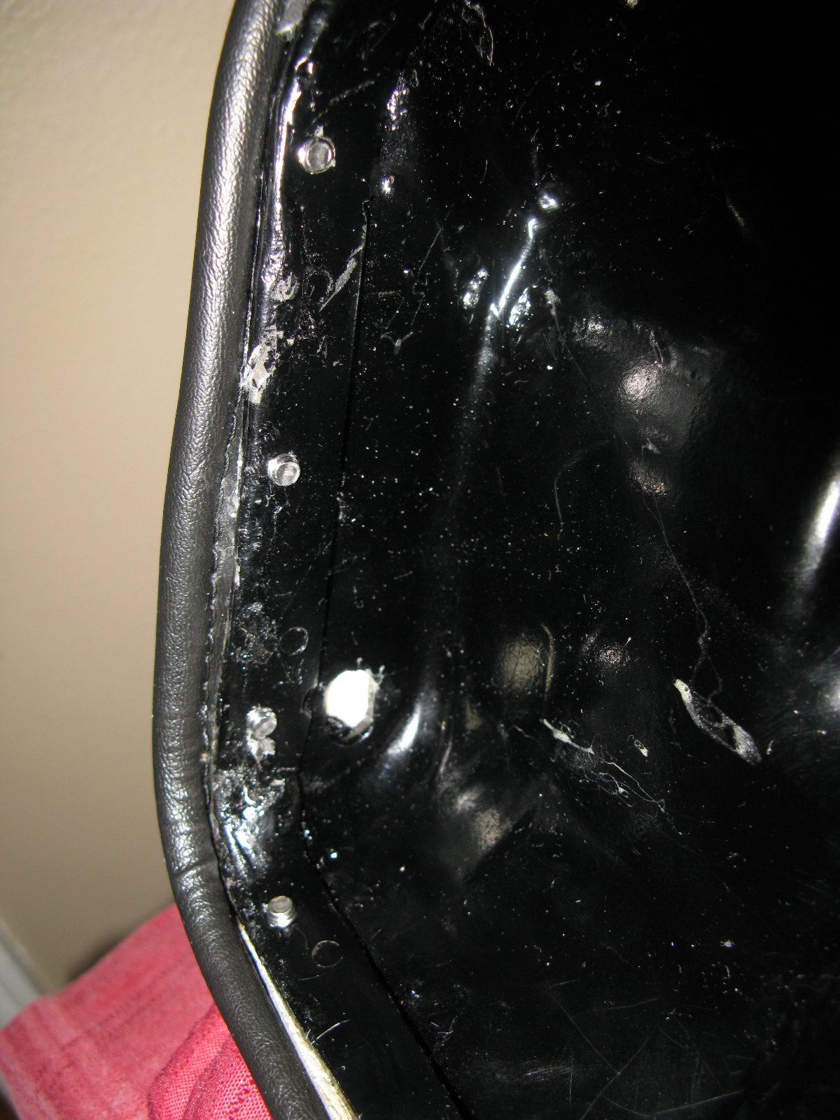

Typically a seat pan is 20 or 18 gauge. Here is what I did on my custom Brat seat. I tacked on a 1/2 bu 1/8 steel on the underside, then I tapped it for the stainless screws from the outside. Made a matching steep plate for the outside. Had the upholsterer do a bead edging so there is no under wrap.
it looks clean and is easy. upholstery cost me 150 Canadian.
