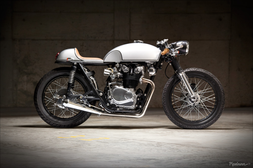

hey guys was wonderin what wheel setup this below bike is running? i also have a cb450, but my rear wheels looks as if it could be from another bike possibly? it seems smaller than other stock cb rear rims, could just be me.. i will grab sizes tonight when i get home.. but for now, my question stands to what wheel/tire setup this is.. thanks!

Yeah I'd say that's the stock rear 18" rim, but it is tucked in all the way forward near as I can tell.

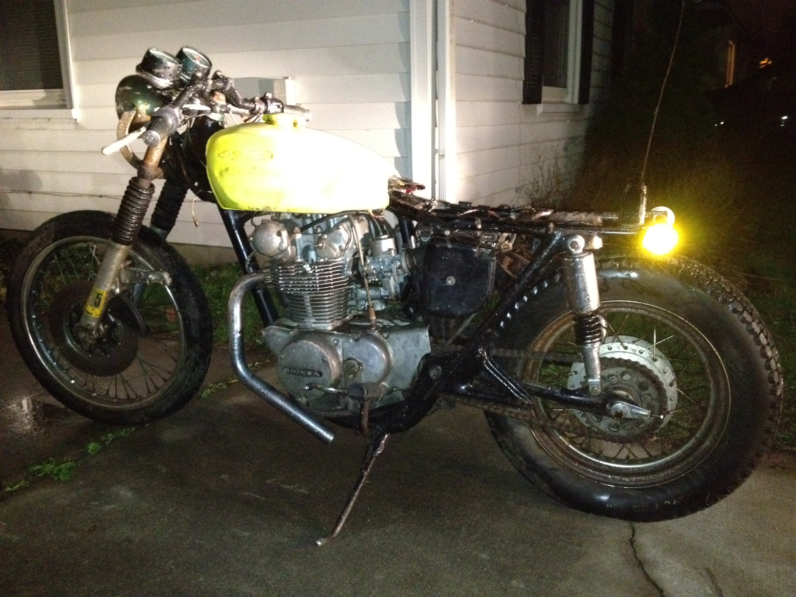

here is a pic of the rear wheel that was on the bike when i purchased it.. seems small no? im looking at spoke length and just seems pretty small compard to the pic above. thanks guys for the help

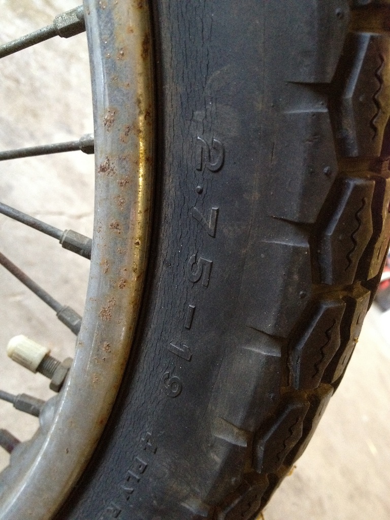

i suppose by looking at pictures wont help, i will have to just wait til i get off work and check the wheel size on the tire in person.. is that the normal wheel size, 18" rear, and what size is up front, 19"? do people go bigger than that?
here are a couple pics of the tires on the wheels i have, looking like the front is the standard 19", but the rear is a 16"? thoughts on this?

Looks like the standard Harley rim that alot of people have swapped on CB750s and CB550s/500s. One of my bikes came with one laced up. I'm pretty sure the CB450 never came with a 16" rear stock. If you like the 18" rear better I'm sure you could find an original from a CB450. I bet Honda used that exact size 18" rim on a couple different models of CB/CLs.
i definitely like the 18" rim better, so would it be best to tear the wheel down and re-lace it up with new spokes and a new rim?
The good news is you're due for new tires anyway. Looks like an excellent time to get spoke kits on ebay (search for them - they are there) and some new hoops. Then you can get some snazzy new tires mounted up and be done with them for a couple thousand miles.

The tyres are massivly oversize for the rims, rear is bulging a hell of a lot.(bought a new video card so can look at pics on full size 23" monitor :D )
