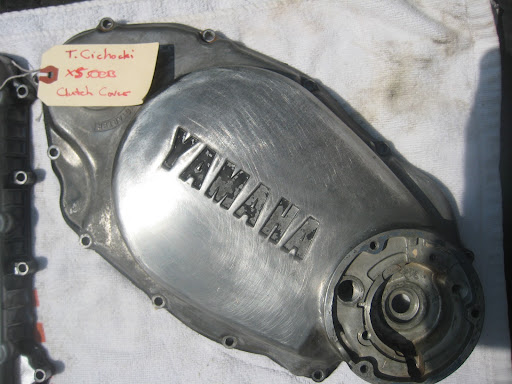

I had my motorcycle parts chromed. I'm sure you could go local but I went by reputation and quality. I used Chrome Masters (http://www.chromemasters.com/). Basically it's what OCC uses. Prices are high for chroming in general but it was still better than other competitors like Brown Plating (http://www.brownsplating.com/).
I think my total for valve cover, left engine cover, right engine cover, logo cap, and timing cap came to around $400 something. Turn over was 3-4 weeks. Only bad part.
Before:
After:
if its alloy i say polish it! way cheaper, deeper finish. harder work though. also chrome is more weight!
