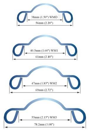

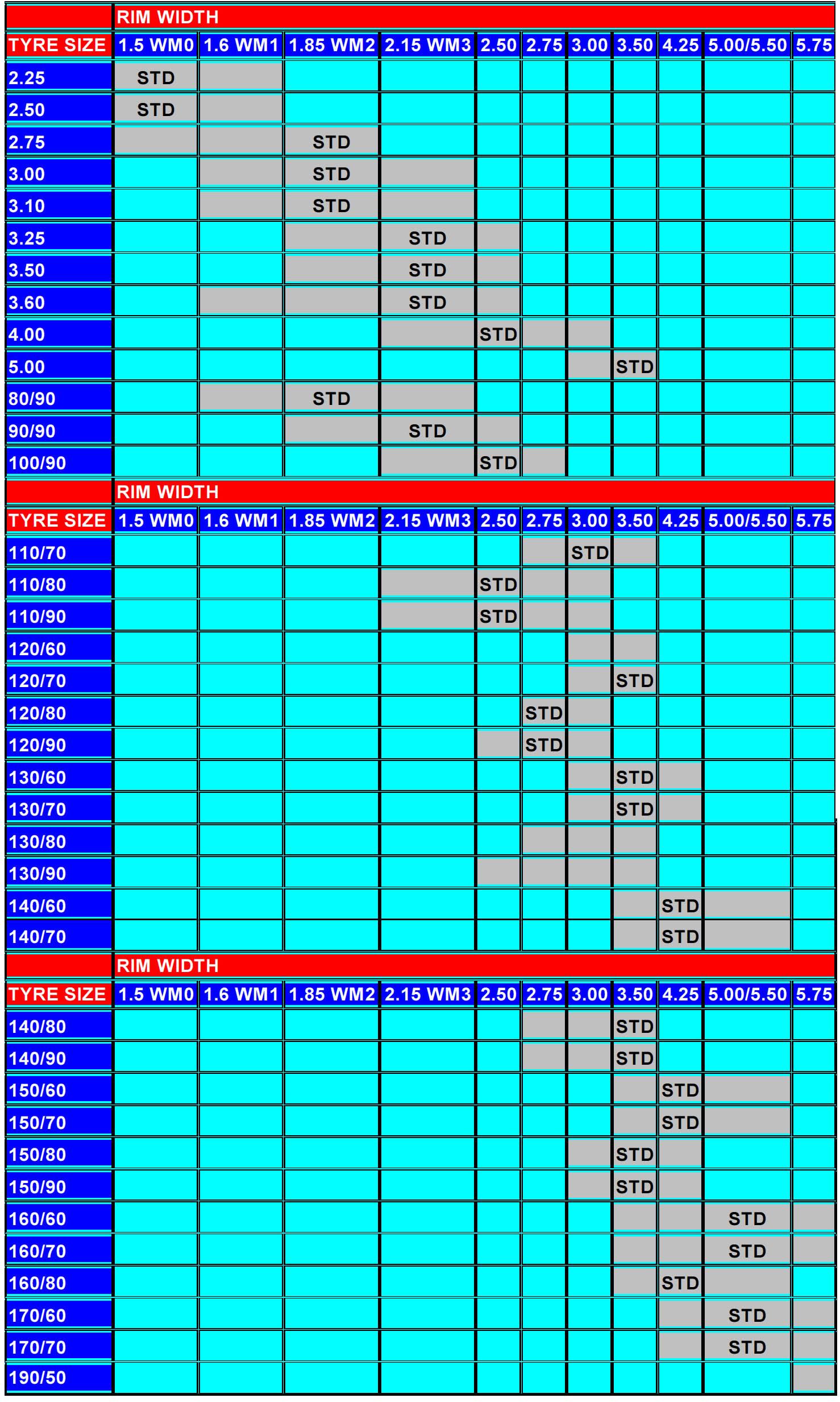

There is also a chart for rim width recommended for the tire size. Stock rims are usually the smallest acceptable rim for that size. If you want a safe change to a wider tire, then you usually need to go to a wider rim. The areas in gray are acceptable sizes for the rim width in the chart. The second chart shows how to measure rim width.
If you mess this up, now that you know, any poor handling or wobbles are your own fault.
