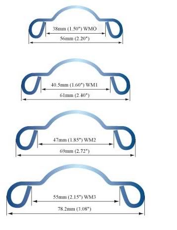

Putting Wide Tires on requires the right size rims.
Handling get compromised when the rim and tire widths are mis-matched:
