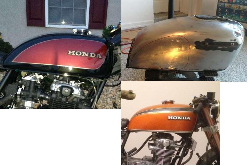

Hi.
congratulations for the project. The CB550 Café Racer was very beautiful.
I would like to ask you: How did you do the gas tank? What gas tank did you use?
Regards
Paulo
Brazil
