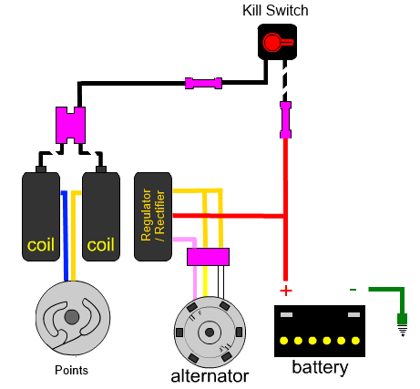

I want to test run the cb350 I have been working on. I was just looking to eliminate everything except what will make the bike run, anyone have a diagram for this or simple instructions?

Yup. Positive terminal from the battery to the coils (black/white wire) and then negative terminal of the battery to the frame. Should last you about an hour or so until the battery is dead.

Maybe a better question to ask is, what do you want to remove? The bare minimum to run is:
coils
condensers
points
Alternator
rectifier
regulator
battery
a switch to cut off power
The only extras on a CB350 are the lights, starter and starter solenoid, horn and the few switches and buttons to operate those things.

The OP said he wanted to test run his bike. By that I assume he wants to fire up the engine to make sure it is working. I did the same thing when I was rebuilding my bike after I wrecked. I didn't want to do all the work only to find out it didn't run any more.
I hooked up the power to the coils and ran it for a few minutes to make sure it was still fine.
Doesn't get any more bare-bones than this...
Includes the charging system so your bike won't die while you're riding it. Skipped fuses (so harness will catch fire if you short out) and the ignition switch has been replaced with the kill switch. Also swapped over to a Kohler R/R ($25 part) to replace the individual regulator and rectifiers. This simplifies the wiring even further and is actually a bit of an upgrade when compared to the stock system.

Sonreir thanks for the diagram this was helpful.
I did search for this but I was unable to find exactly what I needed, that is why I asked. I am trying to understand how to read these diagrams accurately and I thought I would start with one that I would quickly understand.
