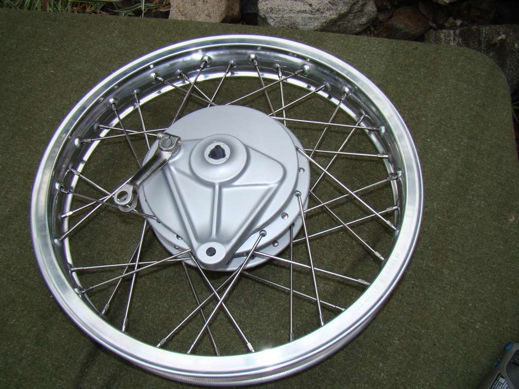

Here's the XS Mikes Shouldered Rim 2.15 x 18, 36 spoke rim for a CB360. Used Buchanan's SS spokes and nipples, duplicolor Aluminum Engine paint for the hub.

I am putting the XS Mikes 1.85 x 18, 36 spoke rim on the front, but haven't laced it up yet. Using Buchanan's SS Spokes for the front too.
You can see the progress at HondaTwin.net http://www.hondatwins.net/forum/viewtopic.php?f=5&t=16466&start=70
The front hub is painted and clean, but it's still a work in progress.

The Front has a 3:00 18 Tire on the 1.85 x 18 rim.
Here's the front done:

Front wheel laced up! Had one side a hole off the first time I tried, but I got out my spare front wheel and counted holes and got them right.
Your going to need the bearings and bearings and bearing spacer in there to be able to true it.
Looks good though ;)
Looks nice....
Remember when truing it, you need not only left and right being straight, but circumference being centered.
In other words, the center of the bearing is more or less exactly the center of the rim.
some people forget that. They get the left right done and think it is good, then wonder why the bike feels like it has oval wheels....
