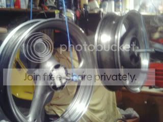

The wheels had nitromors paint striper applied then wet and dry ready for next stage.
Etch primer in thin coats sprayed on then put some normal grey primer on at same time as the swingarm.

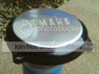

They probably look better than they really are but were only meant to add a bit of detail to the engine. The previous owner for some reason hand painted everything with what seems to be dish water. So after a new coat of black gloss as well i clear coated them to save me having to continuosly having to polish.
Still got to degrease rest of the engine yet and that will have satin black applied so the cases should stand out a bit. :D

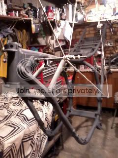

Heres some pics of the frame and some of the alterations.
Got rid of the standard foot levers early on but left the frame weak so some stengthening plates been added.

Carried on with the prep work on the frame...wanted it too be a bit smoother especially where i was bit over enthusiastic with grinder :-\ :-\, also welds needed smoothing in.
Happy at this point so onwards and forwards...... :) :) :) :)

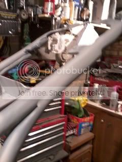

After a good degrease and clean up a couple of thin coats of etch then normal primer applied.
Happy with the results,the frame tubes alot smoother and mounts like rearsets are more integrated into frame rather than just added extras.

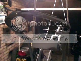

All i would have to do is remove the subframe rear loop and add a flat bar....doing this anyway would make it easier to add any type of light.
And just out of interest moked up a hump with some wire to see if it left me enough space under the hump for the battery...new gel batteries are smaller too so will have more than enough space..

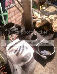

rubbed the yokes down and quick coat of primer......these were then painted with satin black, again as had used U-pol for primer and been impressed used it for the top coat.

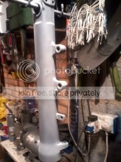

The nitromors came out again and the forks given a good seeing too, then again etched and primed.

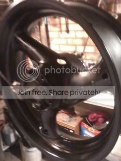

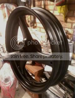

Decided to use gloss black on the forks, the front wheel painted at the same time....
Feel alot more confident when spraying now, quite nervous before but learnt some lessons along the way.
Always warm the can up before use as certainly notice the difference in the spray pattern, Fuller even coats rather than piss arsing around and going back to do little squirts.......Yeah just need to clear coat the forks and wheels and clean up the spindle and clamp bolts and can reassemble.... ;D ;D ;D ;D ;D

Right... managed to get some clear coat on the forks and wheels. For some reason i was a bit scared of f***king them up and having to rub them down again but everything went fine. The only ball ache was when spraying the rim you would get over spray on the other side but got over that hurdle in the end. Going to pick up some fine G3 compound and give them a quick once over.
Will be cleaning all the gubbings up today so i can get all this lot bolted together.
very nice man... run some 2000 grit over them first wiht a bit of dish soap in the water... then the 3m, they will look a mile deep after that
Cheers for that dude........any advise is greatly received and thats something i probably wouldn't have done.. :) :)
Just thinking of the satin on the yokes is there any way to protect it a bit, i know you can get matt clear coat but is there anything for satin?????
problem is clear out of the can on parts that are int he wind like forks, wheels, and trees tends to chip and flake from rocks... i have used rustoleum painters touch (has a satin clear) on my tins and plastics before and it works out great but that is away from road grime but it work awesome! i have never laid it as a clear over anyting but painters touch paints but you can give it a run
With some great advise from JRK got cracking on finising the forks and wheels. Used 2000 grit and lightly rubbed down then used G3 paste to bring a really deep shine on, to say it is rattle can and my first attempt gotta say i'm impressed.
Gonna put discs and tyre back on, then will be servicing calipers and running over with some satin black.
Slow going but at last some progress.

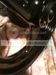

After my success with frontend pretty much the same with the rear wheel.....
So thats both wheels done now....

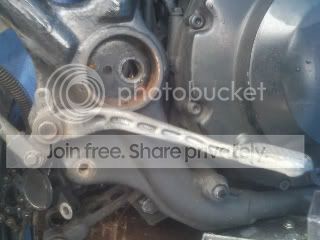

Also been painting other sundries like brake arm, gear lever etc.
Its deciding what to paint in gloss or satin thats hard....been experimenting with gloss, satin and clear coated satin to see what finish looks like.
