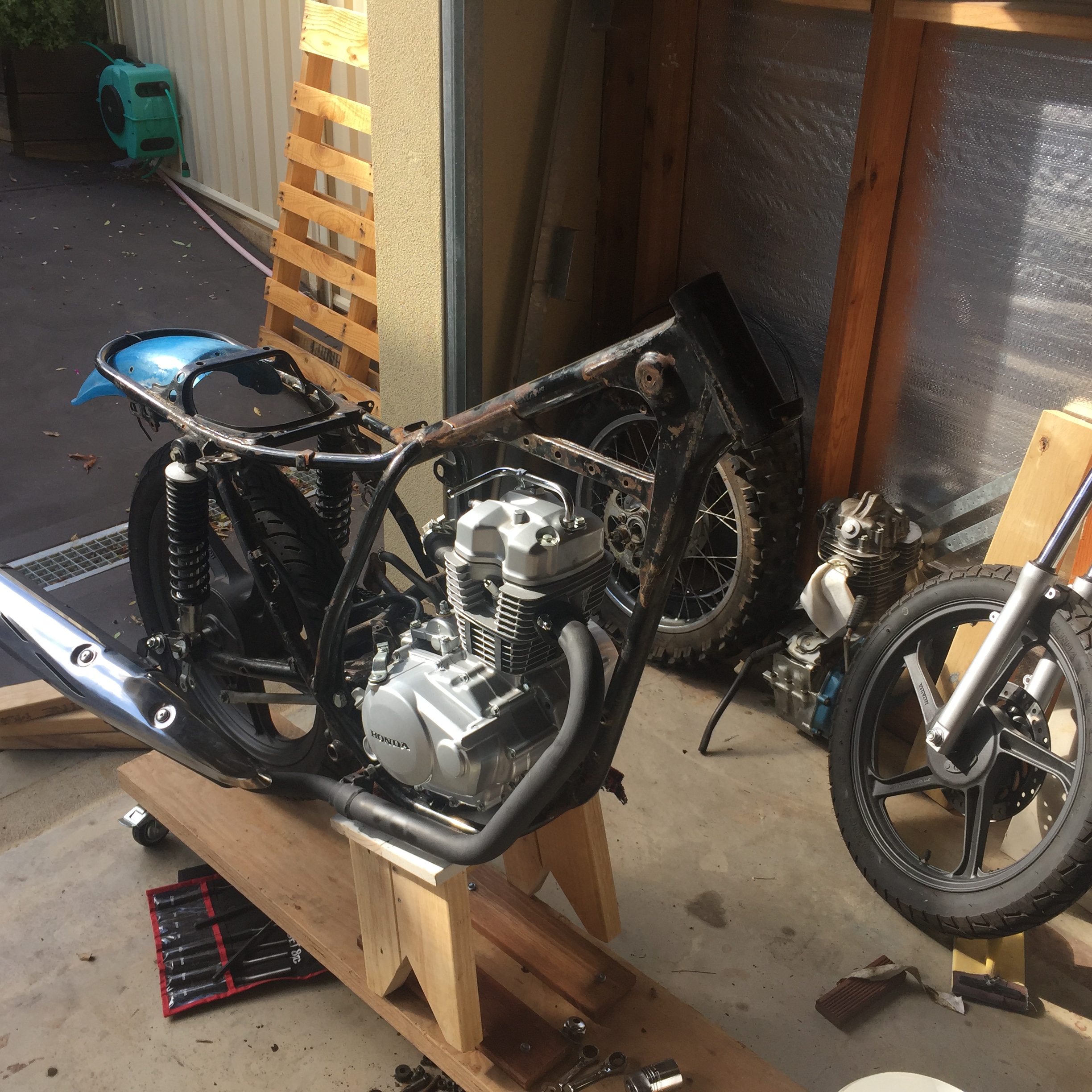

After the stripping down of both bikes I took the best features from each and put them all into 1 frame.
I decided on using the XL175 frame for 2 reasons.
1. there is no register of it being a commercial write-off and easier for road registration
2. the preferred styling of the XL175 (tank & seat, side covers etc).
During the trial fitment of the donor engine in the XL175 I was pleasantly surprised how many parts were direct bolt on or very near.
The 2 rear engine bolts matched up perfect with just 2 spacers needed and I need to have the front engine mounts fabricated.

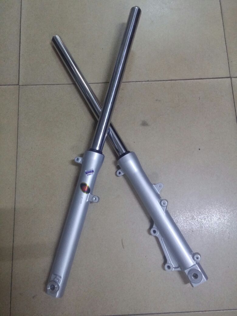

The CB125E forks on the donor were bent so I ordered 2 new replacement forks from the OEM manufacturer in China U$D 56 pair (A$85+ A$100 freight) the Honda RRP list price is a crippling A$417 each (A$834 pair) on a bike that retails new for $2400 on the road. I cannot understand how Honda can justify their mark up.

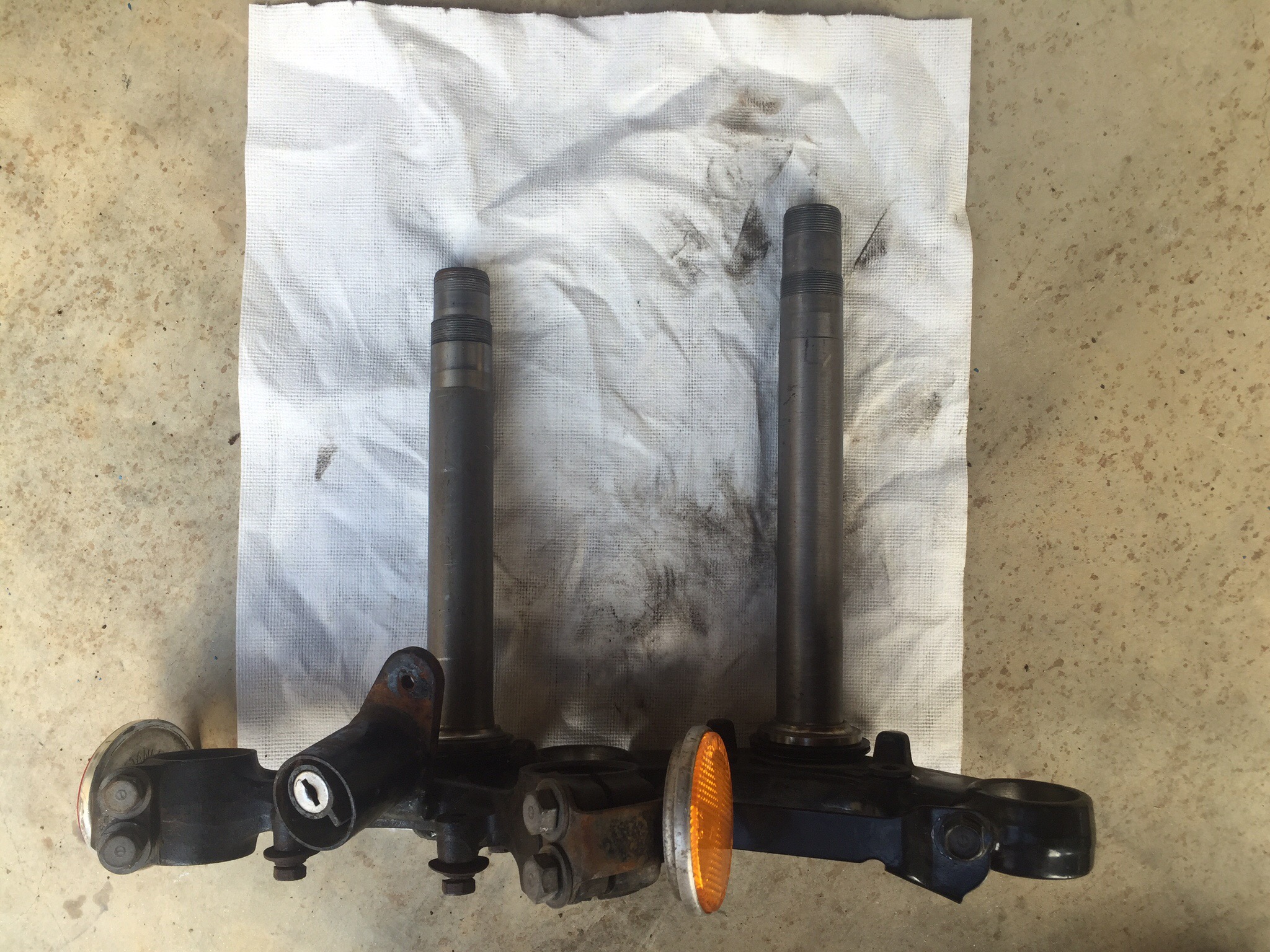

The decision was made to use the CB125E triple clamp, this would allow the fitment of the steering lock, speedo cluster, head light etc with little modification. The main issue was to have the steering yolk going through the head stem reduced in length, requiring new thread and reduced thickness.
Using the CB125E forks allow the easy fitment of the front wheel including the 2015 disk brake and speedo sensor.

8. Triple clamps shortened int he the previous photos

Also the replacement forks turned up a massive saving thanks to Aliexpress

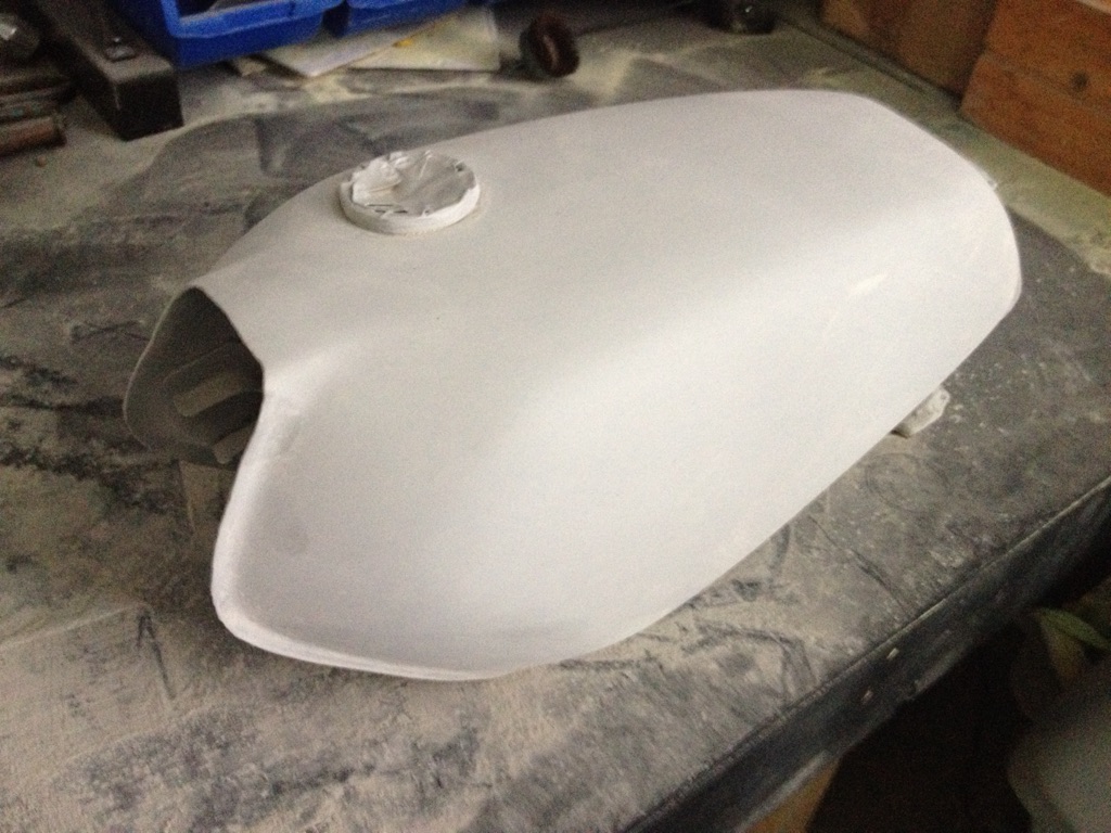

The fuel tank was originally blue dented and rusty need to be straightened, sand blasted to remove external rust, printed, black layed before the mars orange and clear coats added.
I sent the dent and paint work out to be done professionally as I needed it to look 100%

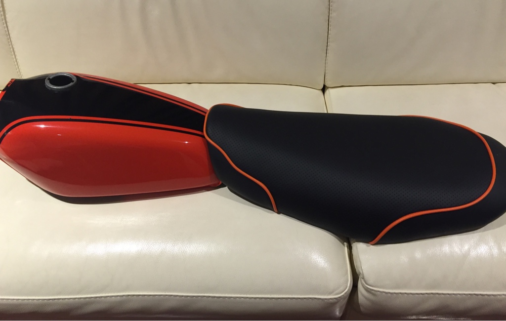

Reupholstered seat came back today.
I wanted a usable seat with more modern lines using existing seat pan. The original foam was cut down and shaped to more modern styling but still keeping enough foam to make it an enjoyable ride. I was really happy with the orange piping helping to highlight the upgrade. Thanks to Darren at Castle Trim, Edwardstown SA for the great job.
I did another quick assembly to make sure every thing looked okay before I striped the bike again to send it off for blasting and powder coasting
here are a couple of quick shots roughly assembled before the seat arrived home

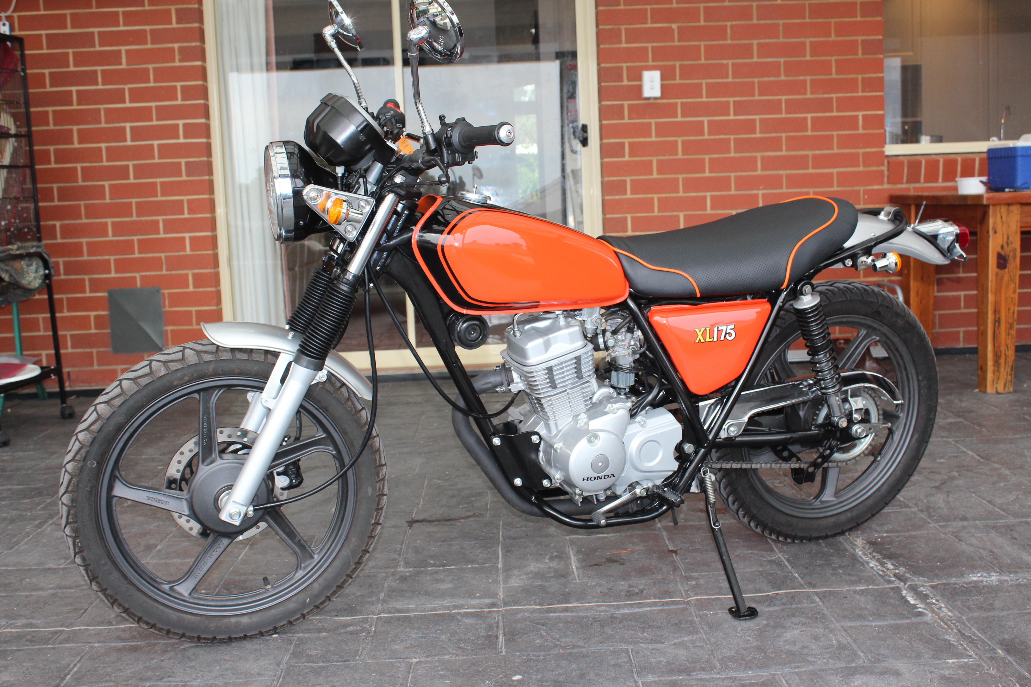

Here are some better day time photos with the bike assembled
Things to finish
The header pipe and new akpropovic muffler to be installed next week
waiting for the new lithium battery
Stainless counter sink hex bolts for the tail light assembly
Honda XL175 tank decals
then off to get inspected for registration.

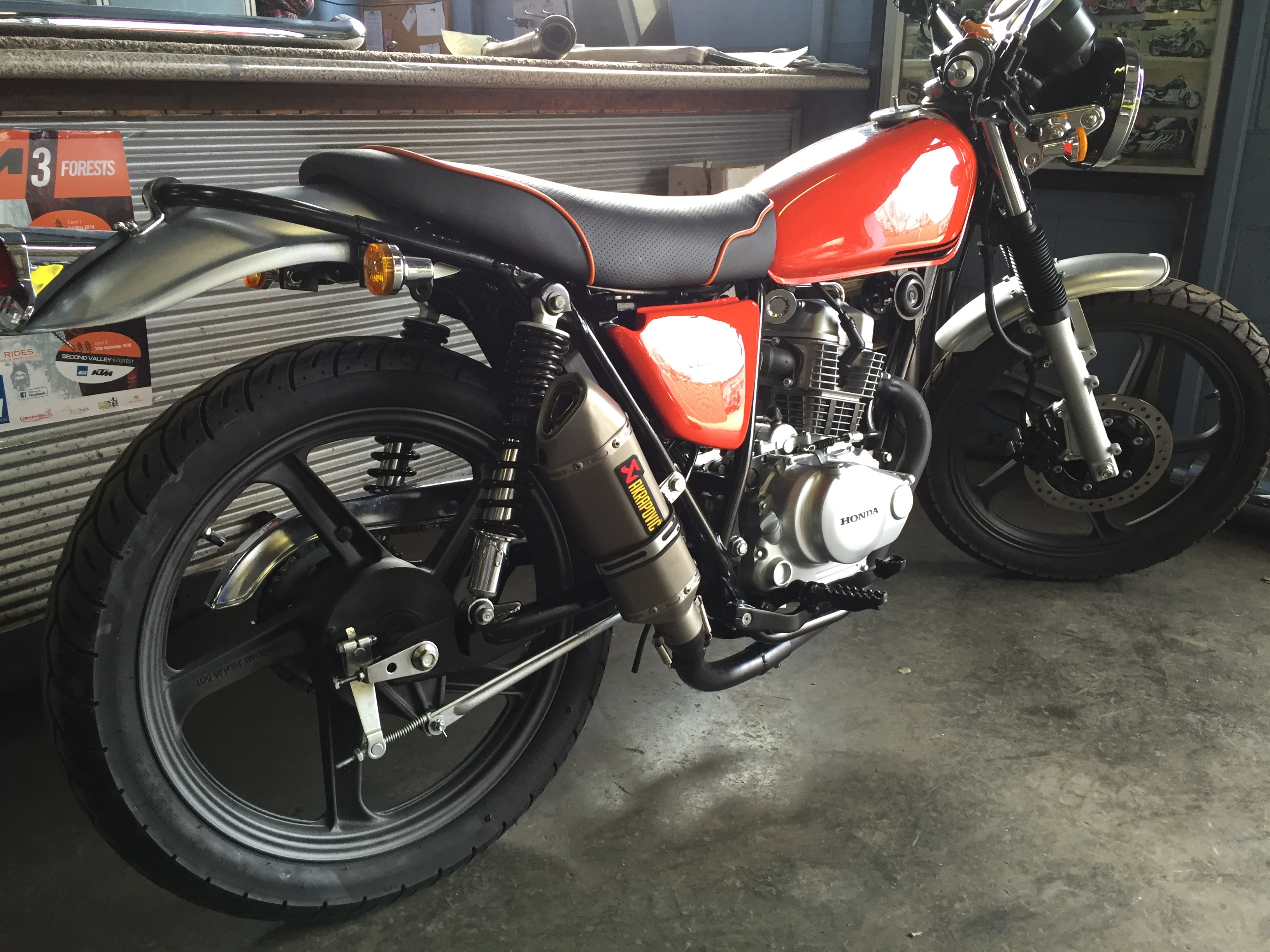

I just had a new headed pipe fitted by local company Redline exhausts, Thanks Terry for the great job.
The muffler I purchased online thanks to Aliexpress ~A$80 delivered most of this price was freight
I am not sure its a genuine Akropovic but it looks good and the quality appears ok.
I do not think my 125 engine is going to put too much pressure on the muffler designed for a litre bike
