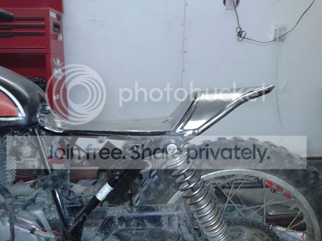

The tail got hacked off and I started cutting on some 3/4" tube. Seems it wants some moto gp flavor, I didn't see that coming
So I took some more sheet and followed that theme
And a seat pan
So that's progress so far, I'm pretty excited to see what happens next...

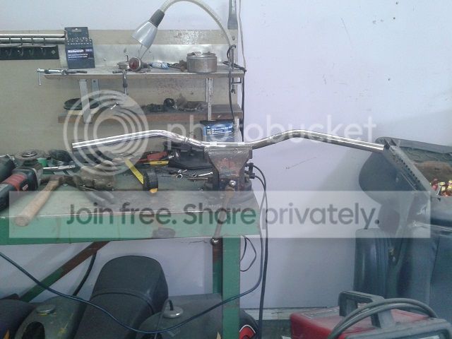

Got a little more done tonight, cut down the stock bars. I put a sleeve inside and did a bunch of plug welds, hopefully it will be strong enough without the cross-brace.

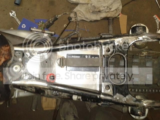

I picked up a little 6v battery and made a tray for the electrics.
This bike is kick only and I plan on making led lights for the tail and signals so I think the battery should be sufficient to keep it running smoothly.
