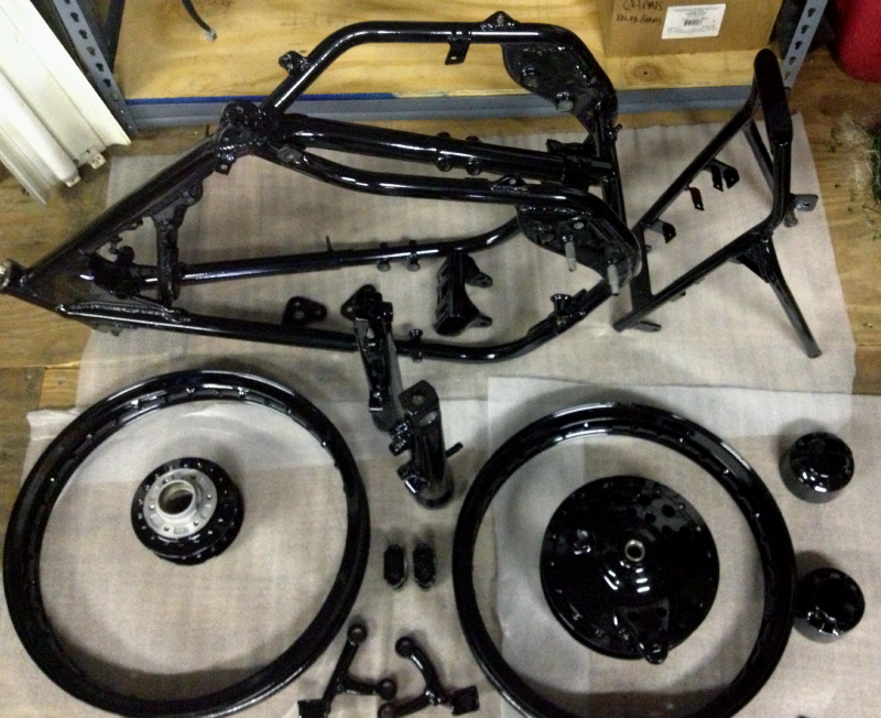

Making some progress. I tore the bike down and cut off all the unnecessary BS off the frame. Sent everything off to powder-coat. Luckily my PC guy rides and always needs someone to work on his bikes so I cashed in. Already got all my Gloss black parts back. Going to have him ceramic coat the exhaust system for me. Should have my wheels laced up soon, just waiting on spokes from Buchanon. Some pics of the PC stuff.

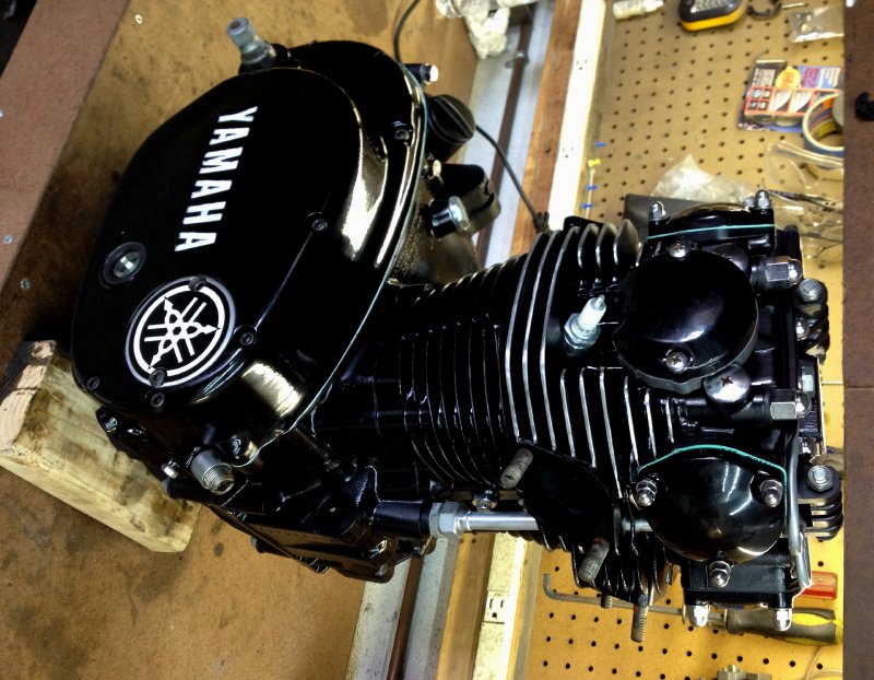

Painted the motor black although both engine covers, points covers and rocker covers are powder coated. Took care of some details like painting the YAMAHA logo's and installing mesh behind the flywheel cover. Really happy with the way it came out.

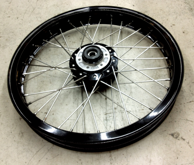

I also laced and trued my wheels. Still waiting on a couple of things from PC. Also need to get my paint work done, but I'm gettin close.

Wow. Top work on the motor, man. That looks outstanding, and the mesh on the sidecover is really well done.
