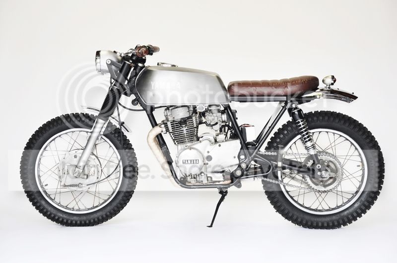

XS360 Bratstyle Replica- Codenamed: Sheeple II

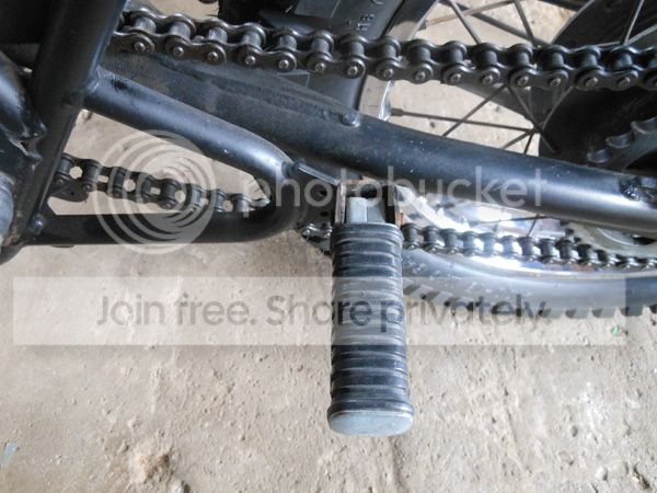

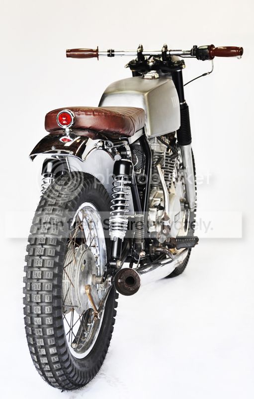

a proper bratard needs passenger pegs for the lady hipsters to ride along. I mean this will be a chick magnet, no?

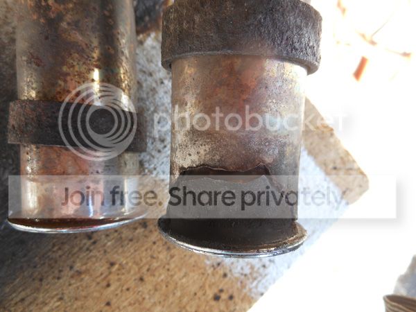

the bike didn't come with any, so I cut down these from a yamasomthing , cleaned up and pinned

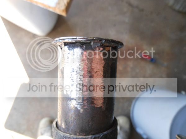

fixed some exhaust header cracks

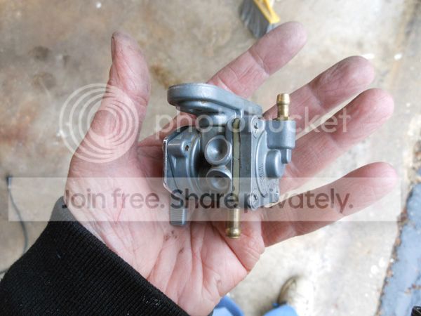

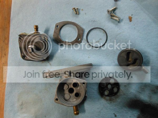

cleaned up the petcock.. I hate these vacuum units- but with some suckie/blowie tests, looks good !

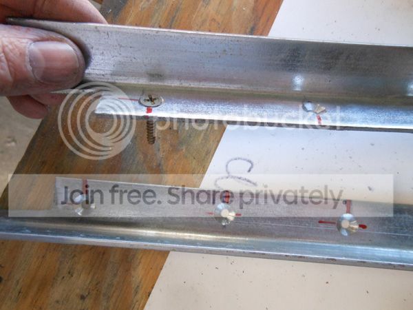

finally set the seat rails up with mounting holes, screws will go up from the bottom into the pan

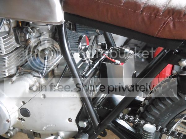

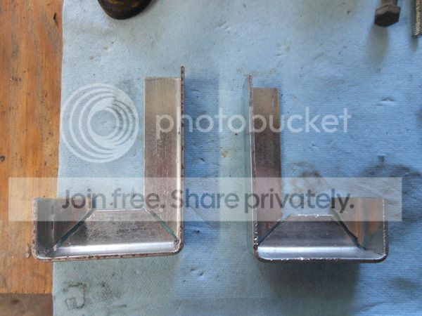

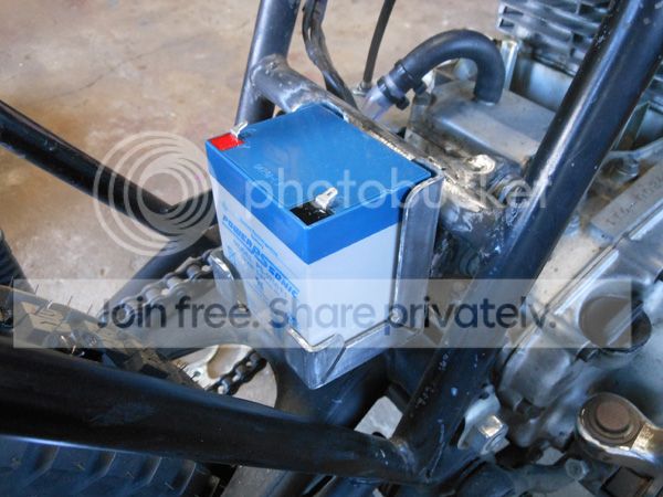

made battery brackets from scrap angle
seat rails and battery box mounts painted and installed :

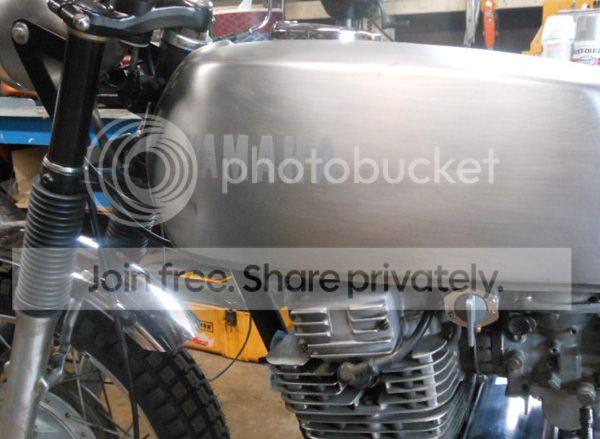

I had stripped the top / sides and sanded the tank for the "raw" bare metal look , however the underside was still very yellow. I threw a scuff at it and sprayed it aluminum.
I applied a Yammy stencil to each side, right over the dings and dents, so it will have a tone on tone "ghost logo" :
depending on the light and angle, it looks darker or lighter than the bare metal. sweet !

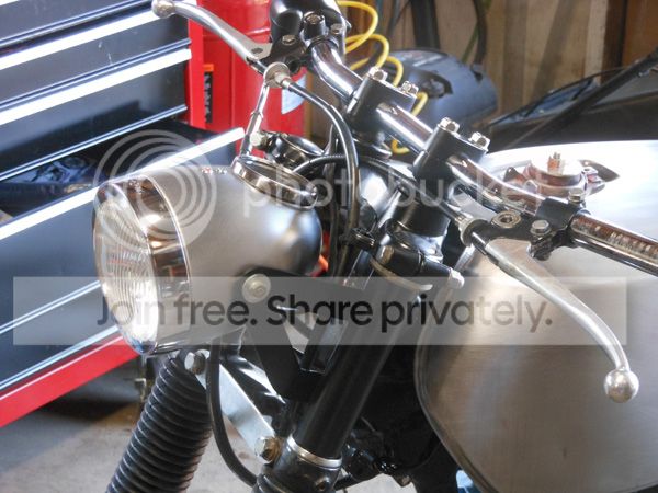

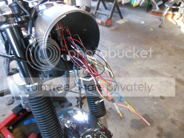

wiring again, since I had the bucket off to change the look and painted the ears I made

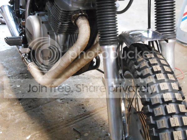

I needed something to trap and hold moisture to ensure the headers rot in a timely fashion... so this pipe wrap should do the job !! It's light brownish.. but does not photopic well

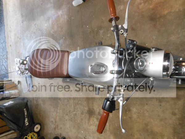

chocolate flavored grips
Final checks, adjustments and tweaks. Took it for some shake-down rides with low fuel in the tank . Just need to get that fuel cap gasket from mikesxs and I will ride it everywhere for a week to make sure there are no niggles.
Then it's off to the hipsters with it !

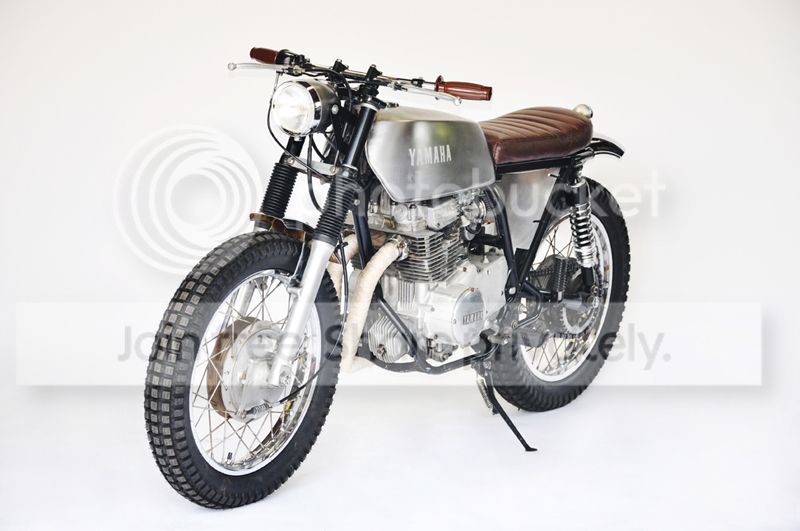

how it sits right now:
