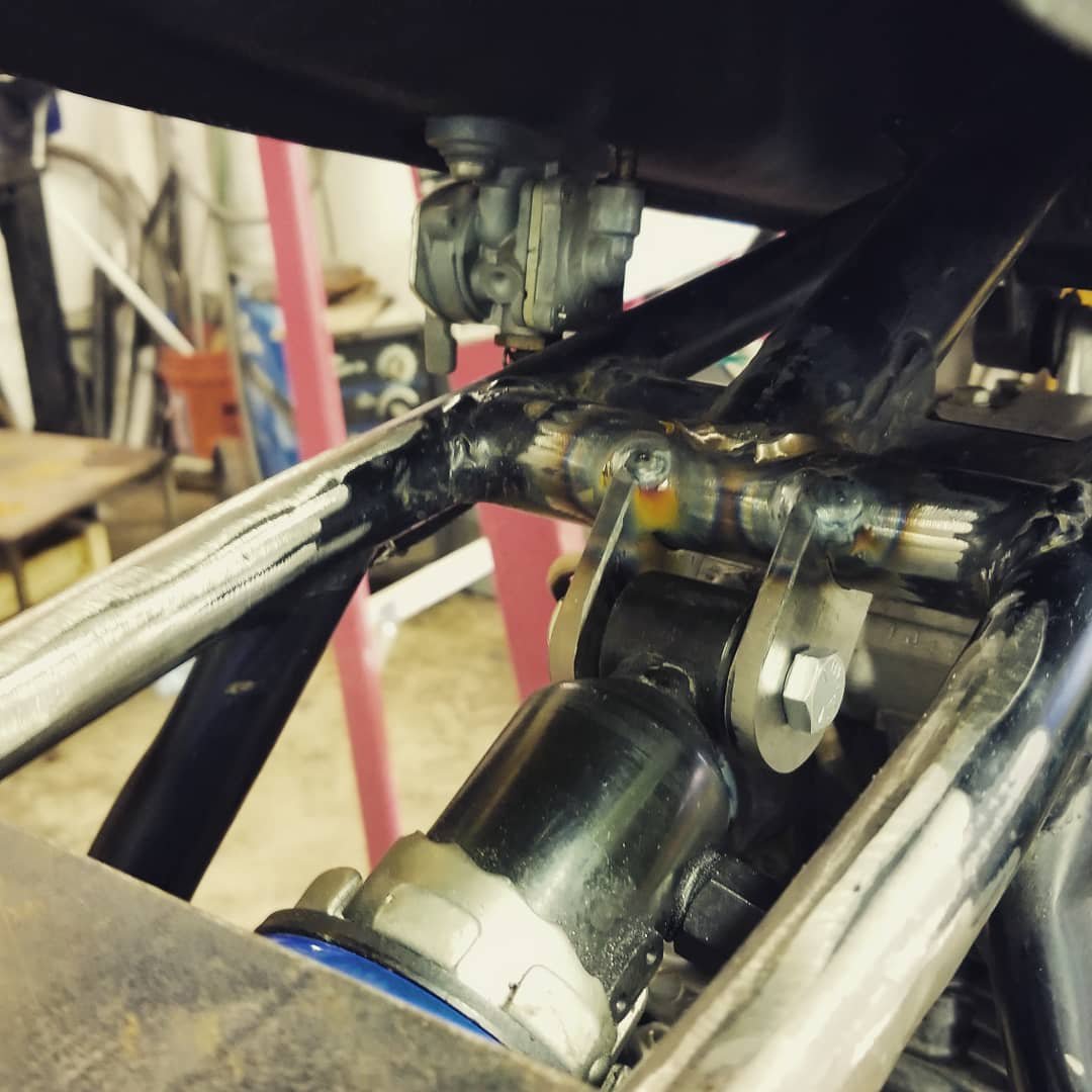

Got a chance to get the shock mocked up. Built some temporary brackets to see ride height and sag. Looks and feels pretty good.

Little progress. Need to figure out the "gusset" for the hoop. Really dont want to add anything but I feel it needs something.

More progress. Most things need finish welding, plan is to get everything mocked up, get it running and tear down for finish welding. Then paint!
Started the brake linkage and played around with the rear section. Going to order the throttle, clutch and brake levers.
