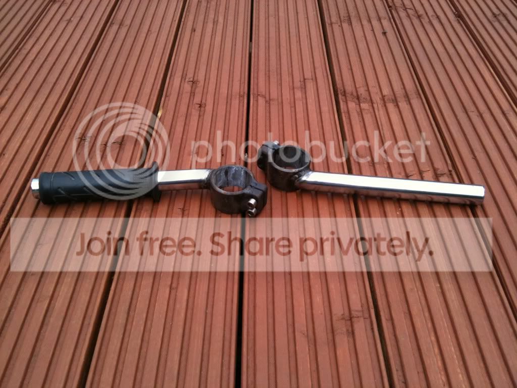

and dont know if the clipons were bought off the shelf or made:
