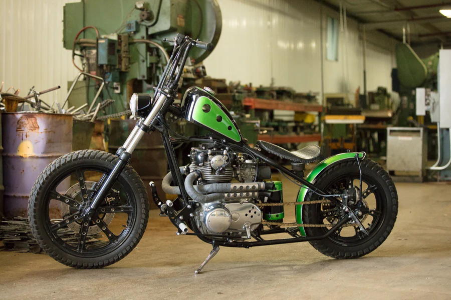

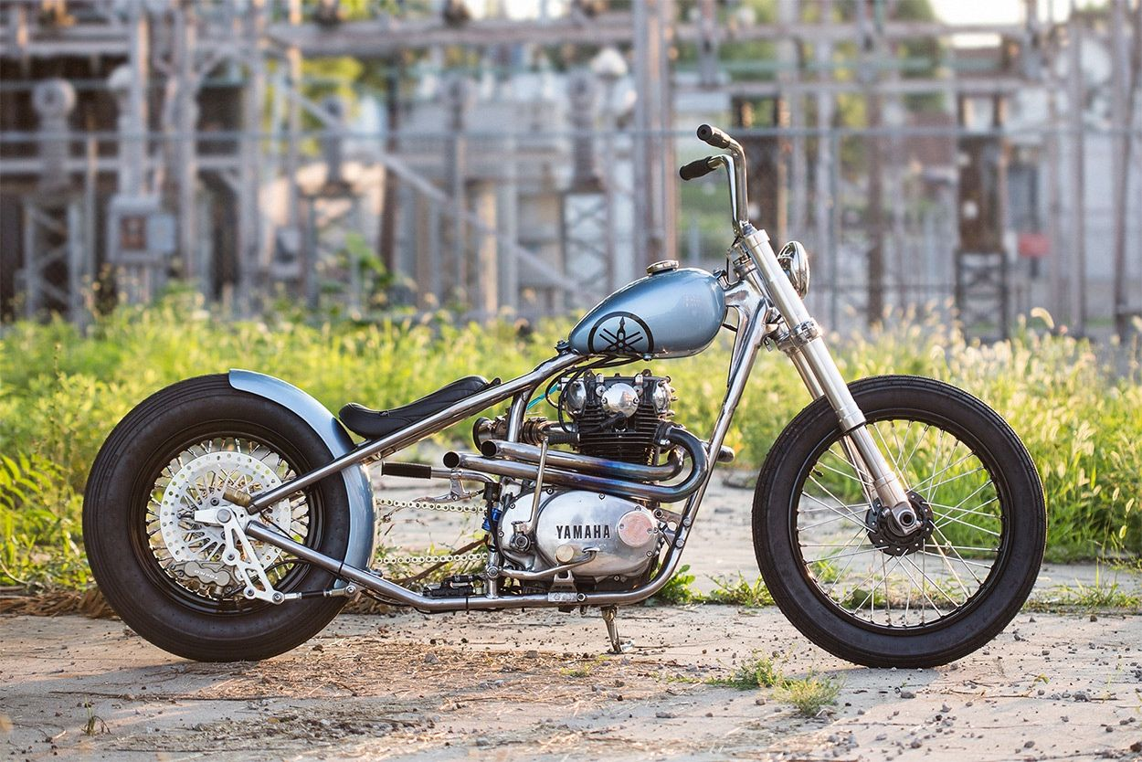

Even at that, I think you found one of the more flattering pictures of one built off of a TC bros kit. Not that they are horrible by any means, but that voodoo vintage kit is way better looking for all the reasons listed. I don't hate this bike, but it better shows where I think they put the bend in the wrong spot on the TC kit.
The Voodoo is definitely much better looking over all. More of a classic hard tail look IMHO.

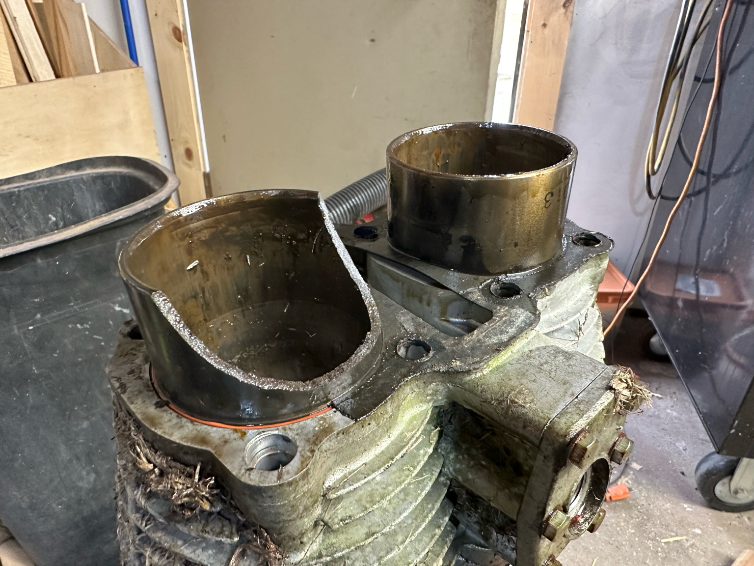

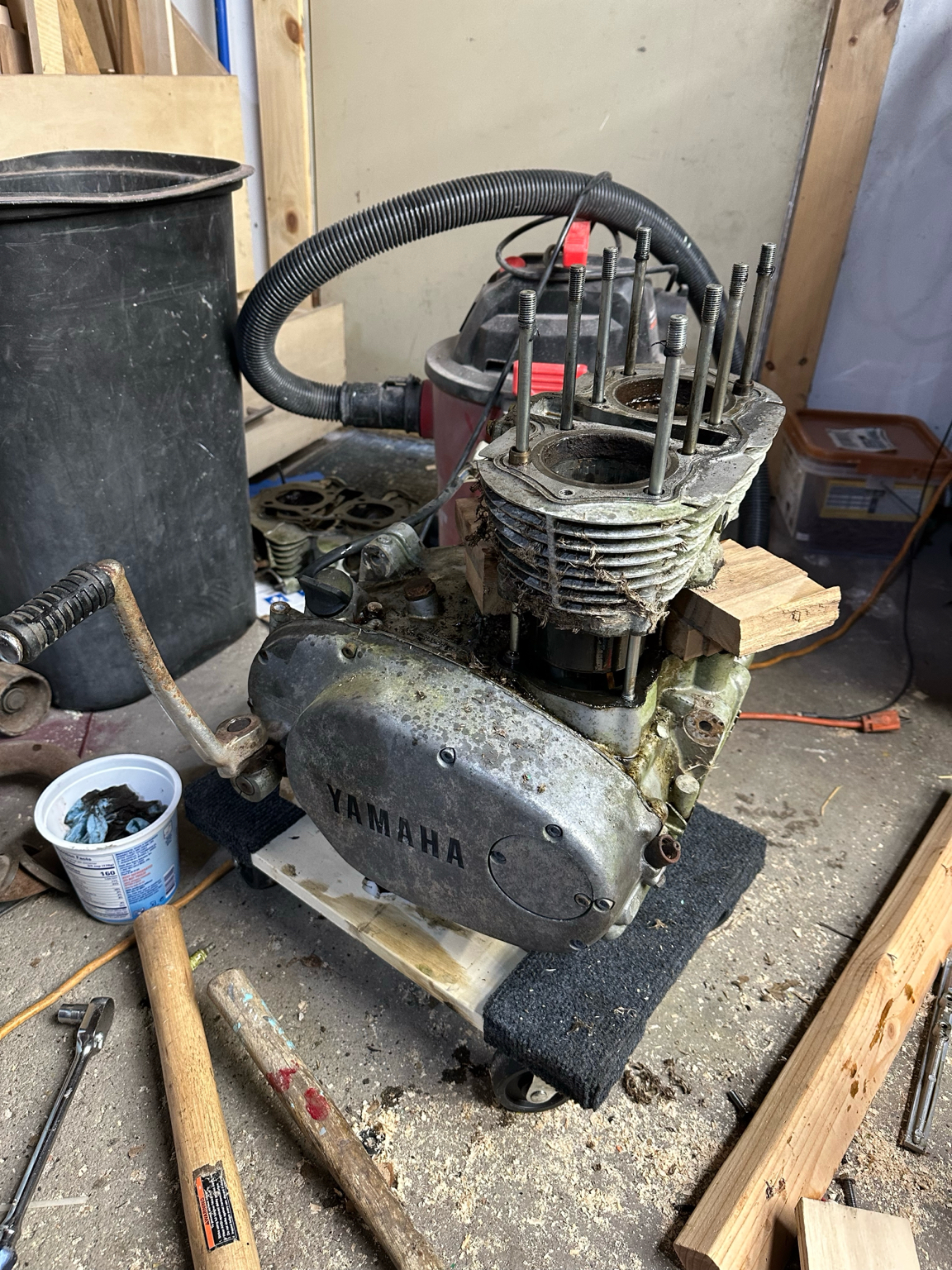

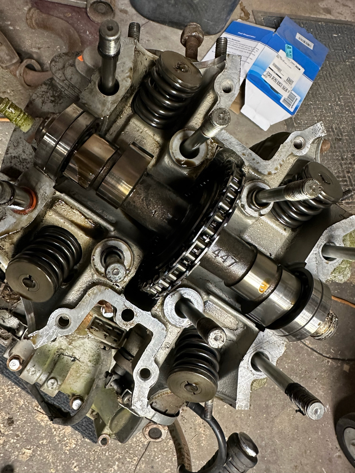

I’ve been curious about the condition of the engine and today I let it get the better of me. Pulled the head and with some persuasion the jugs came off too. Unfortunately one of the sleeves didn’t make it so I’ve gotta see what my options are for used jugs, or perhaps the big bore kit.
The cam and rockers all look to be in great shape, so that is a good sign.

Looks like a sleeve is about $130 on MikesXS so I’ll probably that take route and go with a 1st over piston kit and have the cylinders bored.

Looking at eBay there are tons of used jugs for sale for cheaper than the cost of a new sleeve so that makes the most sense to me.

"New" cylinders from ebay are at Mototech to get bored out, just waiting on pistons to ship out. We're going 2nd over on the pistons due to the rust on the cylinders.
