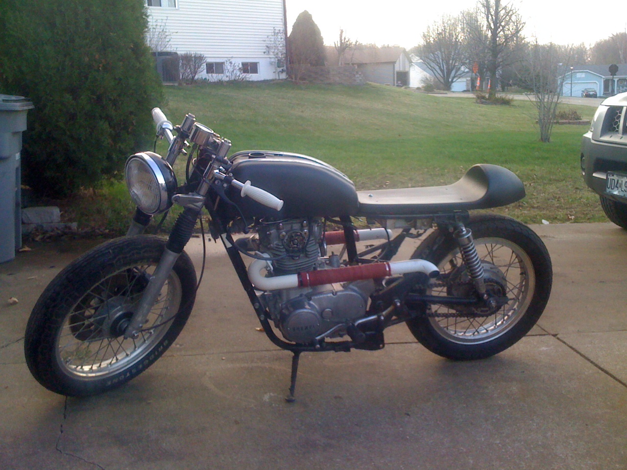

I thought I'd post a few closer pics of the tank and give a quick update. I did a little fab work on the tank so I could mount it in the rear. I cut off the area of the factory mount that goes out past the rear of the tank, and then used a small piece of steel plate to cover the hole that was there. Soon I"ll attach the strip of 1/16 plate that I'll use to mount it. I used some self cutters to hold it in place for assembly until I get it welded up. Next I'll fab up the front mounts for the tank out of threaded rod and factory Honda rubbers. Also got the 1" square tube to mount the seat, so thats coming too. I'll post that after this weekend.
Did a little bit more y'all. I welded some 3/4" square tube to the sub-frame to mount the seat to. Finished up fabing the rear mount for the tank, which is just a "Z" shaped strip of steel welded on. Mounted both on the bike just to make sure they jive. I used some 1/8" rubber gasket material that I found at the local farm supply to rubber mount the seat. I chopped up my original battery box so I can get it out of the way. Finished stripping everything, including the inner fender and all wiring. I also used a dremel to remove 2 links from my chain & cleaned my carbs in anticipation of the big day.
Now I'm ready to paint and re-wire. I have a simple schematic and I'm actually looking forward to it. As far as the paint, I'm going to do the base color and let my bro in law do the trick stuff. Thats it for now. Here are a few pics.

My pipes showed up. They're really more like hardtail pipes, I got them from Ardcore choppers. I wanted some high pipes but I didn't really like the scrambler look so I went with these.

Just wanted to check in with a few pictures. Painted the tank and seat with primer and threw it back on to see how it would look. When its done it will be black with the flat sides of the tank inset with an off white. Inside the white panels will be something, not sure what yet. Badges, numbers maybe?
