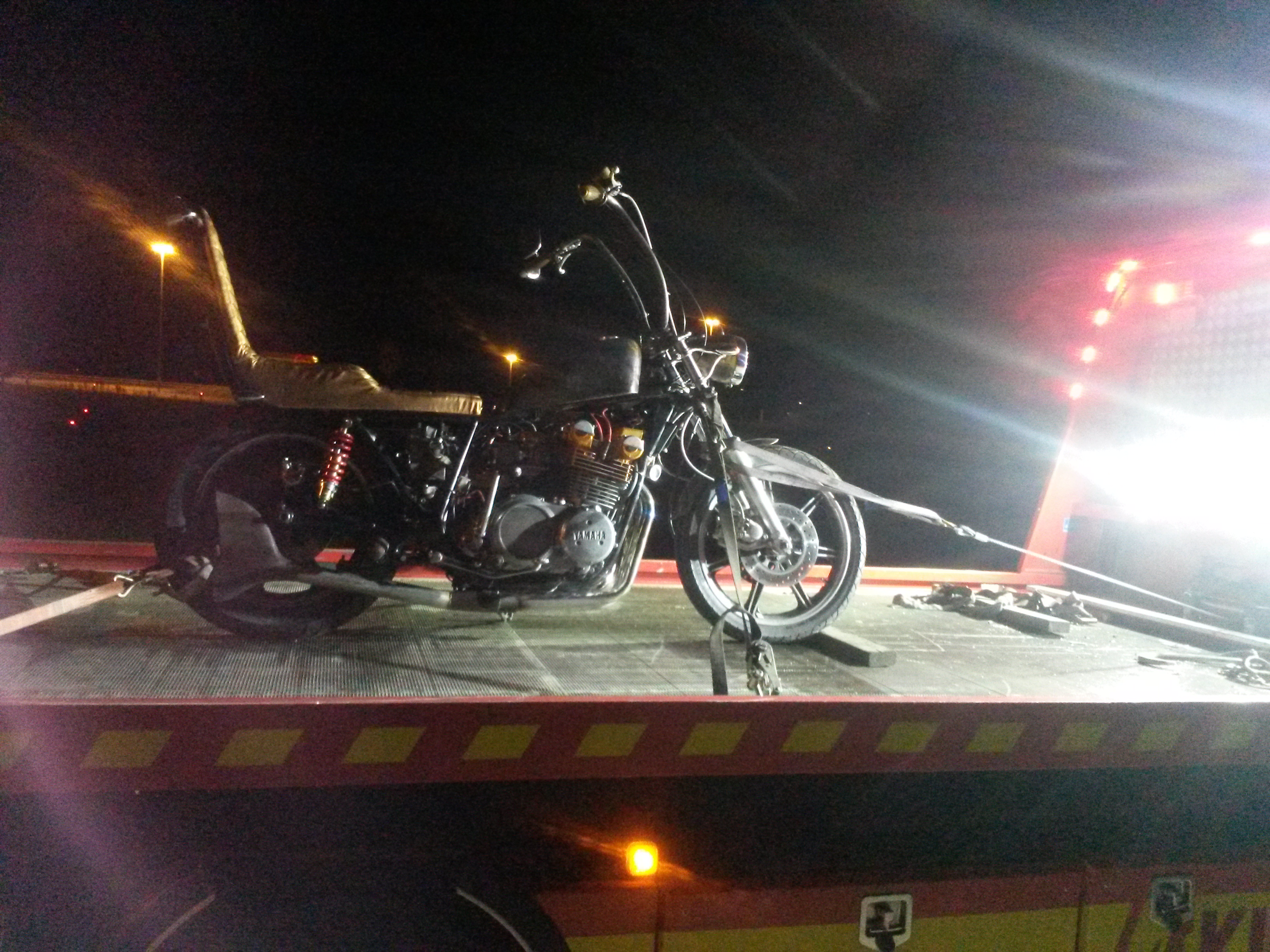

The chinese (go figure) rec/reg unit showed up with only the rectifier part working, so i smacked on an old oem regulator and went for a long ride, everything worked sweet and the engine is loosening up a nicely so i pulled it higher through the revs today, and its got that screaming turbine humm niceness going, love it..
All until i ran into some rain, and it shorted out the motogadget unit, quite a show when its putting current through every output :D
Wasnt all that fun freezing in the rain though, cursing and fighting to light a cigarette with matches (gf stole my lighter..)
Pulled the ground and waited for the rain to blow over, dried the box with my buff then ran it home cold as fuck.
Need to rainproof that box, thinking about making some transparent plastic cover..

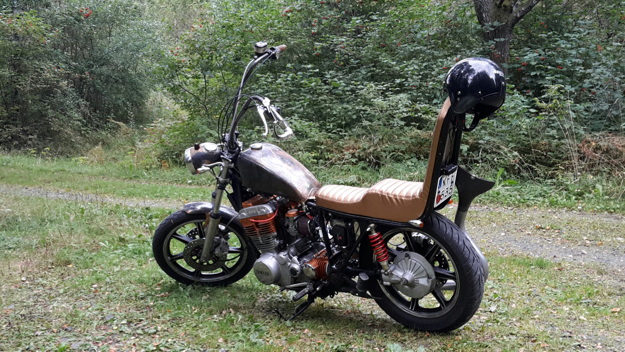

Haha yea, kind of how i wanted it! Time to start refining it, riding season is almost over here.

The list of things i want to do to this thing for next year is quite long.. first up is making it weatherproof and reliable, 2 breakdowns in the shakedown is more than enough.
Almost feel like a fork extension is out of the question for this garage season, gotta have the time to service all the other gas eaters as well, and start looking at the bsa i got lying around in parts..
