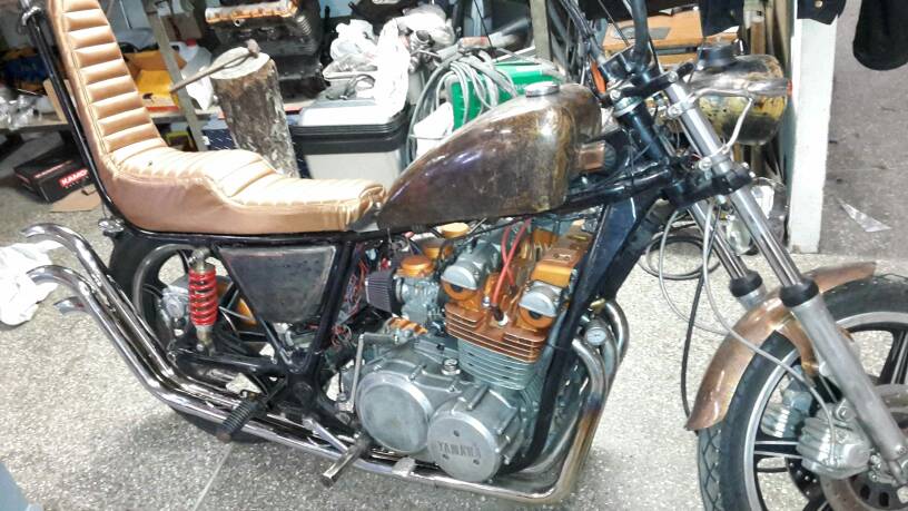

Not much happening right now, been tearing out the chinese regulator that was junk from the box, need to make new mounts for the new one. Finishing up the side covers for plating. Slowly..
Got the reg installed and made some baffles for the pipes last night. Not gonna up the jetting anymore now, gonna have to strangle the thing instead..
Now its basically only finishing and plating the sidecovers, adjusting the gears and then its ready for abuse!
Fuck plating, i'll go with gun blue this season so covers are finished!
Probably long delivery time this time of year anyways..

Took the clutch apart last night, only real issue i found is the pressure plate lifts unevenly, it kind of levels out at full pull, but it contacts the clutch outer drum at one spot.
This is bad since the clutch drum pushes the primary drive gear out and misaligns the drivechain..
Tried changing the springs around but no luck. Ordered a new set of springs as these are old, came in the box of parts. Hopefully with new springs it will be better, since pressure plates need to lift evenly to work correct. Hope this fixes the clutch issue..
Its not much left but small annoyances now, i know it will be worth it! Planning to take this up the Norwegian mountains this summer!
Took the clutch apart. Again. Found that i had put a wrong washer behind the clutch center, way too thick.
So it was rubbing against the clutch outer drum and not fully releasing.
Put the right one in place and bolted it back on with fresh springs and voila! Finally a perfect clutch! Then only to have the bike die in the parking lot, turns out the (brand new!) Regulator shit itself. Was crackling when i turned the power back on and the motogadget shut the circuit down.
Got another combo of regulator and rectifier working in my favor, also pulled the swingarm and fitted that big driveshaft boot.
Now ive got somewhat reliably 14v at the battery at all loads and rpms. Yay!
