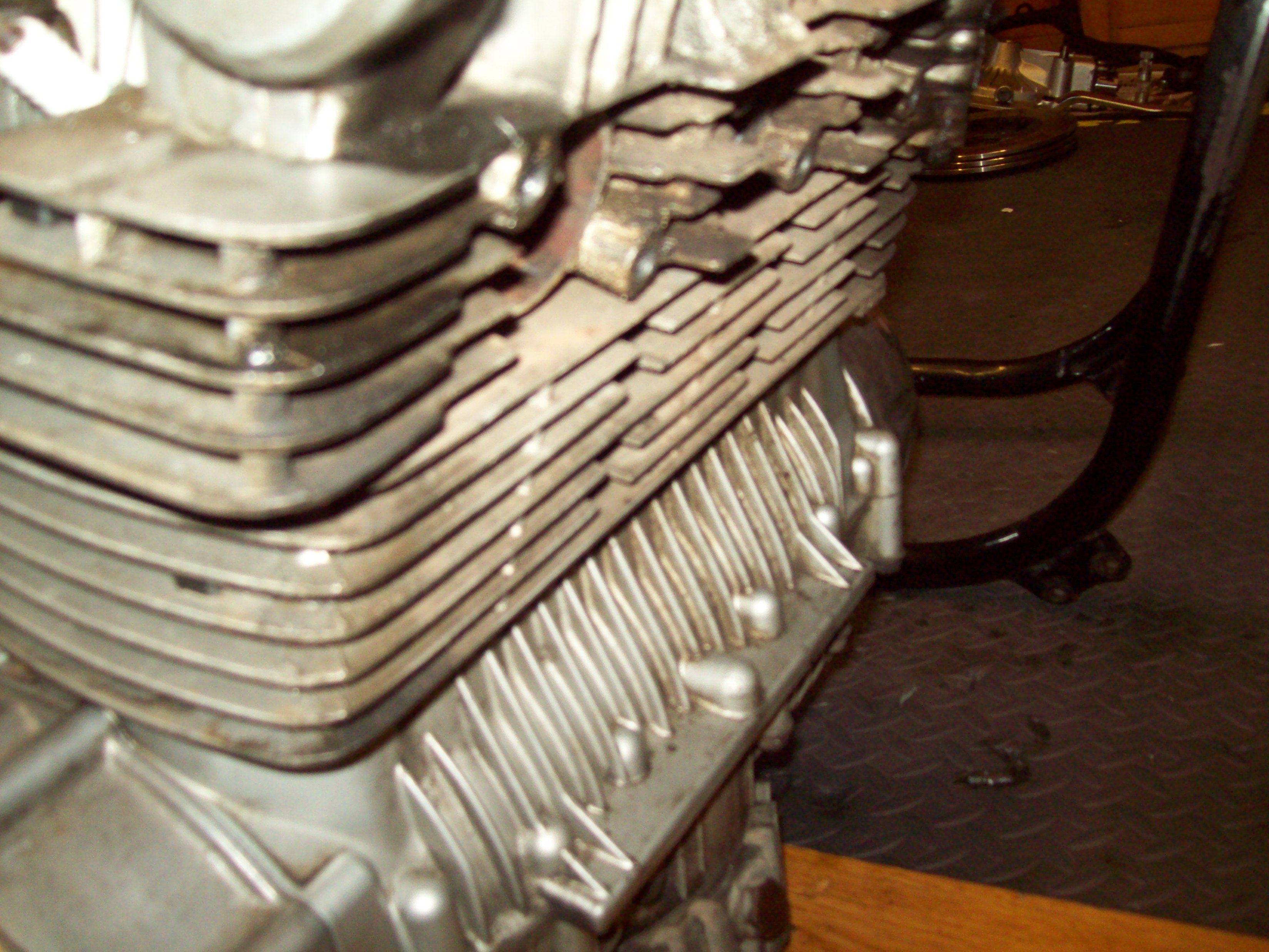

The engine before paint and polishing
The engine is just about ready to be put back in the frame which I'm hoping to do tomorrow.

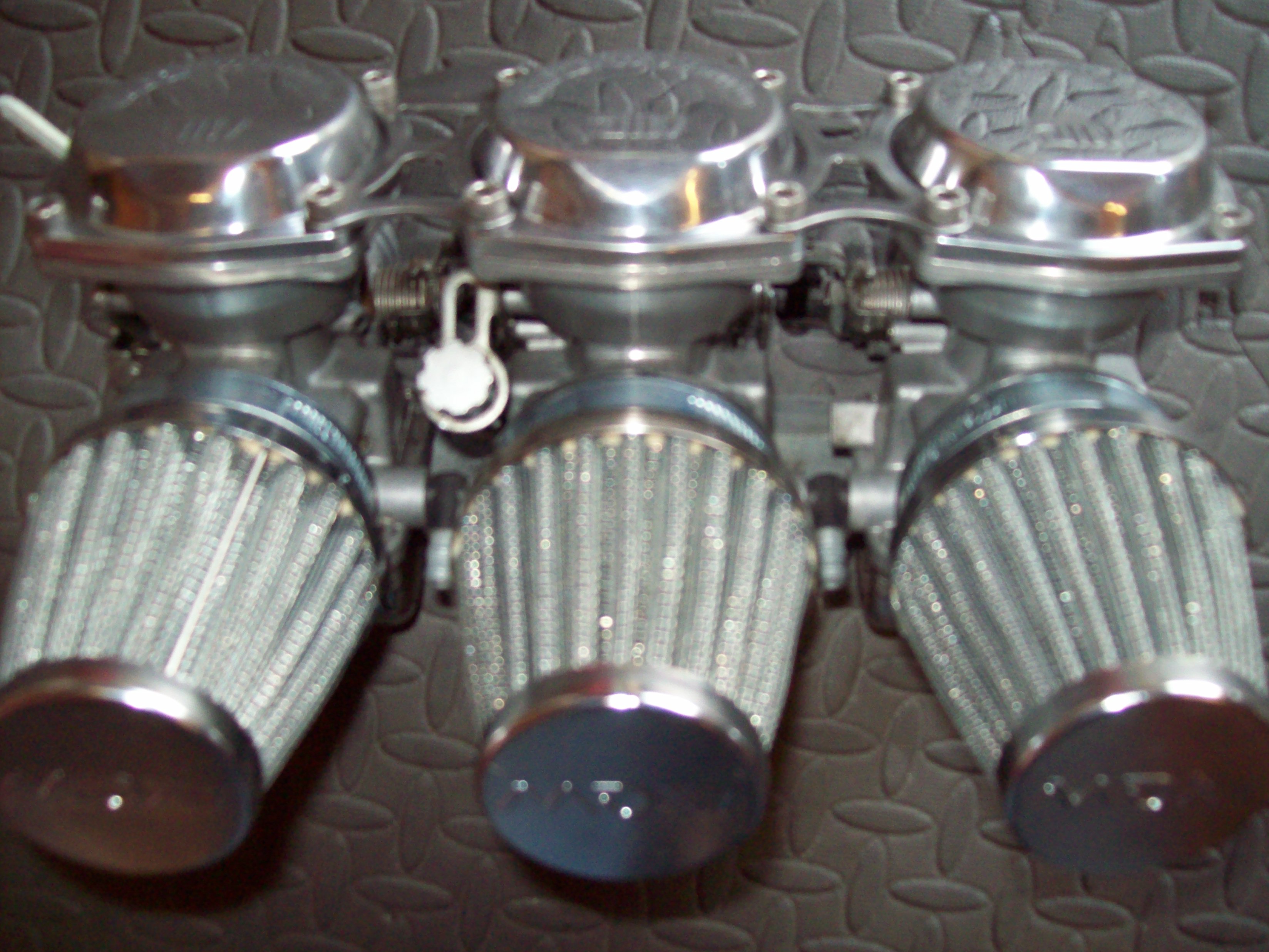

Carbs have been cleaned and polished inside and out and rejetted.

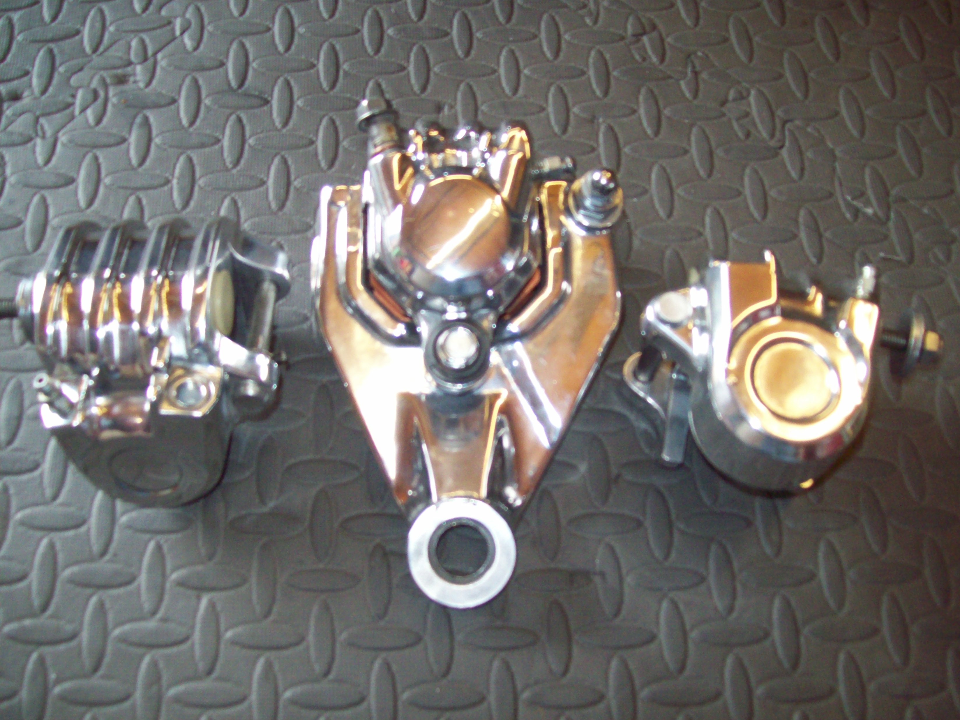

Brake callipers cleaned and polished with new piston seals.

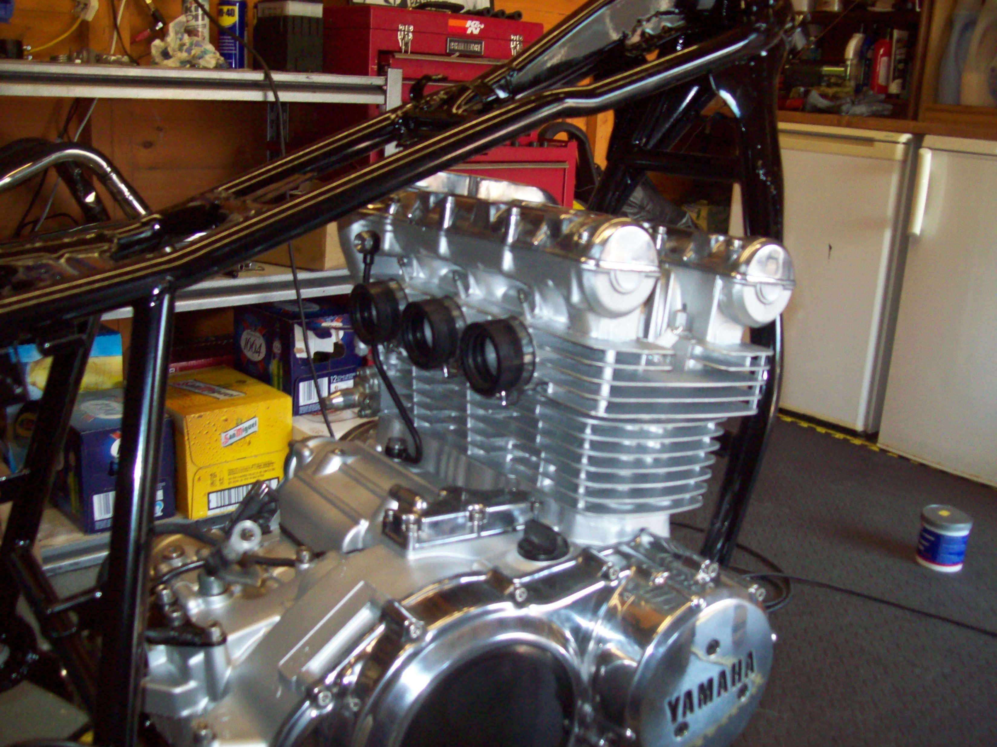

Engine in

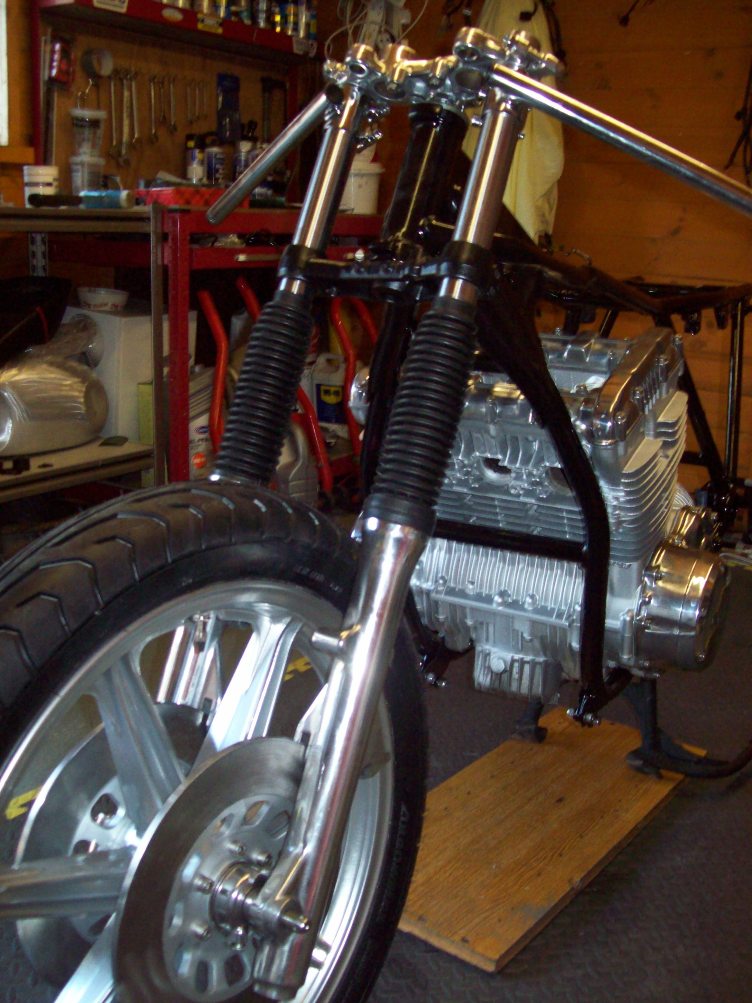

Front end and a few other parts fitted
