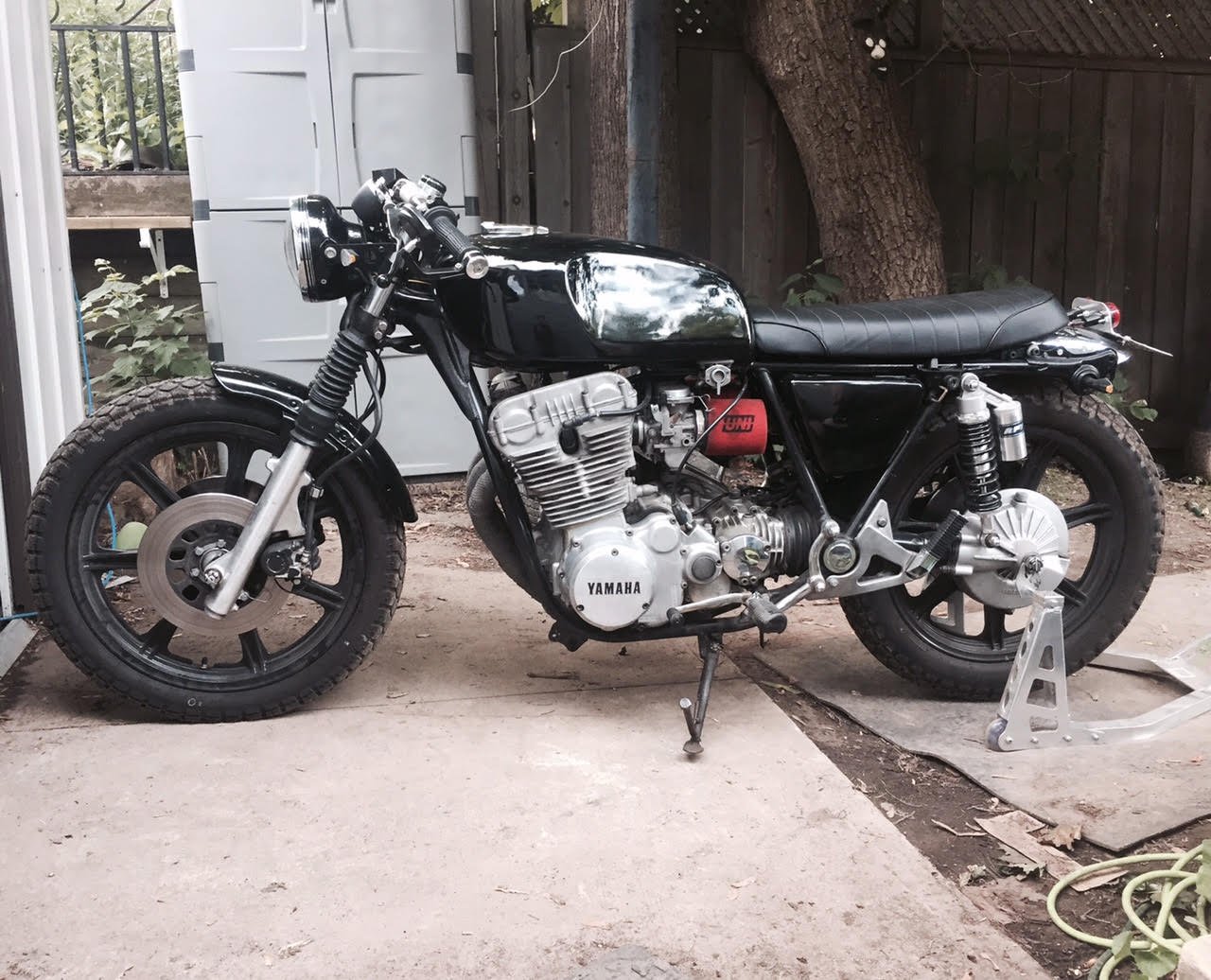

Did you cut the springs in your forks? Your front end seems lower than mine.
O lowered the forks in the tree about an inch or so, but the real difference is in the front wheel. Its is a wheel from an XS400. It is and 18" wheel not the stock 19" wheel. I had to make custom spacers for the disk brakes, custom bearings, and a stainless spacer for the axle because the XS 400 wheel is about 5mm thinner than the XS750 front wheel.
I just figured out the preload settings on the front forks, it dropped my front end about an inch. Here is a picture of mine, I went for more of a brat style so my girl could come along for the ride.
