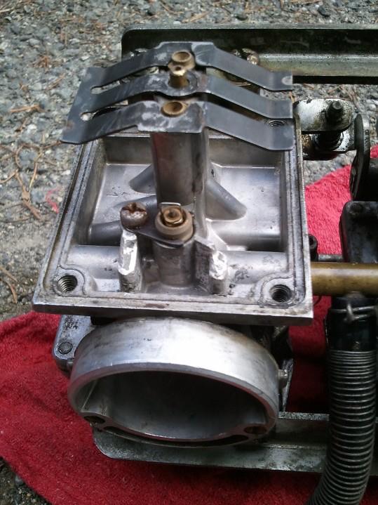

I recently picked up a 1980 xs 850 for $300. It has carb issues. The issues turned out to be a busted float support. The P/O looks to have used epoxy to try and fix it... anyway. I need to find a suitable solution. Preferably just replacement, unless I should just take this to a shop, I'm not really a Carb Guy.

I don't have time to look it up, but on this site somewhere is a tutorial on how to fix that with JB weld. It takes a little grinding and work, but didn't look all that difficult. I ended up doing it on an 850 I sold and it held and worked fine.... http://yamahatriplesuk.myfreeforum.org/index.php
They might be. I'm not sure at the moment. I'll check this weekend. I have a couple photos:

Hitachi's.... With a lot of work, these can be decent carb's, but most guys who have them, make the Triumph swap. There is a little alignment work to get them on, but it's supposed to be a far superior set up. They also have Mukuni's (some came with them) which are easier to work on. I don't know what the p.o. was thinking doing this to a carb. It could be fixed, but it will take a steady hand. You can buy stock, square it off, drill it and JB weld it to the carb. I've seen it done and had to do it myself. It actually worked, but my friends thought I was nuts doing it... I talked to the new owner, and he's ridden the bike from California to Boston without an issue...
