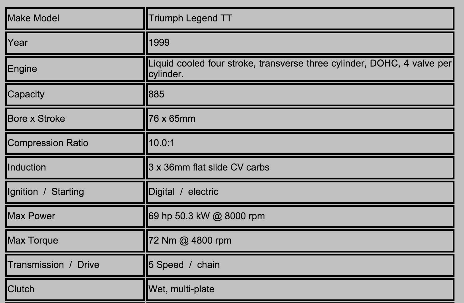

Well... I won that set of Sprint RS carbs for $102! So... I guess I might be working on the ol' girl sooner than I thought. Would be nice to have her road worthy in-case the weather is good enough to ride over to Portland for the 1 MOTO show next month.
After further investigation, the carbs must be from a 1996 Sprint 900, not a Sprint RS. The RS didn't come out till 99 and was fuel injected.
It looks like the only difference between the Legend 900 and the Sprint 900 is the compression ratio, and the switch from Keihin carbs to Mikuni carbs... and a whole lotta HP. We'll see how this goes!
