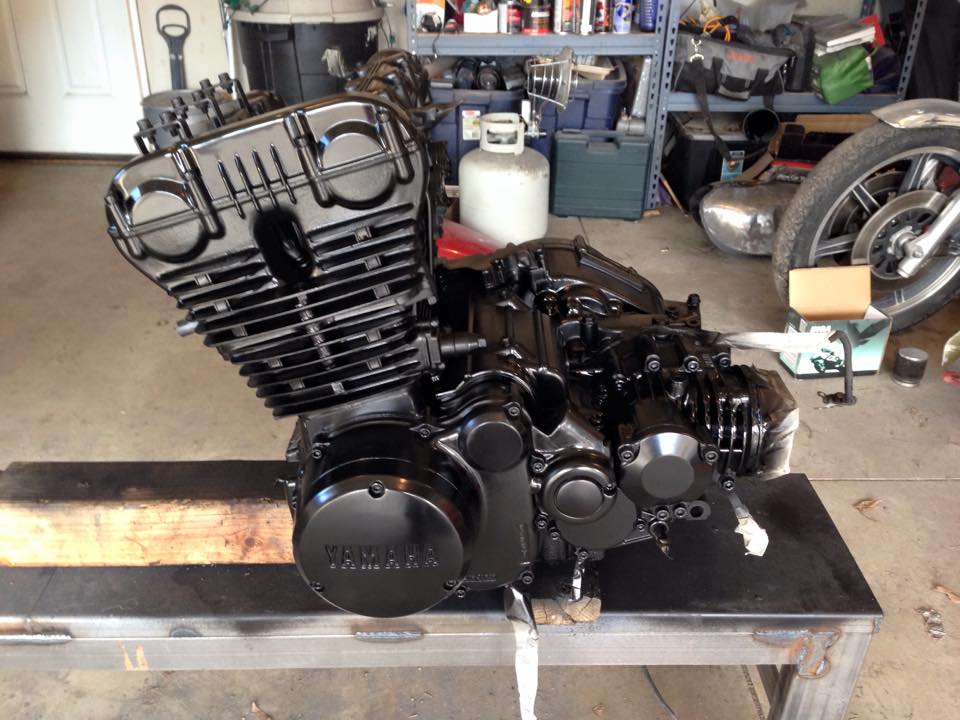

Stiiiiill waiting on the frame, but in the mean time, everything in my garage is ready for it! Painted the engine yesterday with a semi-gloss engine paint. Love how it came out. I was a little nervous painting a fully assembled engine, but it worked out just as I had hoped. Only concern is getting it back in the frame without messing it up :/
All black accessories with the silver frame and silver fork/rear shock should compliment each other nice and look a little more unique than your everyday bike. Wheels are done black also but not pictured. Everything will be a satin finish except for the tank which should be a metallic high gloss.

Re: XS850 - Monoshock & USD Fork
Hey Treitz-
That's really coming together!
Have you considered sanding the paint off the edge of the engine's cooling fins to make the edges silver?
Keep it up!
-Sherm
Bigsherm said:
Hey Treitz-
Keep it up!
-Sherm
I did consider it, just couldn't decide for sure if I wanted to. Maybe once I have it in the frame I'll have a better idea of whether or not I should or shouldn't do it.
I have really come to appreciate the beauty of this triple engine.. you're doing a great job on yours, makes me want to go the extra mile on finishing mine! Apparently i cant leave the cases a glass-blasted satin finish since these old castings weep oil and engine enamel is used to seal them, so I'll aim for silver paint and polish some protruding parts perhaps.. (i hate polishing..)
I may be a little bias (because I just really like triples), but they are one of my favorite engines. Just love how they look (if only they weighed a few pounds less...).
I HATE polishing too which is why I opted for black, and black, and more black on this one.
