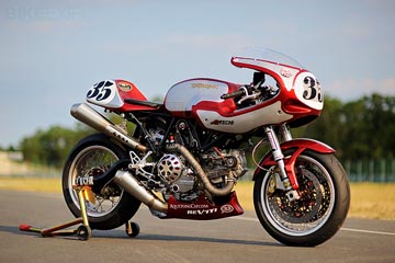

The next pic is from a builder in NC whose project looks so similar to mine, that we started PMing.
I plan to use a Paul Smart replica seat in hopes of building something like the 1000s Duc
Doc's Chops (?) is also an inspiration as is Sepp Koch's designs...

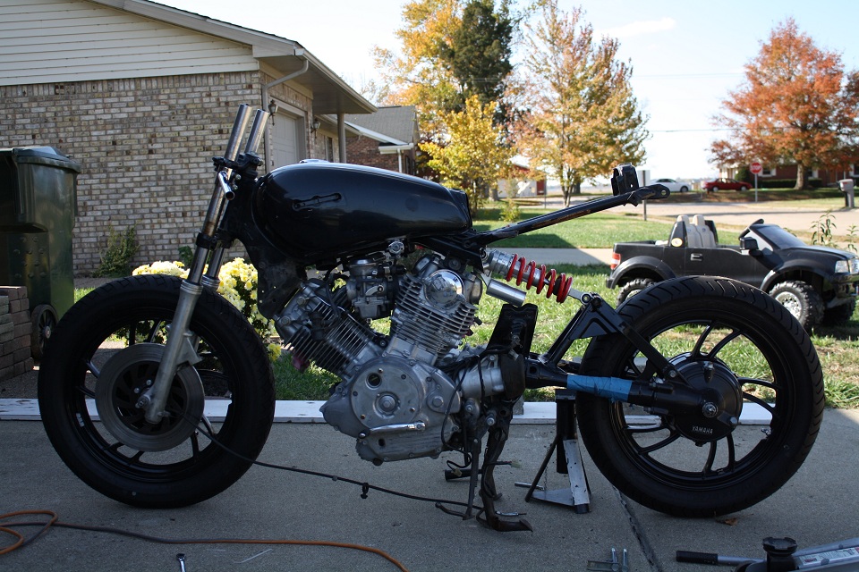

Taking my cue from Johnny Ryland at Classified Moto. He explained the steering stem swap technique to me.

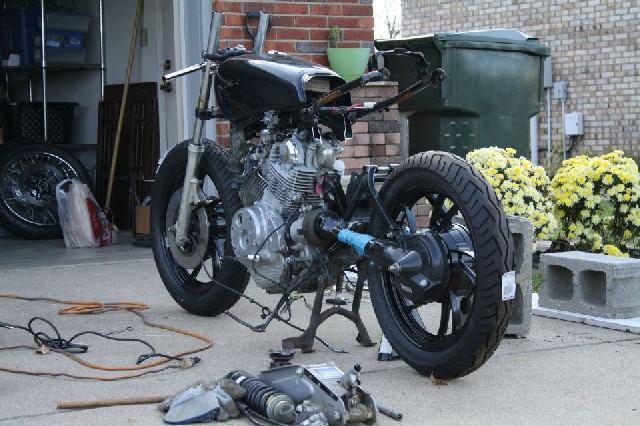

My roller, frame chopped in the late fall. R6 monoshock mocked up to replace massive stock air shock. This aluminum unit probably weighs less than half that of the stocker. Frame back from welder last Friday. Wintry mix hit and frame got a bit of rust on the bare parts. New upper shock mount, open ends of frame capped, lower frame capped (not shown in pic)

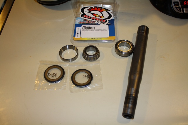

Still waiting for machine shop to finish all my little motorcycle bits. But, All Balls tapered bearings came in today! The XV project is moving along slowly but surely. Here are the bearings laid out along side the pressed out XV750 stem.

not gonna lie, pressing out the steering stem and all this mix and match and having axles turned down seems like the hard way to go. then again maybe I just lucked out with my front end swap. or it was so long ago i forgot how much work it actually was, laugh.
either way, i love that youre doing all of this. more pics as things come together.
