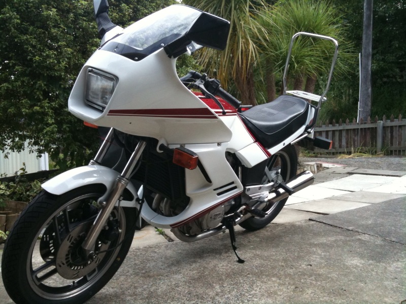

Here's my XZ just before it was earthquake damaged.
Fairing, sidecovers, tank, engine case, luggage, mirrors, exhaust, indicators and handlebars were all busted. Rather that try and get it back to fixed I've decided to have some DTT fun with it. Apart from the engine case, the motor should still be good - The plan is to go through the whole bike from front to back with some performance and cosmetic mods along the way - pretty much what I did last time, but with DTT eyes on.

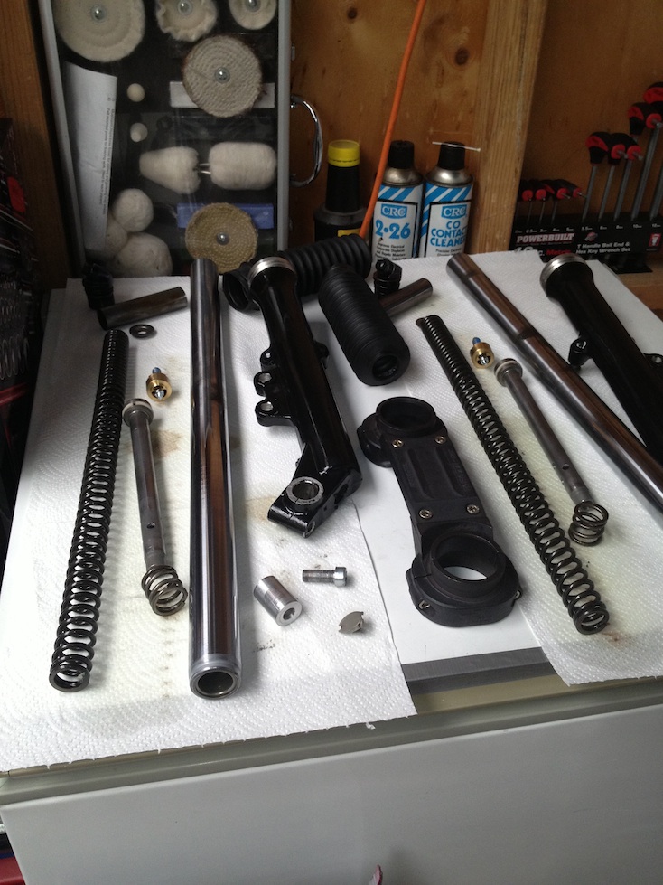

For some reason the aluminium bush at the bottom of one of these was deformed – you can see in the picture it is out of round. Perhaps I over tightened it last time. The bolt came out OK, but there was no way it was going in again without drilling it out. I swapped it out with a spare.

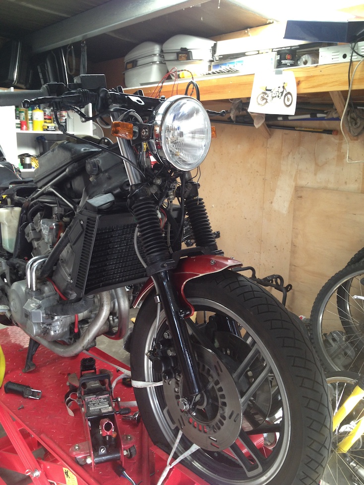

Got the forks together, filled with oil and on the bike. The other 1/2 litre ended up on the floor - what a mess.
I have a 7" chrome headlight - new ex Taiwan. I think it looks OK but there isn't enough room in the bucket for all the wires. Here it is on a trial fit with some mini turn signals. The XZ came with huge dumbo ears for flashers - I guess bulbs were dimmer back then.
I've also settled on some drag bars - the stock XZ have this weird combination clip-on / triple which fixes the bars in a not very attractive or comfortable position. I tried a pair of FZR250 clipons, but they bash the tank with about 2 degrees of turn. In the end I chopped the handlebar risers off flush with the triple and mounted the converted triple from a mate in Auckland who had tried some hippie bars on his.
Swapped out the mudguard for a little shortie version I trimmed with a hacksaw and file.
Also dropped in a NOS radiator cowl.
All in all a good days wrenching

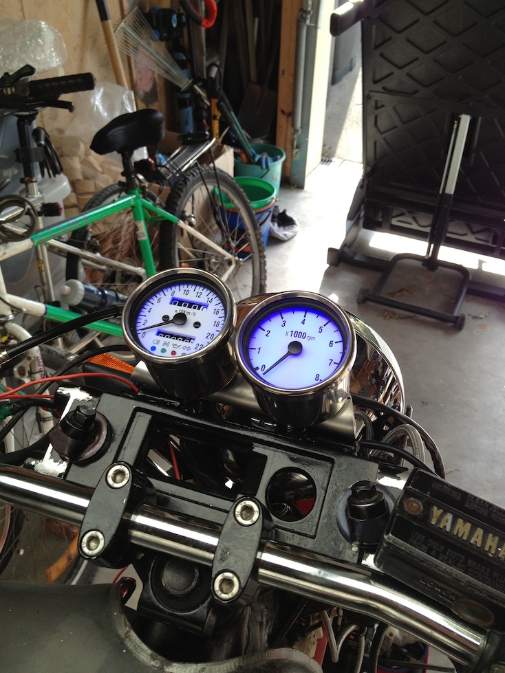

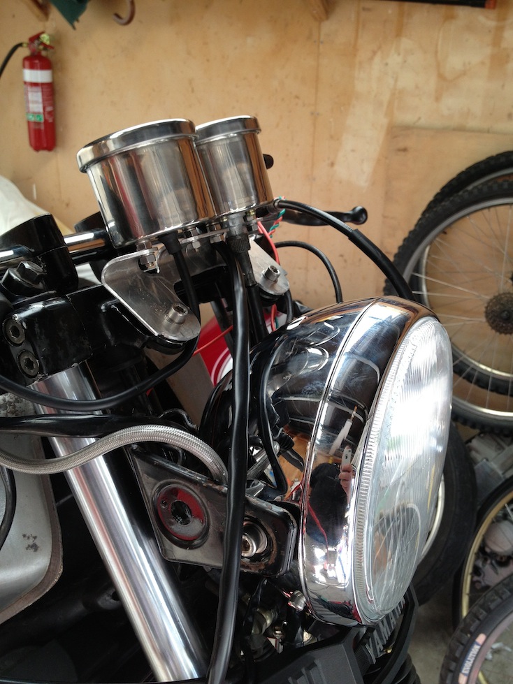

The XZ is a real pig - the angular stock gauges are mounted with great big stick out lugs. Cutting them off doesn't help much because there's noting else to mount them onto.
After about 3 false starts I made a bracket out of 2mm 5053 alloy. Uses the stock rubber mounts with a little 11mm ali pipe to stop them crushing. These are important as the gauges say on the box that they will fail with excess vibration. Once I'm sure I'm happy with them I'll send them out for some powder. I still have a cunning plan for the space where the idiot lights and key used to be.
I didn't realise till I put some power through them, but they are backlit blue. How cool is that.
These gauges only have a single flasher led, but two on the stock gauge - Does any know about the diodes I would need to wire it up properly?
