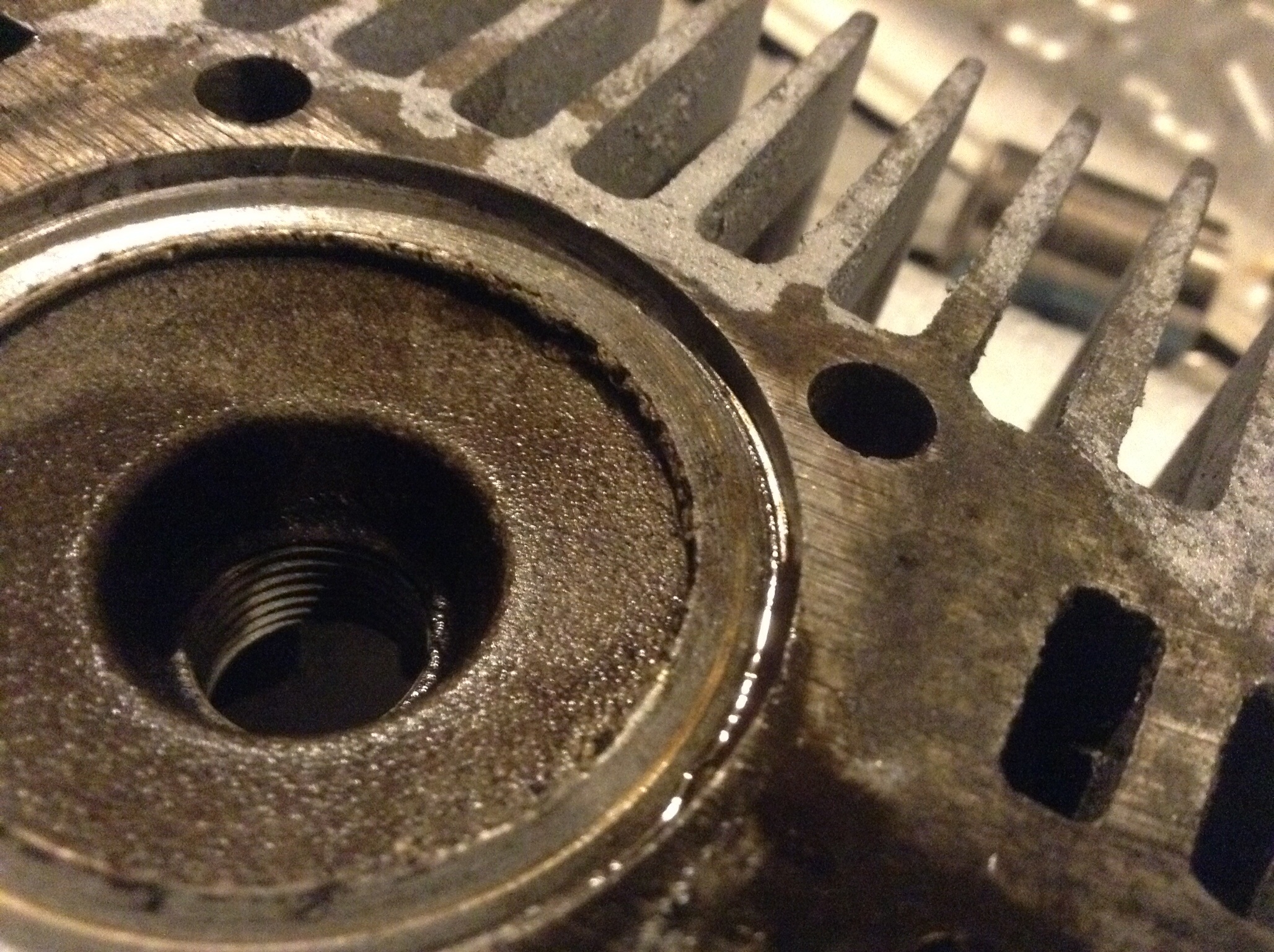

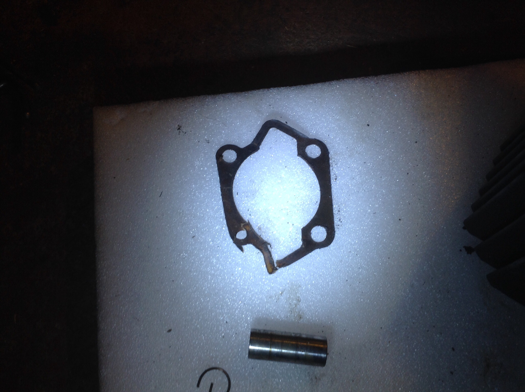

don't worry about that head gasket.
Most mopeds have such low compression, that removing it will work similar to decking your head for higher comp.
Trust me.
Also, it is likely a fuel/air issue. make sure the pilot jet on the carb is clean. I like to run a guitar string through it.
If you are getting spark I would bet money the carb isnt all the way clean. if the pilot jet is not clear 100% it wont start.
If it ignites on starter fluid, then you know it is carb related.

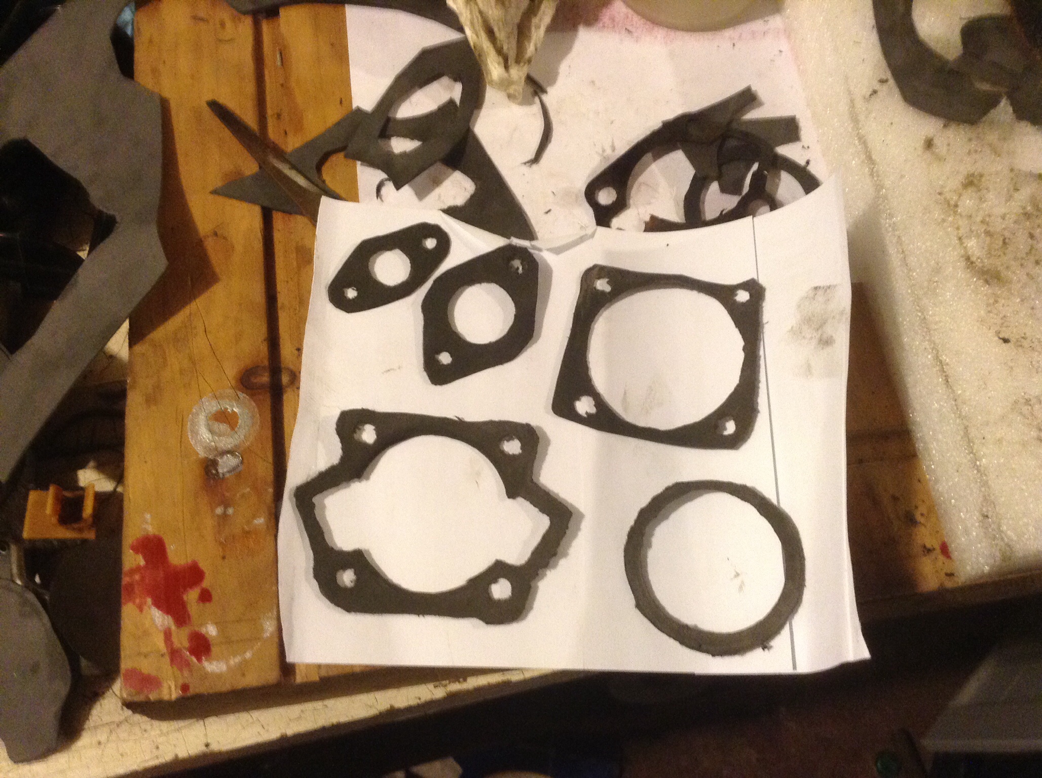

My plan is to make sure its timed correctly
Replace the 4 head bolts
New piston
New rings
New gaskets on the head
Unless that runs me over $100 then ill just grab a kit or a lifan motor

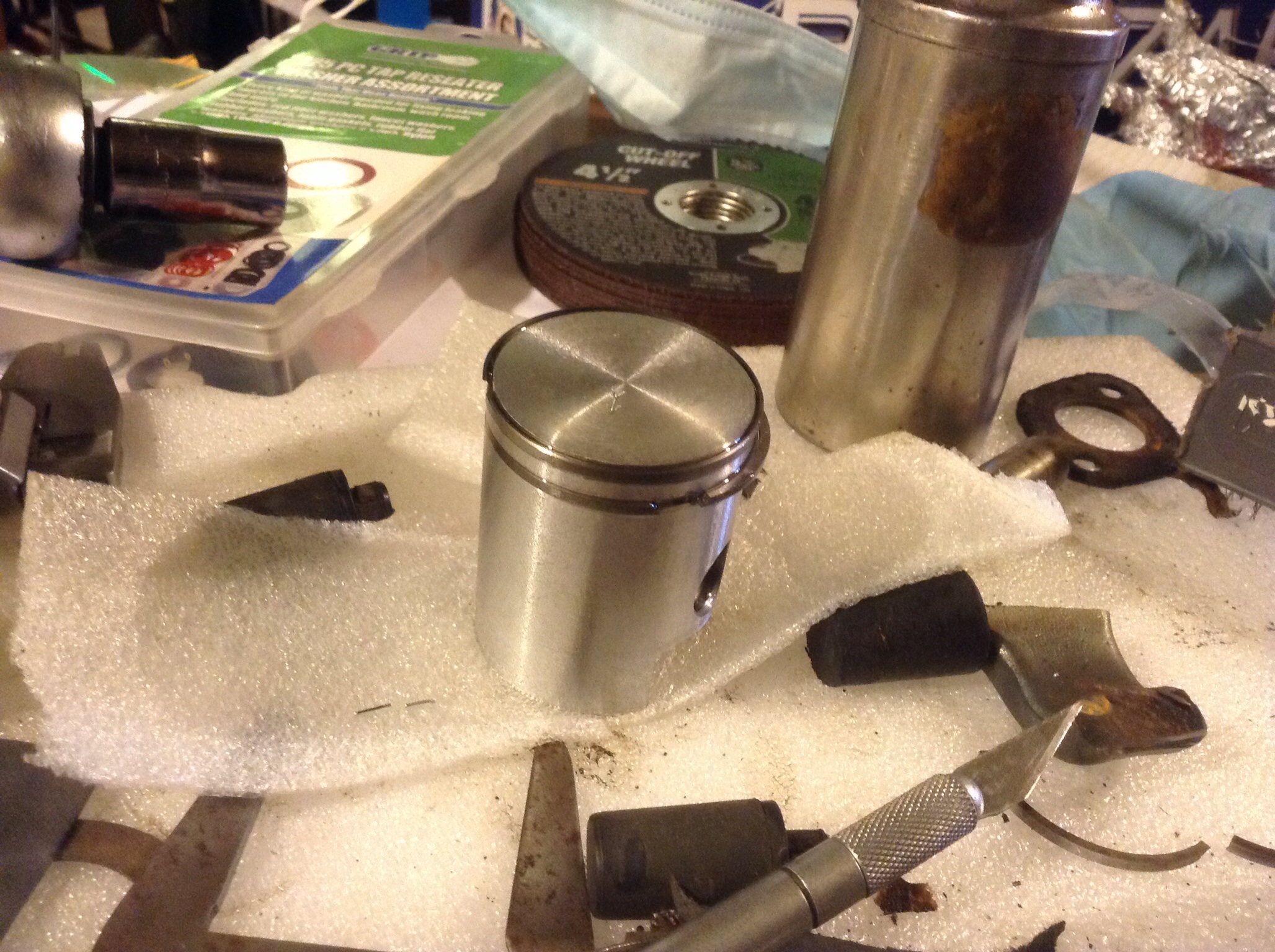

After a few weeks on the moped forum looking for the piston with no luck ....i found a website that had it in stock so i ordered it....they ended up not having it .....but alas some kind chap from Moped warehouse emailed me saying they have it on the shelf and the price is the same as it was in 80s $44 for the wrist pin piston and rings.....his website went down from lack of orders but he is the only guy with like 10 of these left....i have dubbed him "The Moped God" respectively

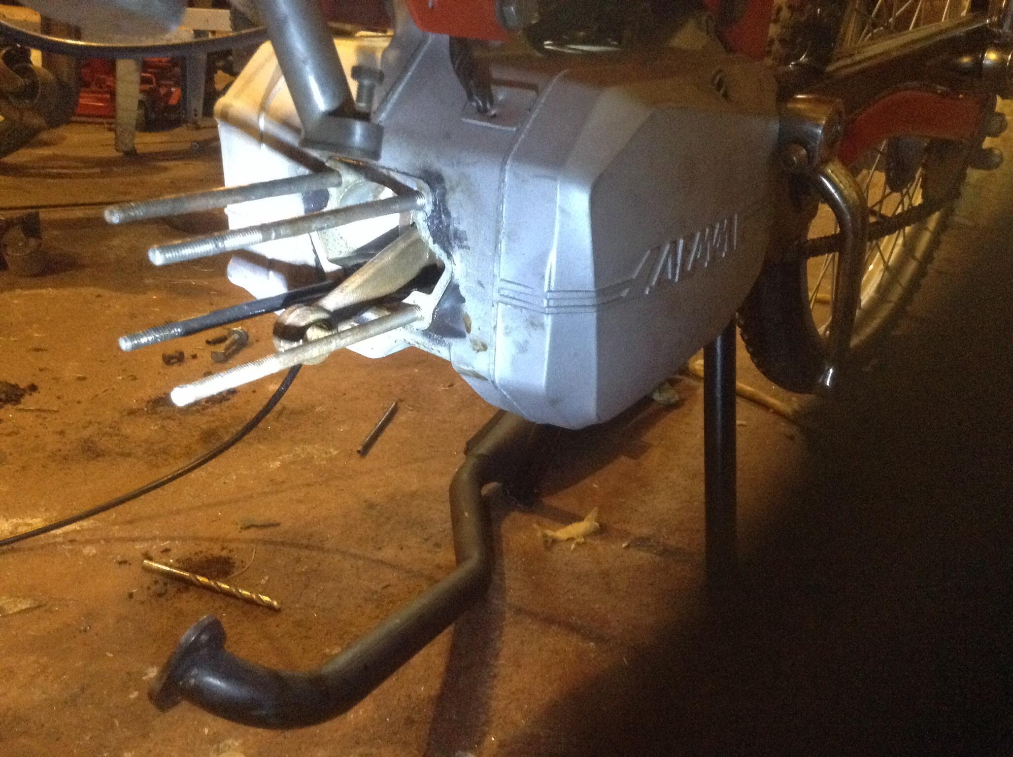

......piston is in....only prob is ...... After i cut my own gaskets.....put on the rings..... I realize the threads on the bolts are.....welll fucked.....trying to retap....trying tosave life......noguarantees........shitsfucked.....hashtagandshit.....
