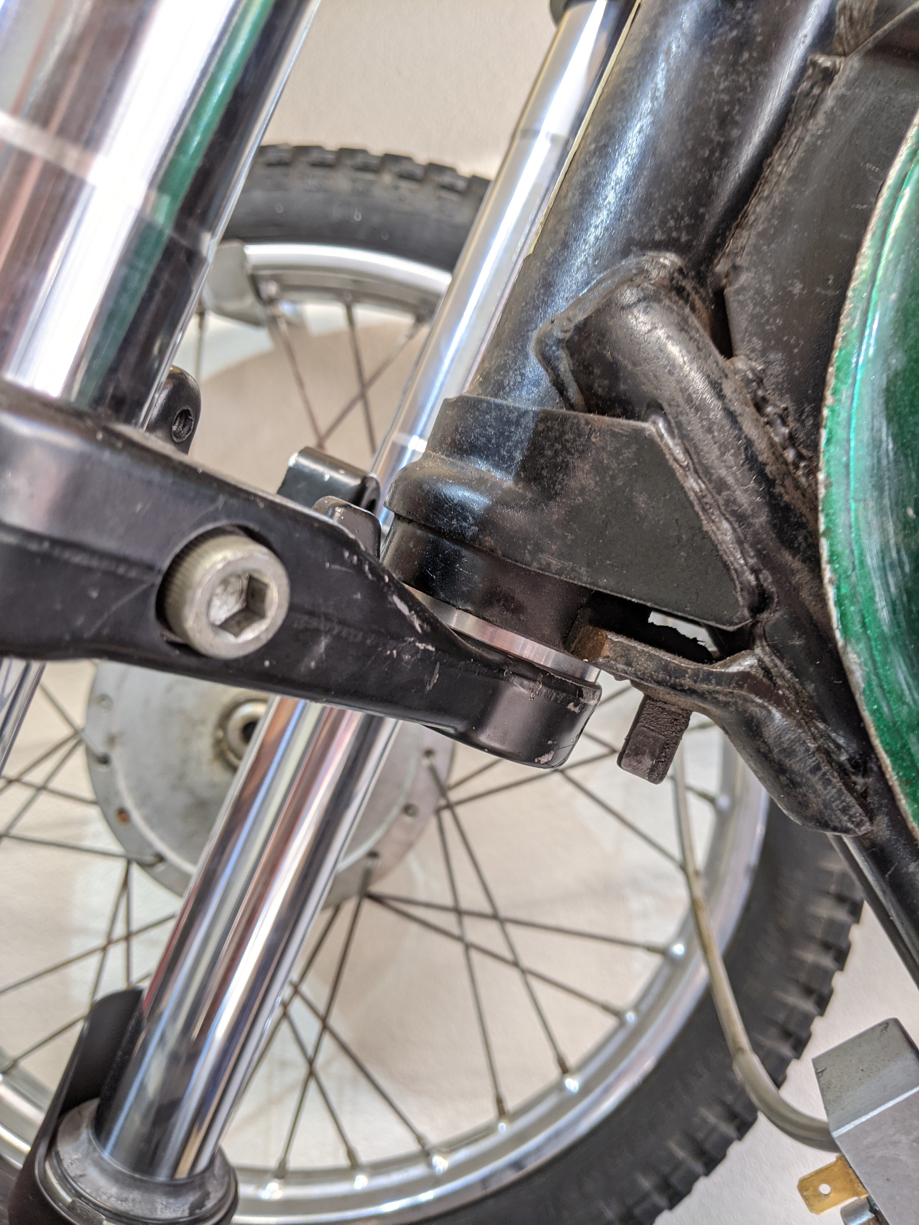

I found that BMW K75 clamps have the offset and width I wanted for 41mm forks, so I put together the front end with a mock up-wheel from my Honda 450 flat track bike.
This is only a mock up since the BMW K75 steering stem needs to be pressed out and turned down still to accommodate the DT3 bearing ID. As luck would have it, the DT3 frame doesn't have many conversion bearing options, so I'm better off modifying the stem to fit.
Next up - find a brake rotor for my DL1000 wheels so I can set the caliper and make the correct wheel spacers.

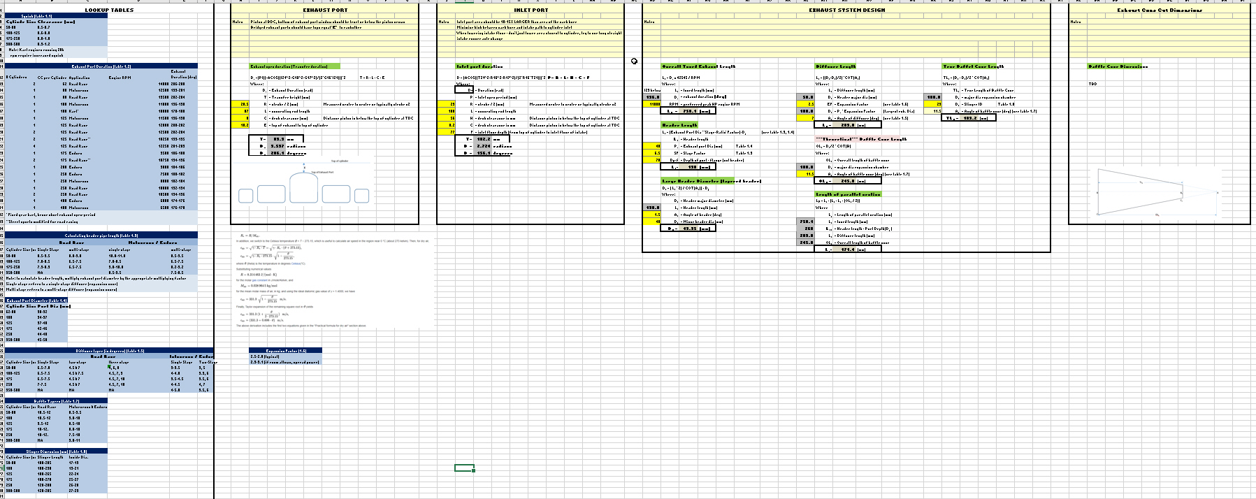

I'm converting the A. Graham Bell equations into something I can use. Turns out there were some author-freedoms exercised in the equation prints, so I've had to debug some of the details along the way.
They don't take into account exhaust temp, so I'll be modifying the tuned-length equation to ensure it matches the EGT's once I get some HP predictions/estimates and header temps.

Over the weekend I looked into the affect of assumed air-temp in the chamber and it has pretty drastic affect on overall tuned length.
For instance, assuming 500 deg Celsius @12,000rpm with 200 deg exhaust port timing, I get a tuned exhaust length of 762.8mm
When the exhaust is cooler, say 260 Celsius, the tuned length is 639.1mm.
That's a pretty big difference!
Considering how outside air temp, material thickness, and energy expelled may affect the pipe temp, I'm beginning to understand why 2-strokes are so finnicky while warming up. This also makes me want to research actual exhaust temps for similar builds before I assume something too far off.
Looking back at A. Graham Bell's numbers, it looks like he assumes an air temp around 375 Celsius to get a speed of sound at 510 m/sec. So his version puts the tuned length of the above example at 709mm.
Food for though. Something I'll use the next scooter pipe to sort out I'm sure.
Edit: I think I can also use the stinger exit OD from the chamber as a way to tune temps. I'll have to watch for piston temps too though at that point. Fun fun!

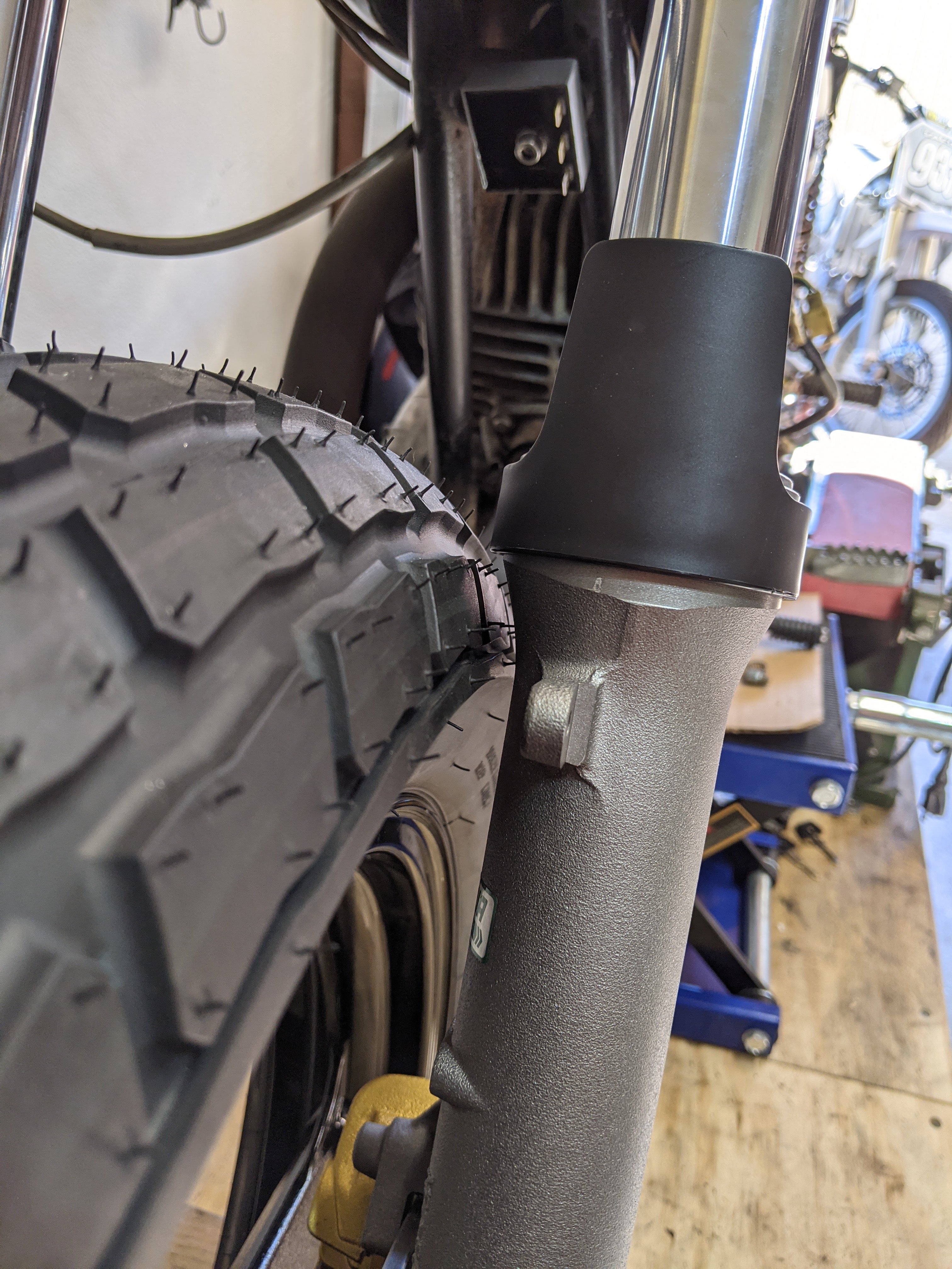

Big update!
Lots of little spacers, adapters, and some clearancing all wrapped up. This gets the wheel and fork placed correctly with the stock frame.
Here's what had to happen:
1.) Lower BMW K75 steering stem bearing diameter turned down to fit an adapter bearing from all-balls
2.) Upper BMW knurled bearing retainer surface turned down to fit an adapter bearing from all-balls
3.) GSXR 600 Rotor turned down .080 from the OD
4.) Picked up DL1000 rotor bolts in place of the GSXR rotor bolts (they're slightly shorter, don't bottom on taper before snugging up rotor)
5.) Spacers galore made for the wheel/axle spacing
6.) Massaged the fork a smidge to clear the head of the rotor bolts
7.) Massaged the caliper mount to bring the fixed portion opening closer to the fork leg to better align with rotor
8.) Made a spacer for the lower clamp mount for the bearing to bottom on - necessary since the BMW lower is flat, but the DT3 stem had a shoulder ~.230" tall
9.) Mounted the new Shinko, held breath, and everything cleared.
I may need to further clearance the rotor and fix portion of the caliper. A trusted friend has suggested things get hot, things rub, and then things need to be reworked as a result. Something to monitor.
The front's not done, but I needed to get this far before I was comfortable setting up the rear and taking some measurements for trail/rake and making a new swing arm.
The black rim looks like crap. Makes the tire look massive. I'm looking forward to getting them power coated gold/bronze when I get the rear ready.
