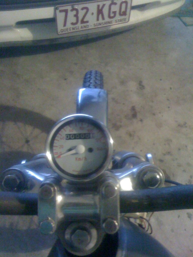

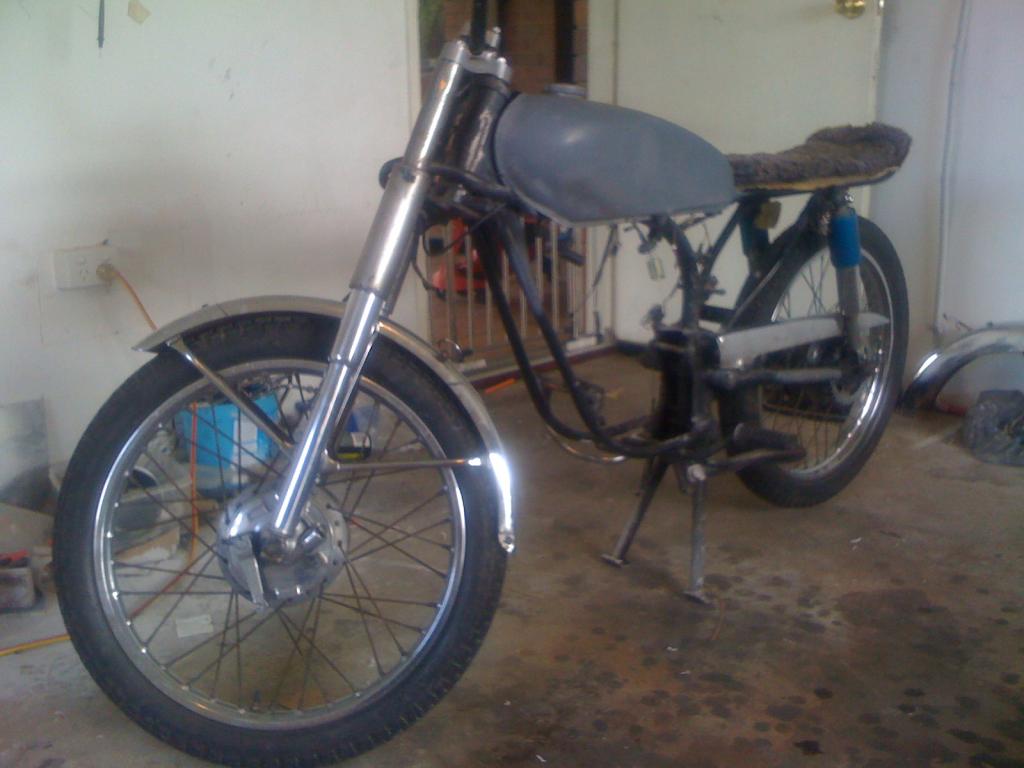

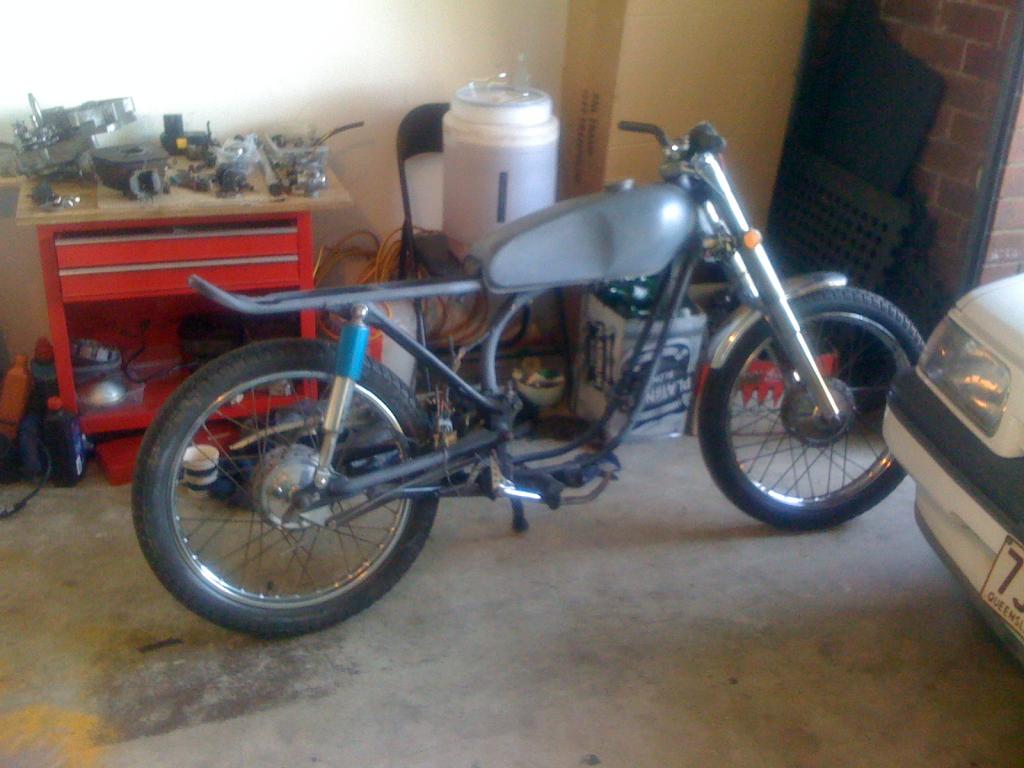

A few more (crappy quality ;)) pics... The Chinese speedo turned up so I went about making a bracket to fit to the stock ignition key location,
Also de-tabbed the frame a bit.

I lightened a few other pieces up a bit with some lightening holes ::) still a little tiding to do on some of them (I got a bit carried away)

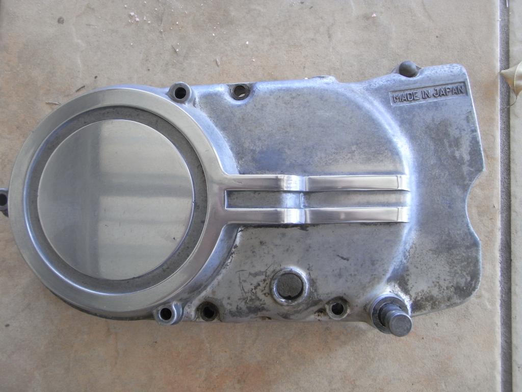

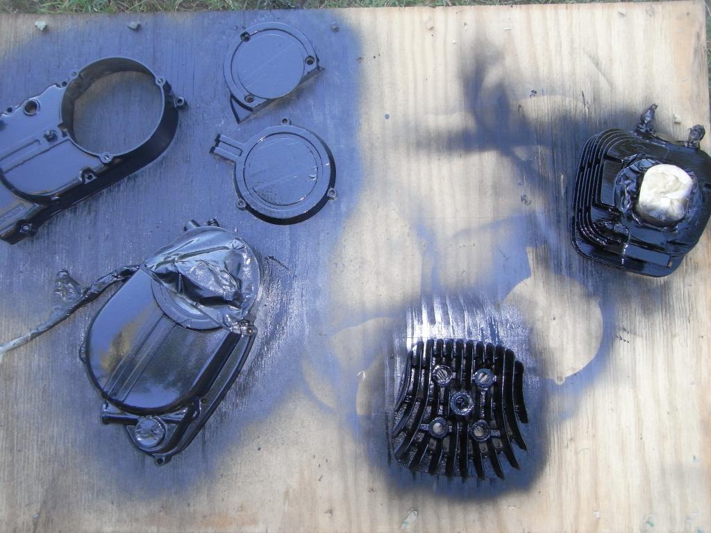

I got a bit more done this weekend, I primed and painted the cylinder and head with high temp gloss black and did the side covers in hammer finish, The Hammer paint has a little bit of a metallic look to it that doesn't really come out in the photos.
I polished then masked off a couple of bits on the side covers.
Also I got the bearings and seals in and the engine 90% back together, And for anyone that was interested the dt100 bearings and seals are a perfect match as predicted...
