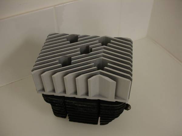

I dont have any funds to spend on the bike at the moment which is a bitch as Im itching to get some tyres on the wheels and get the bike into a rolling chassis and build myself some fenders. So Im going to start stripping down the engine and making a parts list. I spent last weekend doing some research and Im leaning towards putting a 350 top end on, wanting to customise it somehow Im thinking of knocking up my own Webco inspired heads. I dabbled by taking measurements from the original 250 heads I have and looking at pictures of webco heads on the net. I drew up a design in Pro-engineer,as it is paramentric software I can alter the dimentions of the model and it will automaticaly regenerate once I input the correct dimentions for a 350 head.
Having drawn up the initial design I machined a prototype head in pink tooling board, it cutts quickly and holds it's dimentional accuracy well. I dont like the design, it's too square, I think the head needs to follow the profile of the barrels. The sloping top works, it's nice to see the zig-zag detail from the side view...so back to the drawing board.Hopefully I can get some RD350 heads soon to measure or idealy some dimentioned drawings of the combustion chamber profile...any advice on the design greatly appreciated.

I re-drew the head in CAD this week, it now has the same profile as the barrels and a 10mm radius on the top and bottom edges. The fins are 3mm thick. Im hoping to get the dimentions of a webco head soon, I will then cut a prototype in tooling board to check the surfaces and dimensions before machining a billet of ali.

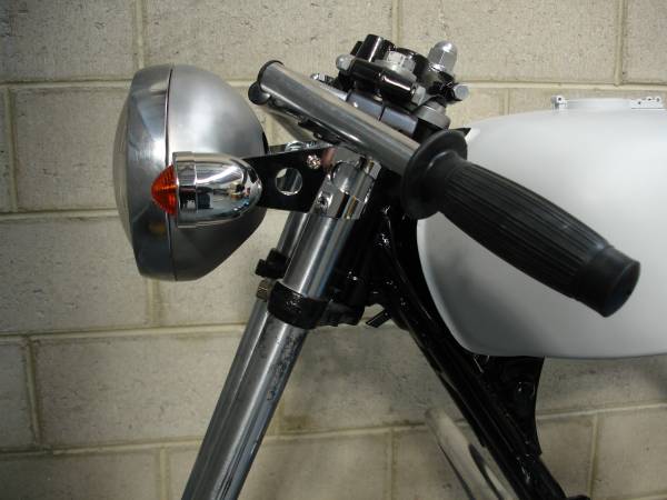

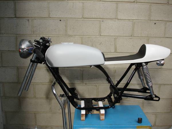

In the mean time I bead blast the headlight and got it back on the bike with some ears I bought off ebay. Im not happy with the way it looks, the ears are to short and wide, I think I may make my own. Im also thinking of putting a small front fairing on. Not much work happening at the moment due to lack of funds and the awesome winter weather, clear blue skys and 20c degrees in Sydney this weekend 8)

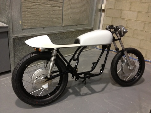

Merry xmas guys, Santa bought me some some tyres for crimbo! ;D
I've not done much on the bike due to a lack of funds but now the tyre's are on Im really happy with the look and itching to get more done, hopefully I will get some time over the holidays to spend on the build.
