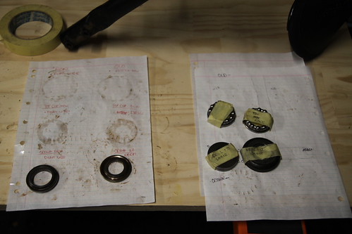

Tapered vs straight. I will have to bore out the stock races and cups.
Hmmm....I'll make it work.

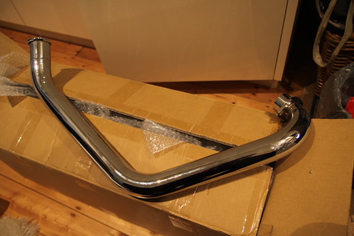

Pipe's not going to work. I'll get a scrambler pipe bent for me stuffed with baffles - gotta keep the notice within reason.
More updates very soon...

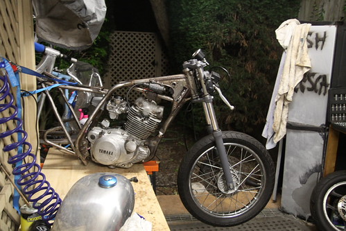

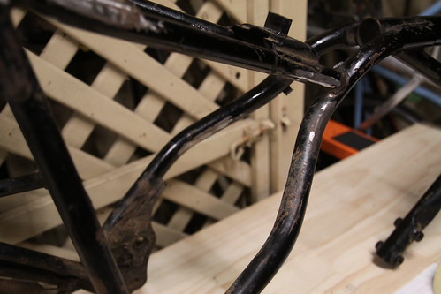

Lost my job on the 22nd of December. Merry F'n Christmas. Decided to raw the frame to keep costs down.
New front end from a Yamaha XVS250. Went in with the assistance of original cups and race. Painted DIY with WhiteKnight Enamel spray paint. I think the grey-blue brings out a nice bit of colour.
New headlight, clip-ons (untill I can decide on bars), clutch lever and Oberon bar end indicators.
Mounted a mini speedo.
Without tank.
With tank.

"New front end from a Yamaha XVS250. Went in with the assistance of original cups and race."
Any more details of this swap (I assume the Kawa front end got too $$$)? I have a SR250 I'm trying to turn into a low-budget street tracker but converting to front disk would be nice.

I've had a whole heap of progress recently so I will post up pictures plus pictures of my fork setup. To be honest if you can find an xvs font, mess armond with cups and races and it will go straight in. I'm pretty sure I used everything from the sr fork except star nut.
Kawasaki front end was going to be to expensive and I would have needed to machine brake mounts and build a new spoked wheel.
