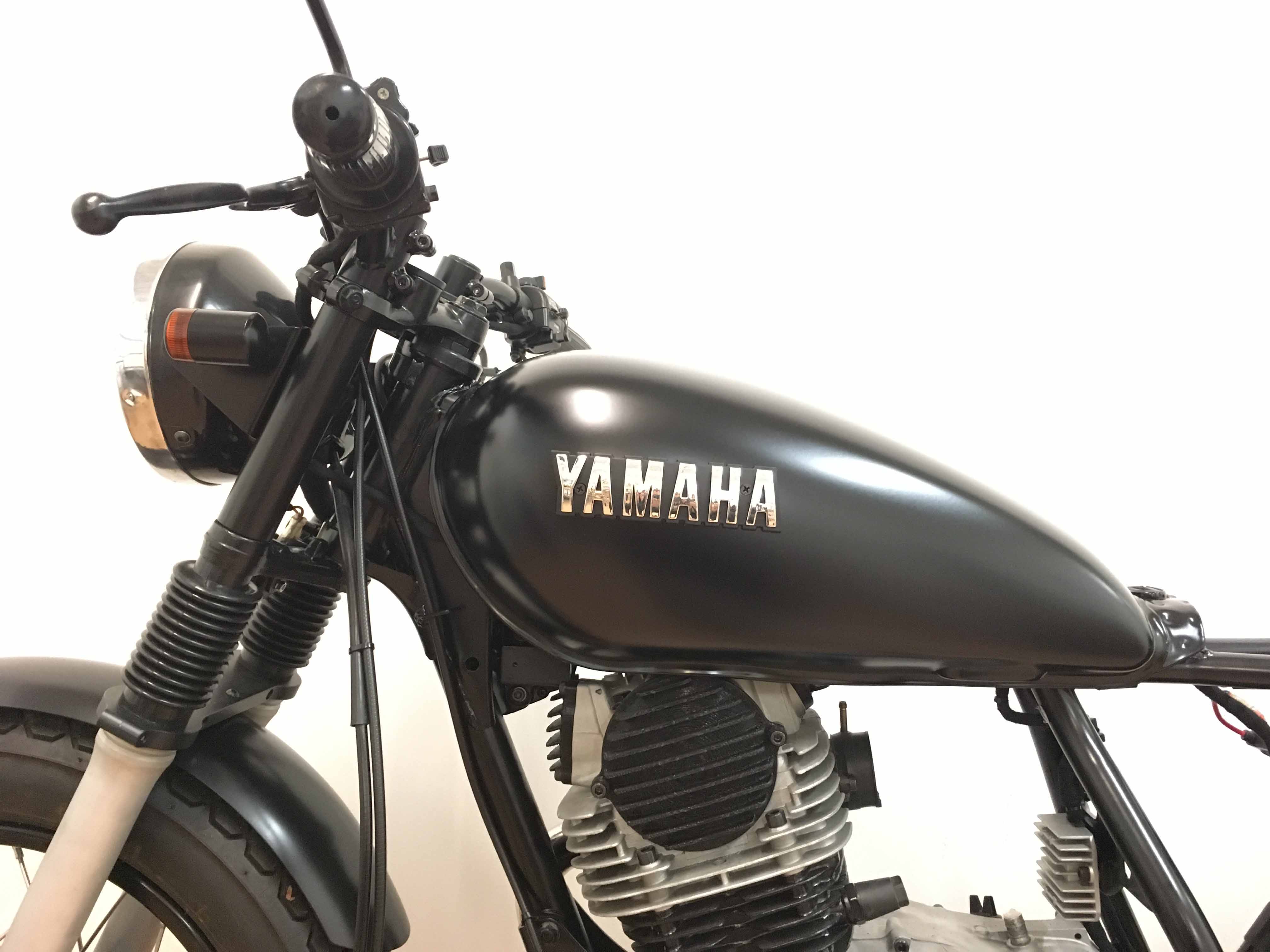

Got the tank back from the painters today and it is awesome. I think he did a pretty sweet job of matching the satin black of the frame, fenders and headlight ears :)
One thing I don't like though is how the Yamaha badges sit on an angle in relation to the bottom of the tank. This suited the bike/tank in its original location, but now that everything is all levelled out it really bothers me. I'm thinking about trimming the screws (so they are only the countersunk head), glueing them onto the bags, then putting the badge on with automotive double sided foam assembly tape at the right angle I want...

Jadus,
I'm not able to see how the orientation of the YAMAHA badges are in relation to the rest of the bike as it sits on it's wheels or ride height;they are not straight ?
grcamna5 said:
Jadus,
If you click on the image above (SilverYamaha) it will open in a dedicated window. It looks like the tail end of the YAMAHA script is lower than the leading end.
You're right zap. grcamna it is a bit of a bad photo to show it but the logo does lean back. At least 10 degrees I would say. I am being pedantic now, but seeing as I have treated most parts (down to every last nut and bolt!) with a detailed eye, I figure why not get the badge spot on as well. After all, I love yammies and it should be straight haha ;D

Just for reference, here is a better, clearer image of how the tank badge sits in relation to the bottom edge of the tank and the frame rail. I will definitely be placing them in the position I want with the double sided foam tape and just putting the screw heads there.

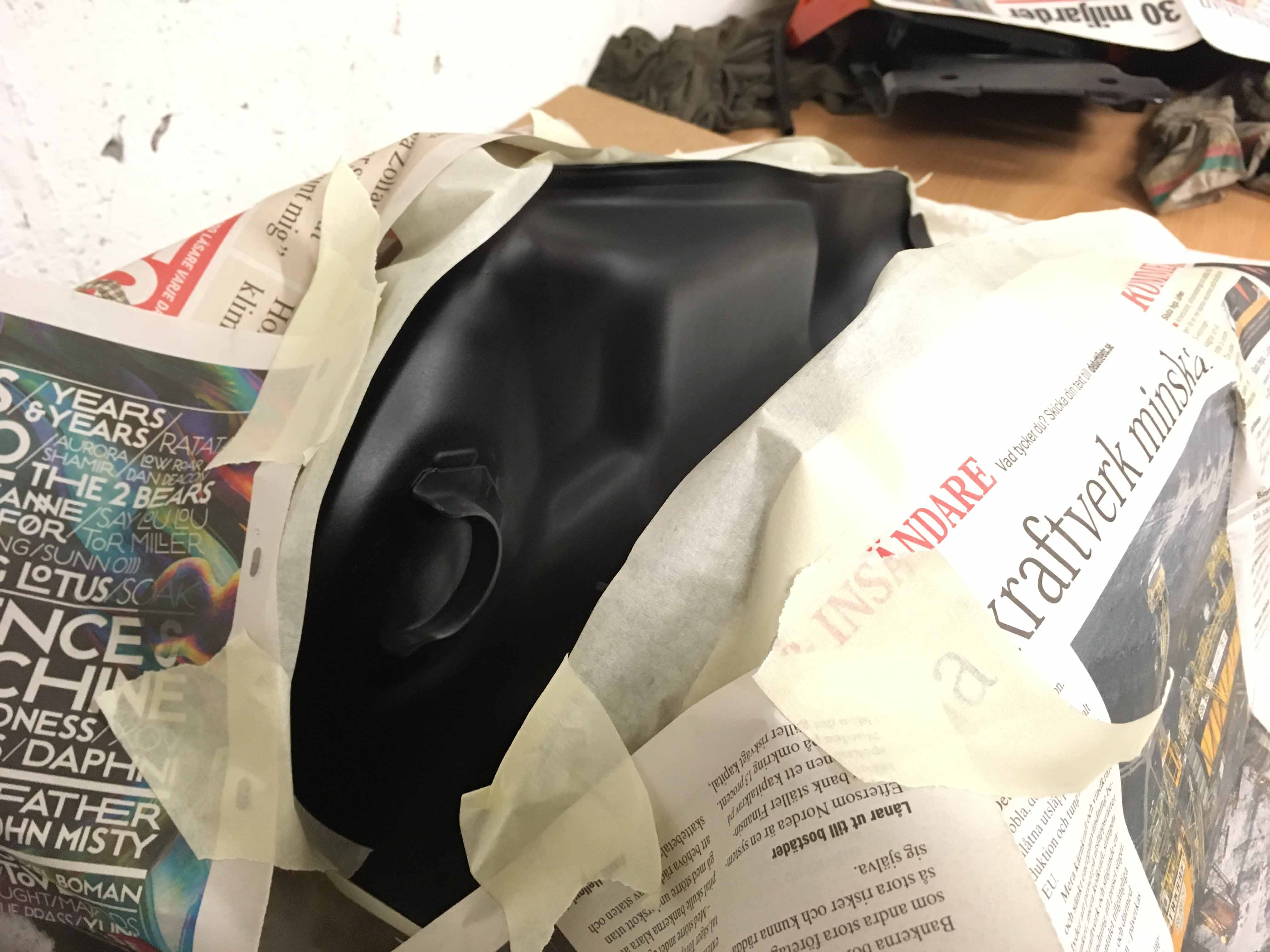

Every one of these bikes I have owned, the underside of the tank has had surface rust on it. With this one, I blasted all that off before taking it to the painter. Then when I got it back, I see that the underside isn't covered! After looking at the other 2 tanks I have, I see that they are not either... Is it difficult to get into the tunnel with a spray gun? Or is it just considered not important? Anyway, I masked this one up and bombed it with some satin black to at least cover the bare metal. Don't know if it will help at all with corrosion resistance, but it did something for my peace of mind anyway! Managed not to mess up the top side with over spray ;D
I agree with you on the tank badge and good on you for fixing it, if you're like me it would bug you every time you looked at it so best to get it done now. Bike is looking great!
Thanks. Yep, its gotta be done!

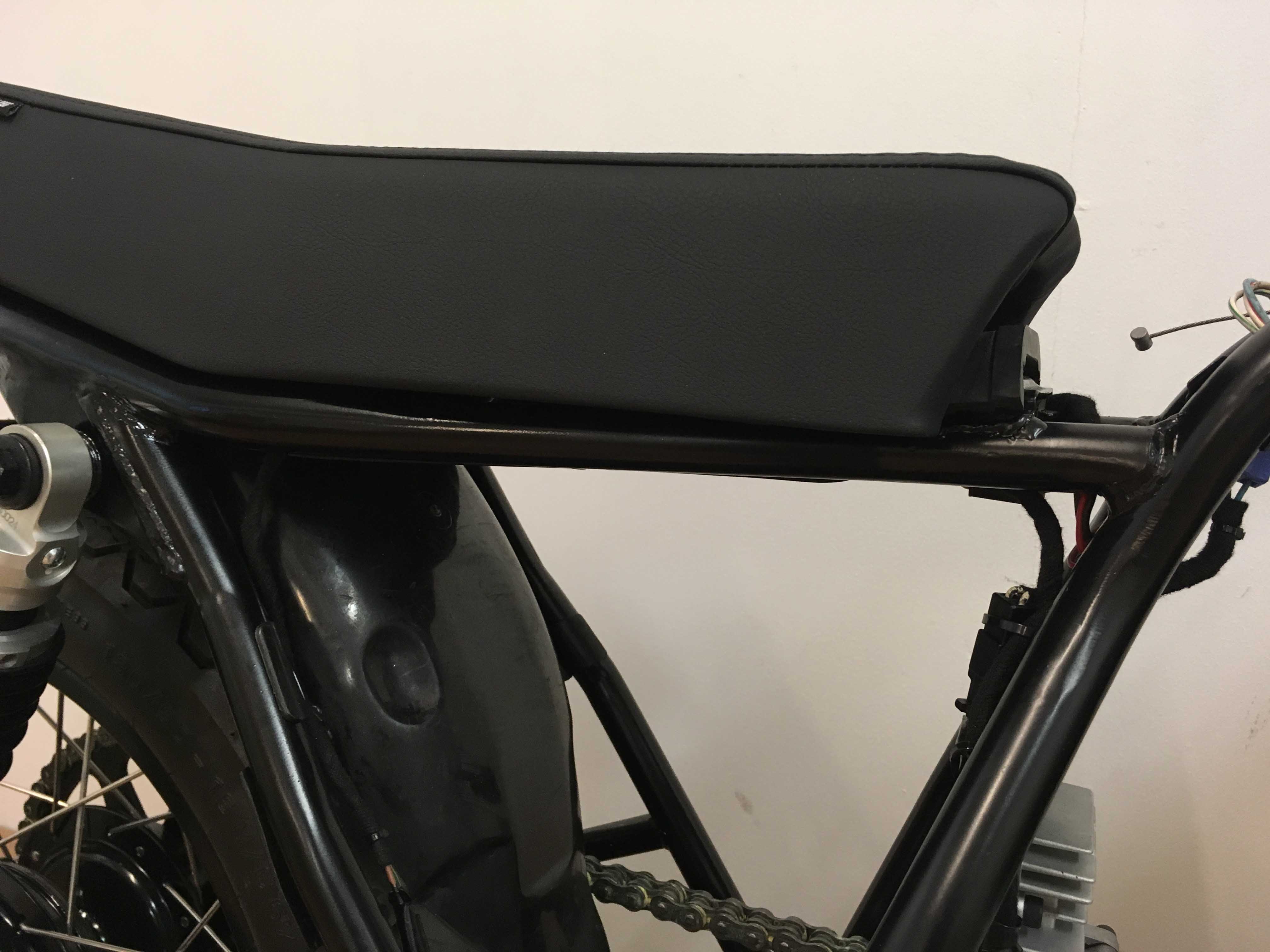

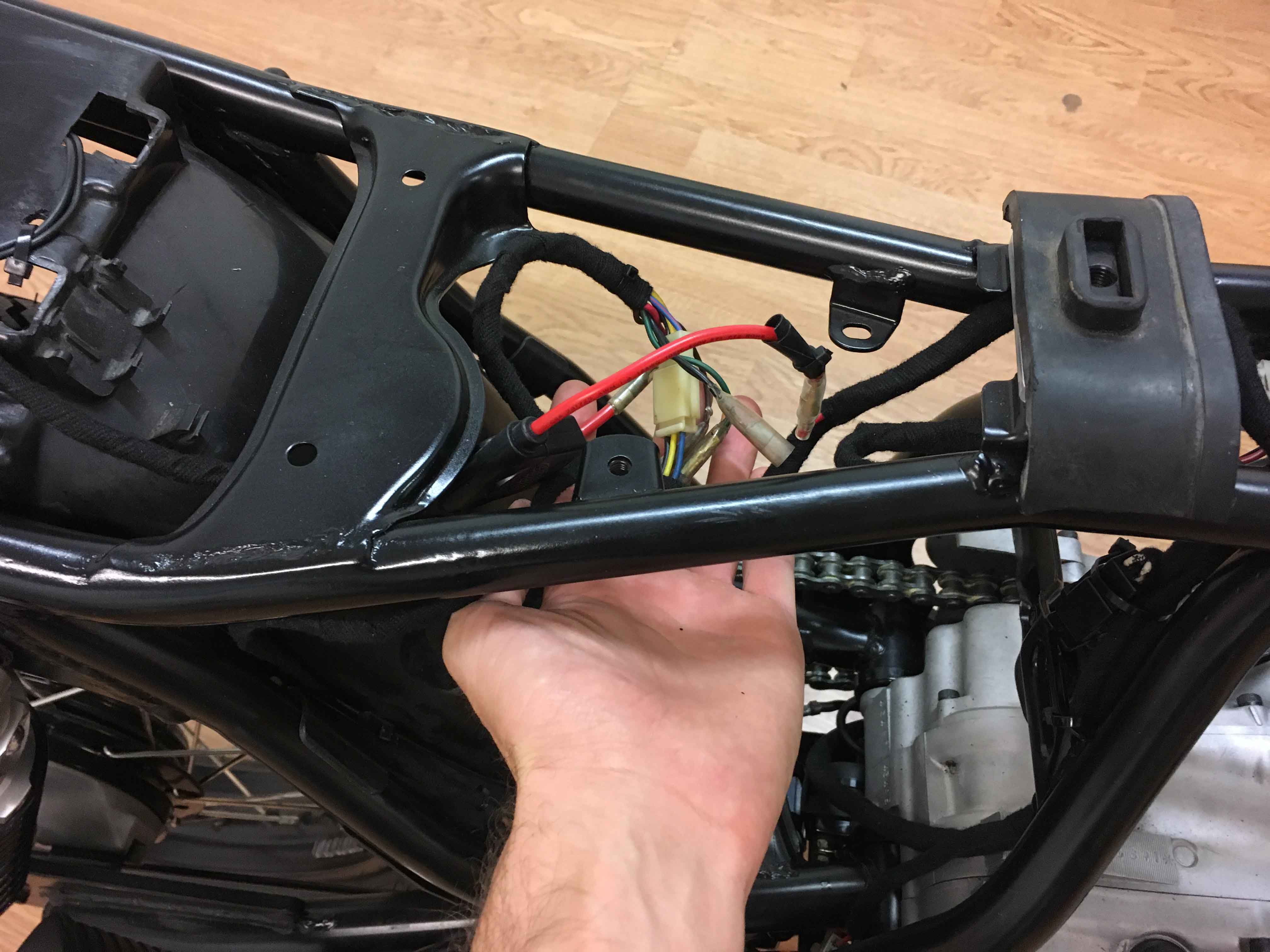

I decided I wanted to tidy up some of the wires under neath the seat. Even though the side covers will cover it all, I don't want to just cable tie things out of the way. I think I'll just cut up a thin sheet of aluminium that mounts up to the small bracket under the seat (luckily I didn't remove them!).

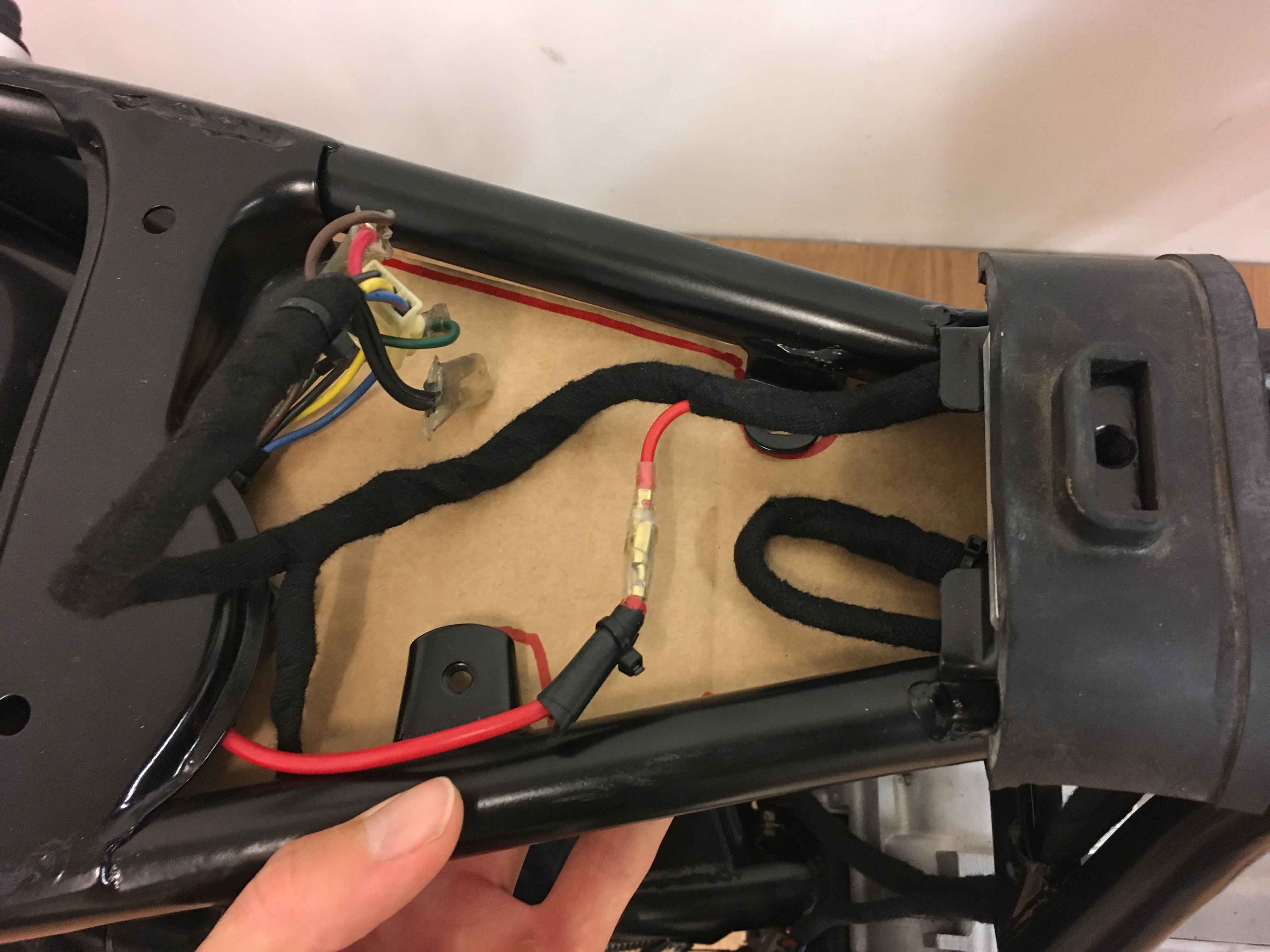

Some progress with the electrics tray/tidy. Yay. Originally I was going to bolt it to the underside of the tabs, but then decided it would be cleaner if it was up under the frame rails slightly, hence the two mock ups. It was sweet to make it out of 2mm ally sheet so I could just use the snips. Nice and easy. Then a sand and matte black paint. I love button head machine screws too ;D Now you can't see anything in terms of wires from a side profile view.
I don't think I'll tidy the wires up any more than this, as long as there won't be any shorting happening and they are out of the way. Just really want to avoid more cable ties!
