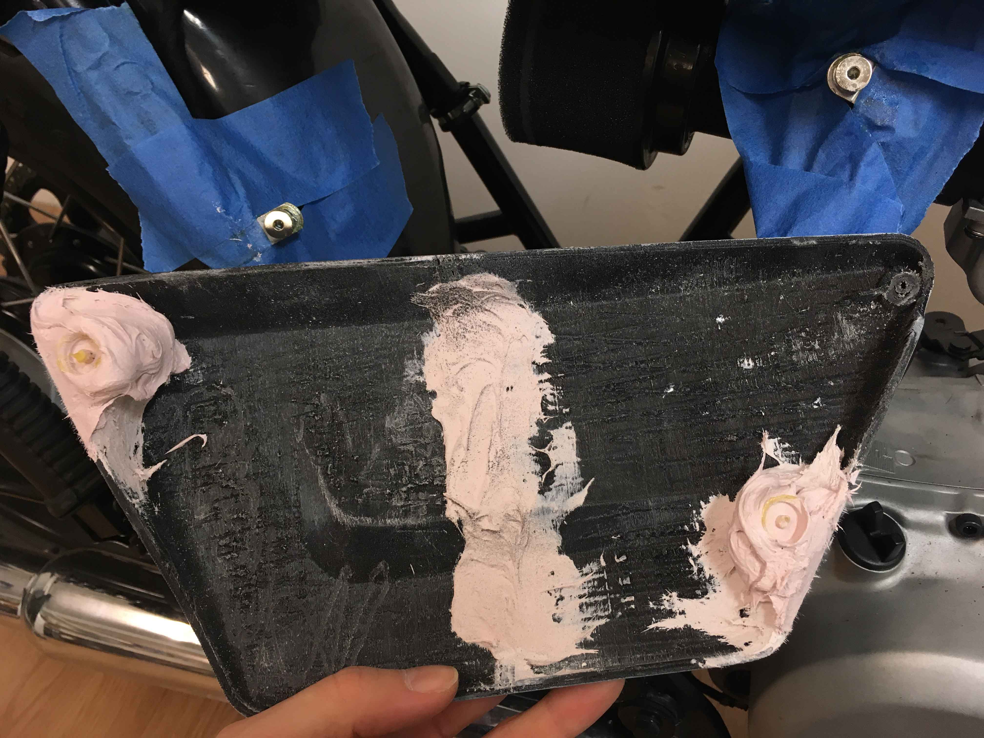

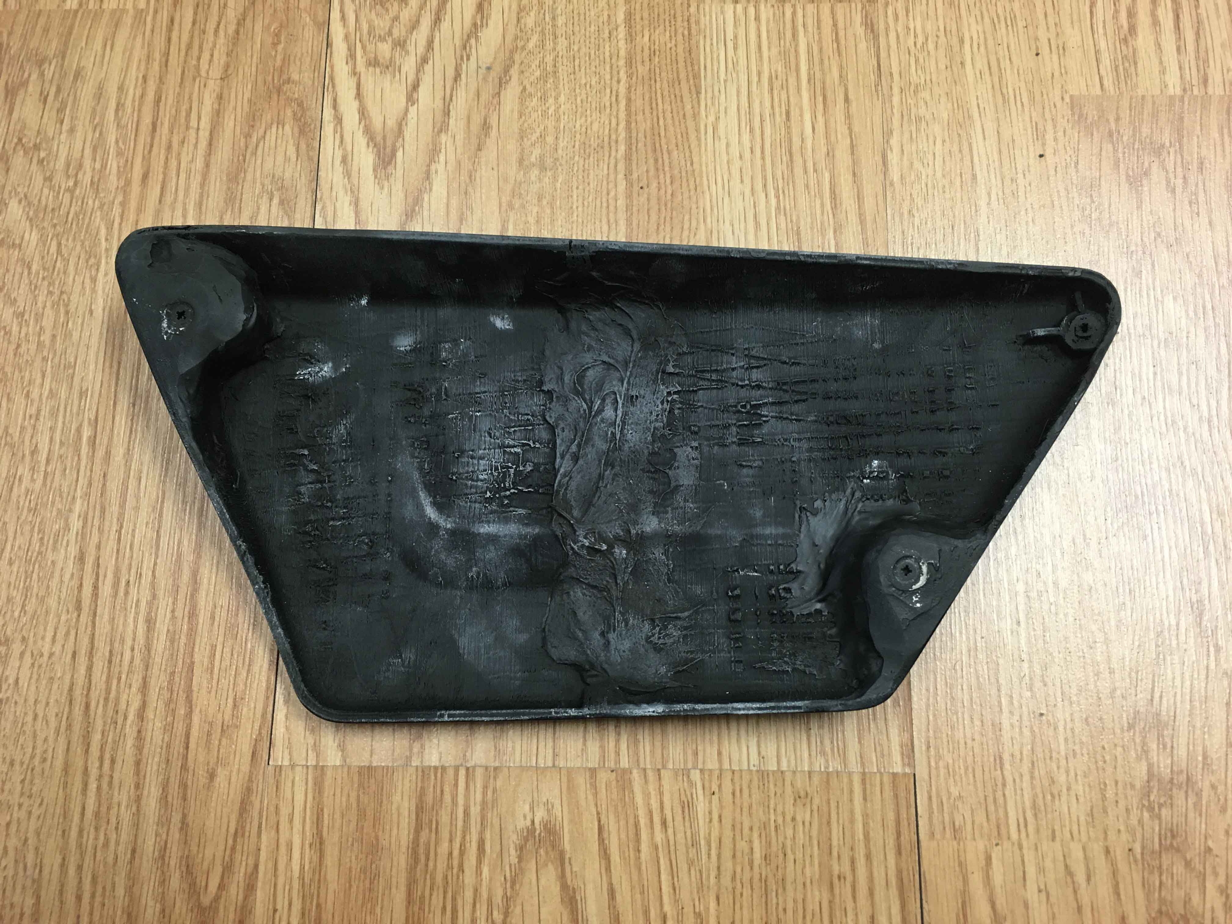

Thanks guys. Yeah I took some photos of that, forgot to share - see below. The rear of the covers is far less attractive than the front. I used filler to make somewhat of a mould and pressed it onto the magnets I had on the frame while it was still soft. I covered the magnets and brackets in grease so the filler wouldn't stick. Then I cleaned up the filler (dremelled it back to a smooth clump) and glued and screwed the neodymium magnets in place. On the frame are just standard 7/8" and 1" tube/pipe brackets (that I will eventually paint black) with a large countersunk screw head - these are what the magnets pull on to. They seem to hold in place really well, but we'll see if they stay there when riding. If not, i'll try fixing them from the rear in another way.

zap2504 said:
Ok - so the silver straps on the frame tubes (above pics) hold the neodymium magnets in place.
Yeah almost. The magnets are actually inset in the filler on the inside of the covers - held in place with a screw and glue (they were magnets with a countersink on one side). Then the frame just has some bolt heads. If I need a stronger clamp later, I could add magnets to those braces as well - bolted on.

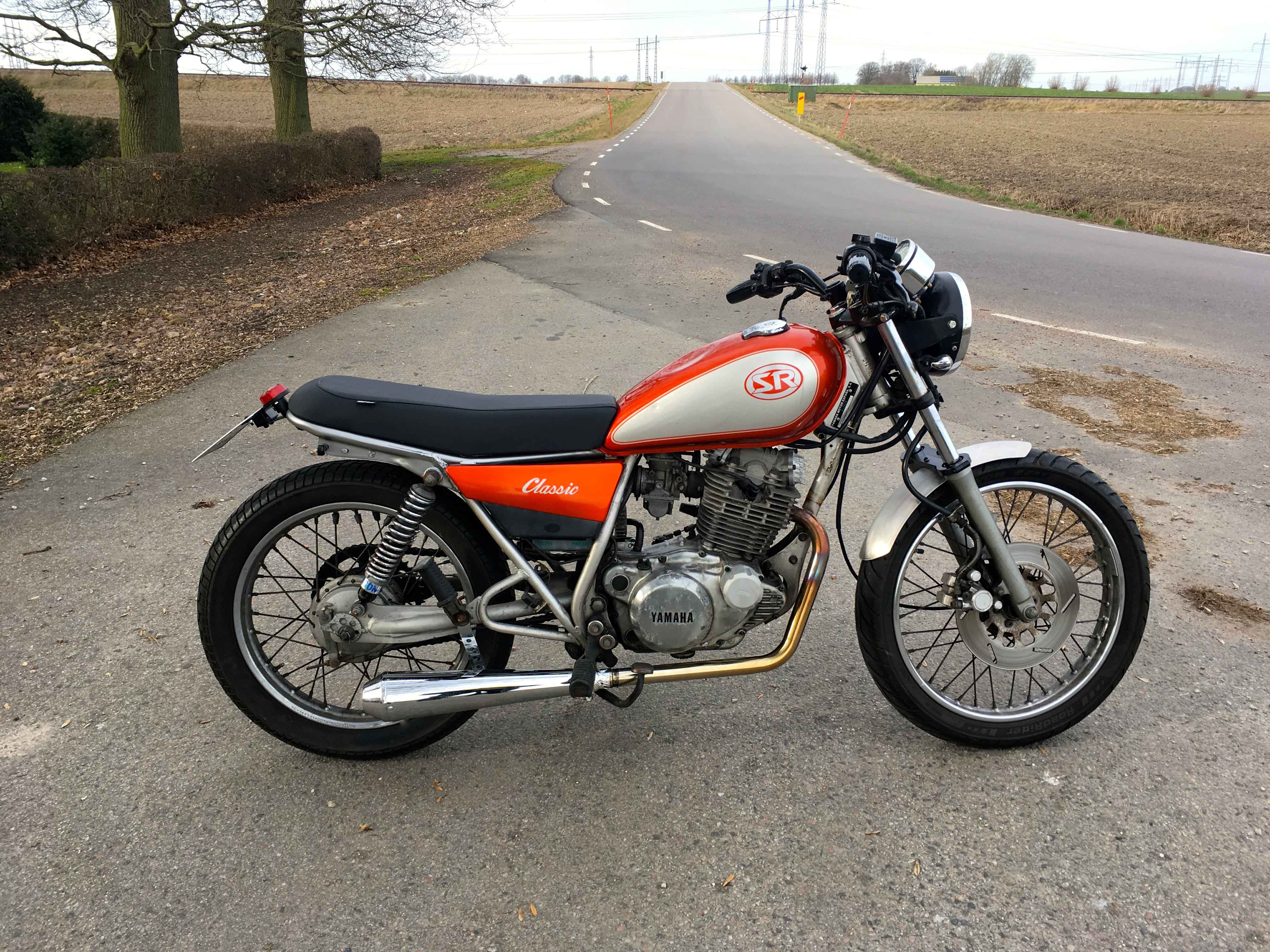

Got a nice ride in today on the test mule. Spring is definitely in the air, although air temps have not made it to 10 yet!

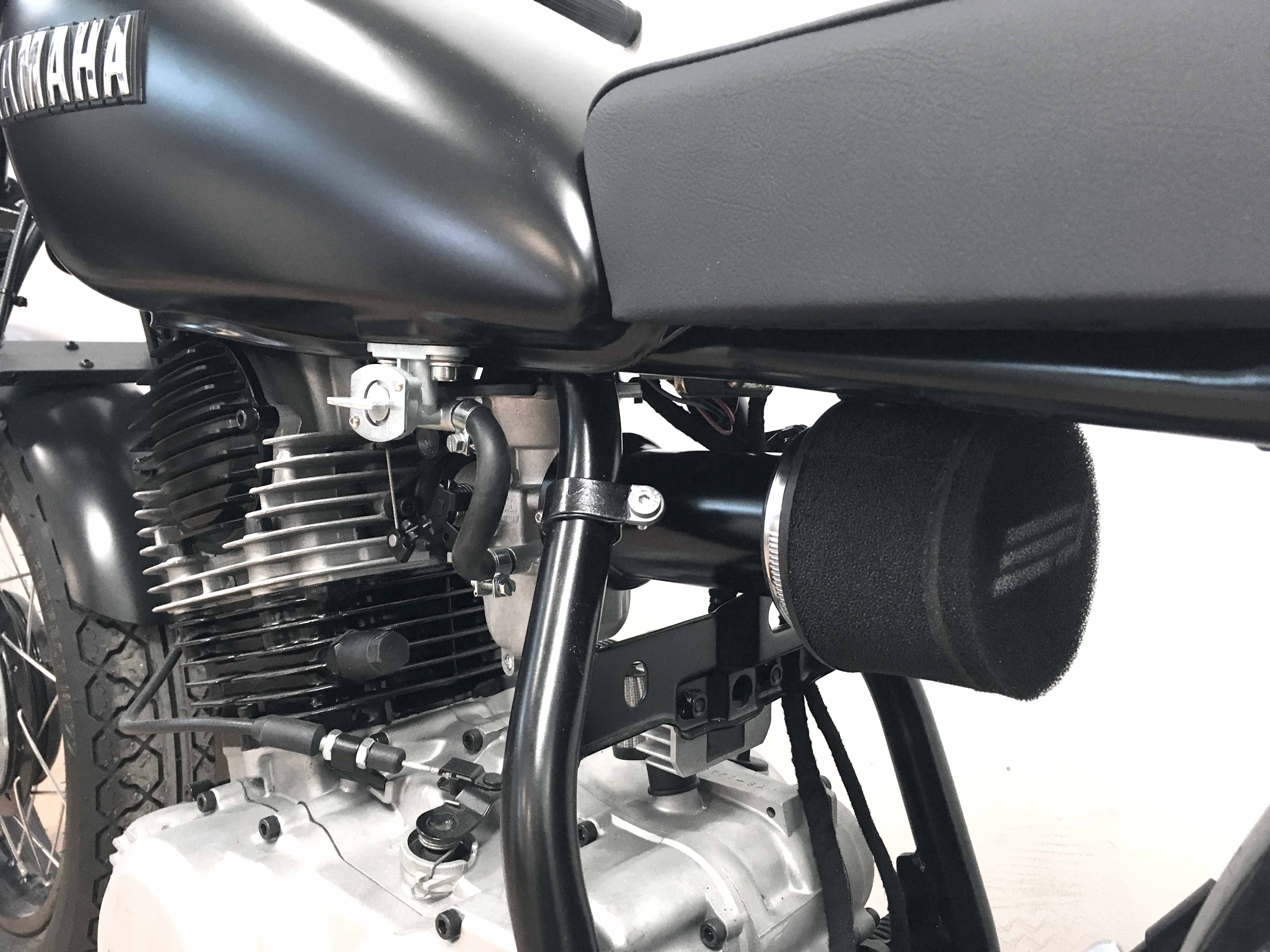

No all mounted - along with the harmonic intake and foam filter - with Jadus logo :o ;D

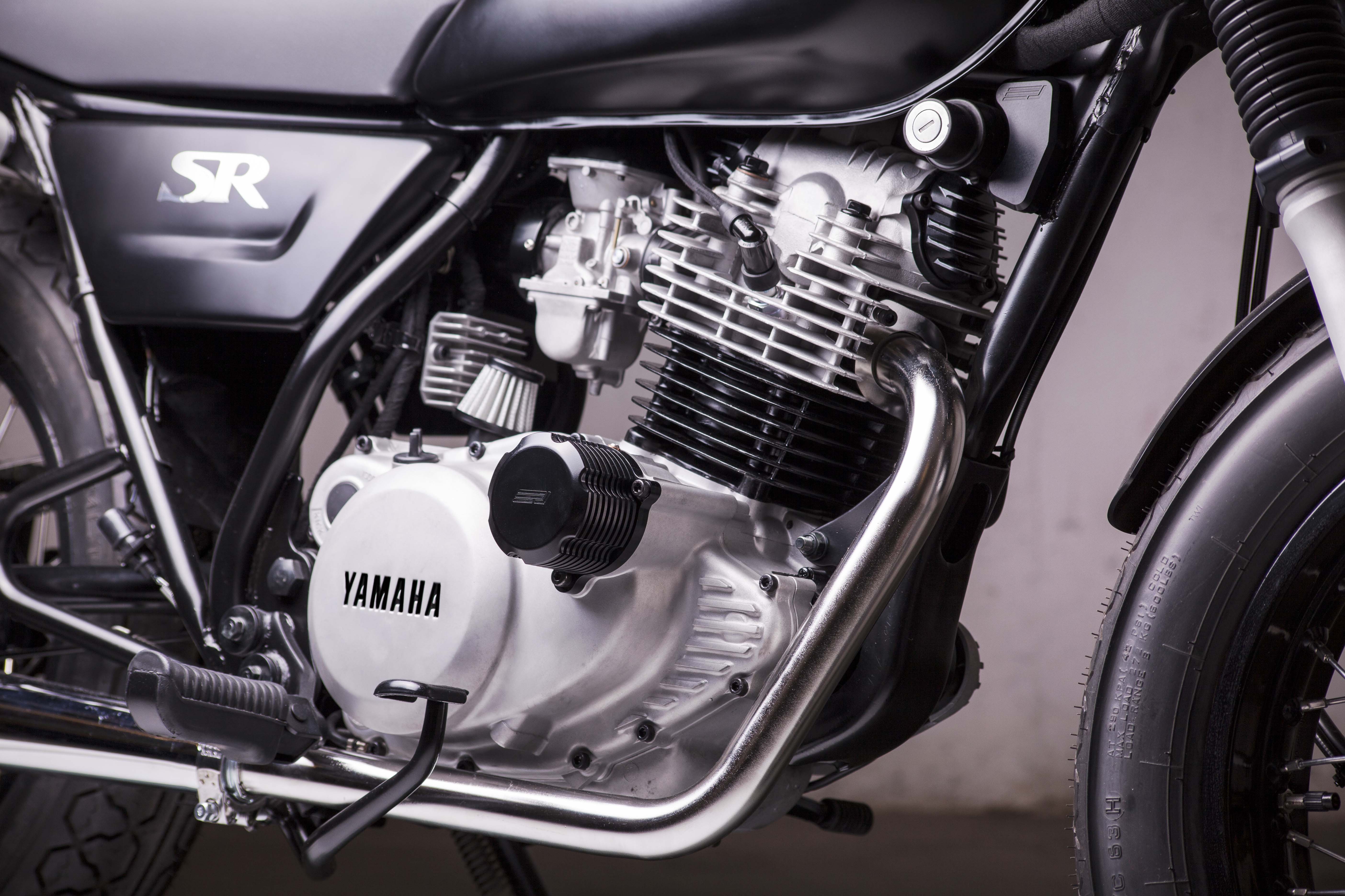

That´s looking really cool.. and I look forward to the results of your jetting/carb settings.
Are you using your ´Ignition advance´modified timing pick-up ?
Thanks guys!
Yep, using the advance brackets, they seemed to pick up some torque low down and in the midrange, without affecting the top too much. I actually just placed a production order for them, hoping other people are interested. I'll share jetting in another post, because I tried a lot of settings with different set ups, interesting stuff.

It feels like an eternity since the photos were taken and I am just waiting on a few more of the hero shots to come through. Patience, I keep telling myself.
It would be rude not to share with you all a glimpse of what is to come - here are a couple of low-res detail shots that I got a couple days ago. Cheers.
