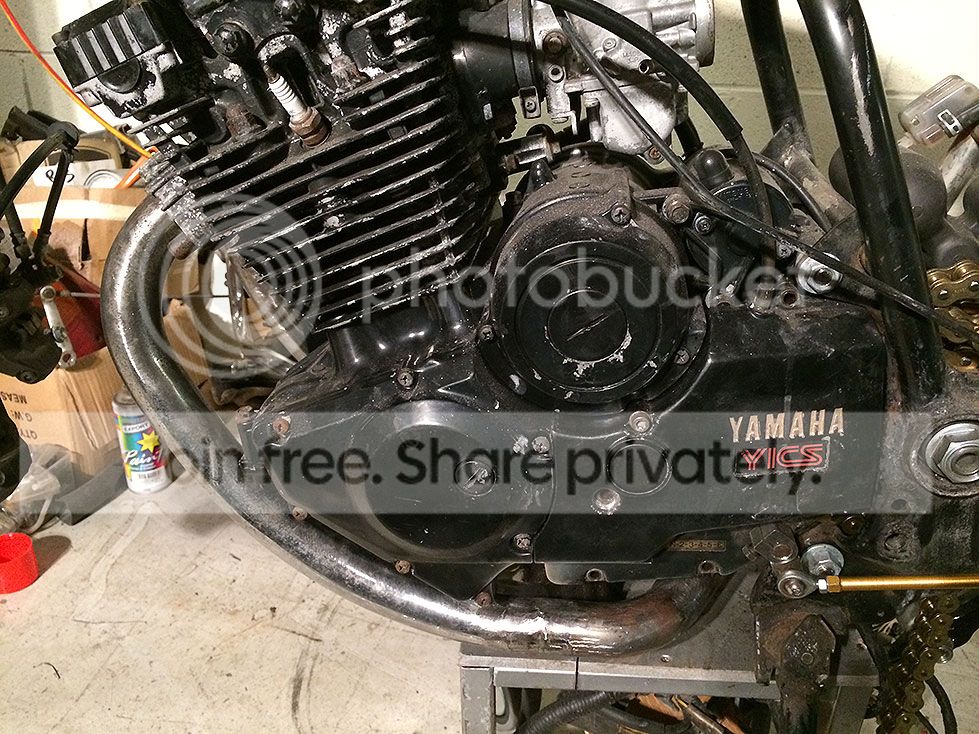

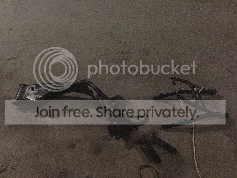

First up was teardown. You may have noted the bent fork legs and general ugliness. In keeping with my direction I'm keen to feature some more modern suspension and brakes, and I'm also keen to run wider tires than the stock 110's.
The engine hasn't run yet, but a compression test showed good numbers and the PO said it had run up until recently and then 'wouldn't start'. Some quick troubleshooting showed two burnt out coils - ignition has probably been left on for a time and fried them. In short I'm confident I'll get it running when the time is right.

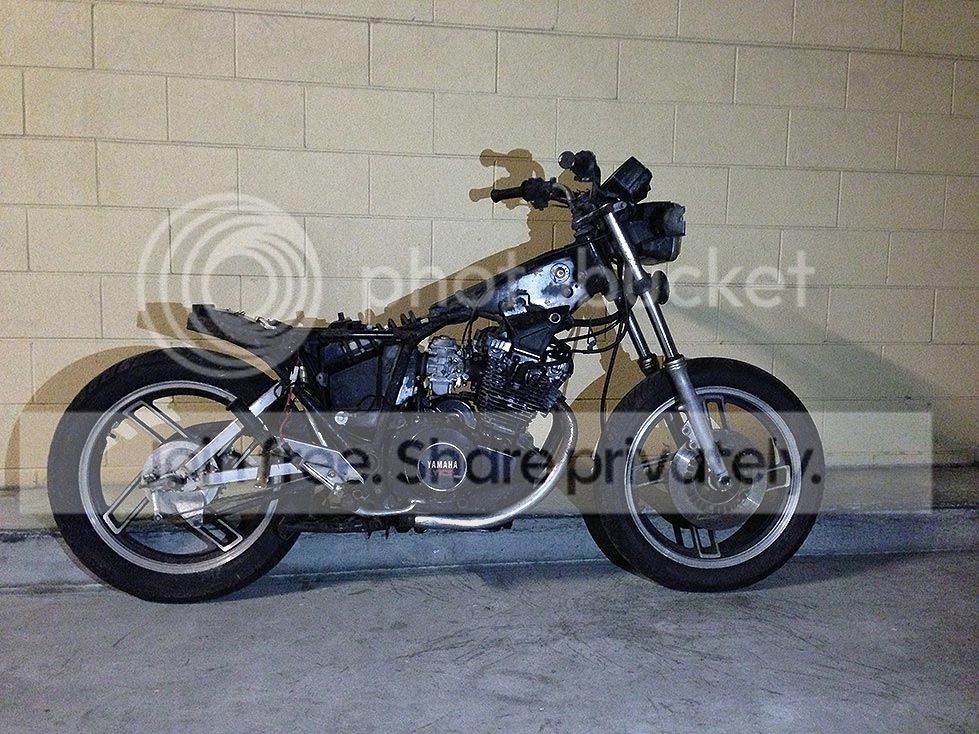

Splitting the engine from the frame, results in not much left, particularly as I've decided to remove the factory rear section to fabricate my own..

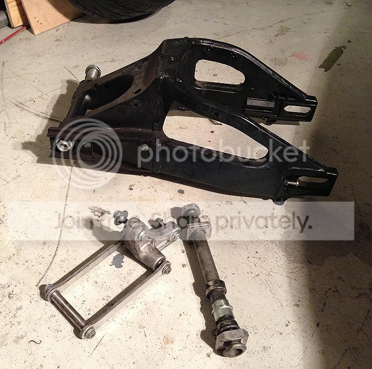

The rear swingarm is a very nice piece that also weighs about half (or less!) of the stock steel monoshock arm. It is also 2"longer and I think some wheelbase extension is a good thing on the XS400 platform. The challenge is getting a chainline with a 180 rear tire, and also the overall width of the swingarm. It's about 20mm wider than stock. I contemplated machining down the arm but then chain clearance would be impossible, so the only option is to widen the frame.
Above is the frame widened, complete with lower centre stand brackets cut off and the mounts added for a GSXR linkage. The goal here is to replicate the entire rear suspension of the GSXR, including dogbone linkage shock. I ended up pouring over photos and diagrams of GSXR's and then measuring a real bike to get geometry correct. Fortunately adjustable dogbone links and preload on the rear spring will afford me adjustability too.

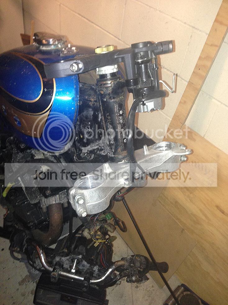

With me confident I'm going to get the modern rear end in place getting a front end to match is easy and has been done many times before. A set of all balls races and a spacer for the GSXR triple trees and these bolt right up.
The factory top triple tree has an ugly igntiion key set into it - I want a nice smooth look and will be relocating the ignition switch elsewhere.
First step is cut it off..
Then make up a metal spacer to fill the hole, and spend too long filling and sanding to match the edge profile from right to left.

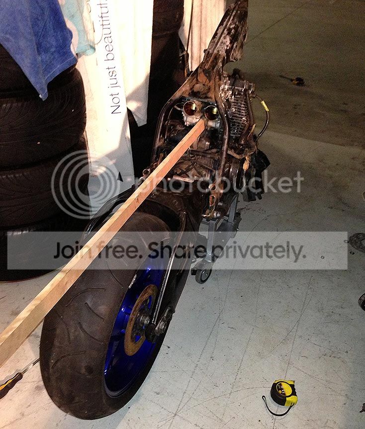

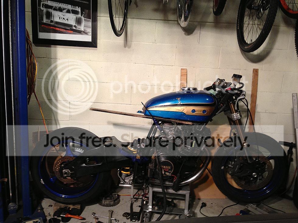

With front and rear ends in place (rear mock up height) I can start to see the lines of the bike before beginning fab on the rear frame section. Part of the rear frame will support the shock linkage so there is more to this than just cosmetic, but getting the lines of the bike right is still key for me.
The tank is sitting in place as it is also a key part of the overall stance. Here I'm using a piece of wood to act as a sight line and get tank and positioning right for rear subframe upper frame tubes.

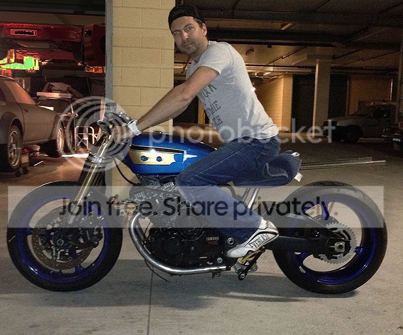

And lastly for now rider position testing! I think this is a good compromise between full on sportbike pose and a tourer - still aggressive but not too heavy on the wrists and feels comfortable!
You might have also noticed how poor the condition is of the engine / carbs etc. I'm hopeful though that with a lot of work these will come up nice again - the plan is some nice paint detail on the bodywork and blackout on lots of the mechanicals. Hopefully the end result can match the vision in my mind :-)

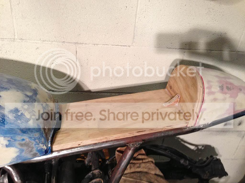

I think the cowl really needs to match the tank so it began by taking a fibreglass mold off the tank. I tape off the tank to stop the glass sticking.
I then sectioned about 3"out of the centre and trimmed the rest to get the desired shape and size.
Filler over the top and with some finishing this should come out OK.

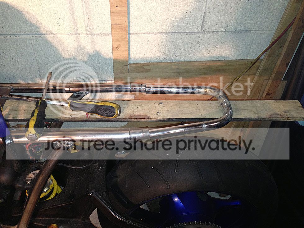

Here in Australia our rules regarding noise output are fairly strict, and I don't want to give the authoritys a reason to pull me over and look closer at the bike. There's no doubt there will be plenty of aspects to this build that bend the rules some, but I'm hoping that the finished example manages to have a semblance of period-correctness about it and doesn't draw too much unwanted attention. So exhaust design needed to fit my aesthetic and performance criteria, and not be too loud, so for me that meant anything off the shelf was out.
To meet performance goals I wanted a straight thru design of effective diameter. Sound requirements dictated some fibreglass packing and I decided early on a two into one system too, with the outlet exiting out the side across the road - ie. not aimed at the nearest footpath or potential sound measuring device!
The factory system has a crossover so this space is ideal for the two into one merge. It also uses double walled pipe so I retained the front sections and then added from there. The below pic shows the right hand side which will have the main muffling section - this is a larger diameter pipe (2.5") which is sectioned down to weld to the outer wall of the primary pipe. The inner of the primary is a neat fit inside the perforated steel inner core. Fibreglass packing will go in between the perforated core and the outer pipe.
The perforated pipe then needed a hole and flanging to meet up with the two into one merge, and flanging near the tip to hold the packing in. The shot shows the two into one merge.
The pipe on the other side is welded up from a number of mandrel bent pieces to neatly curve under the motor.

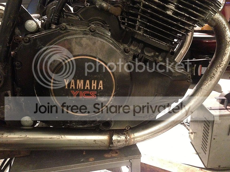

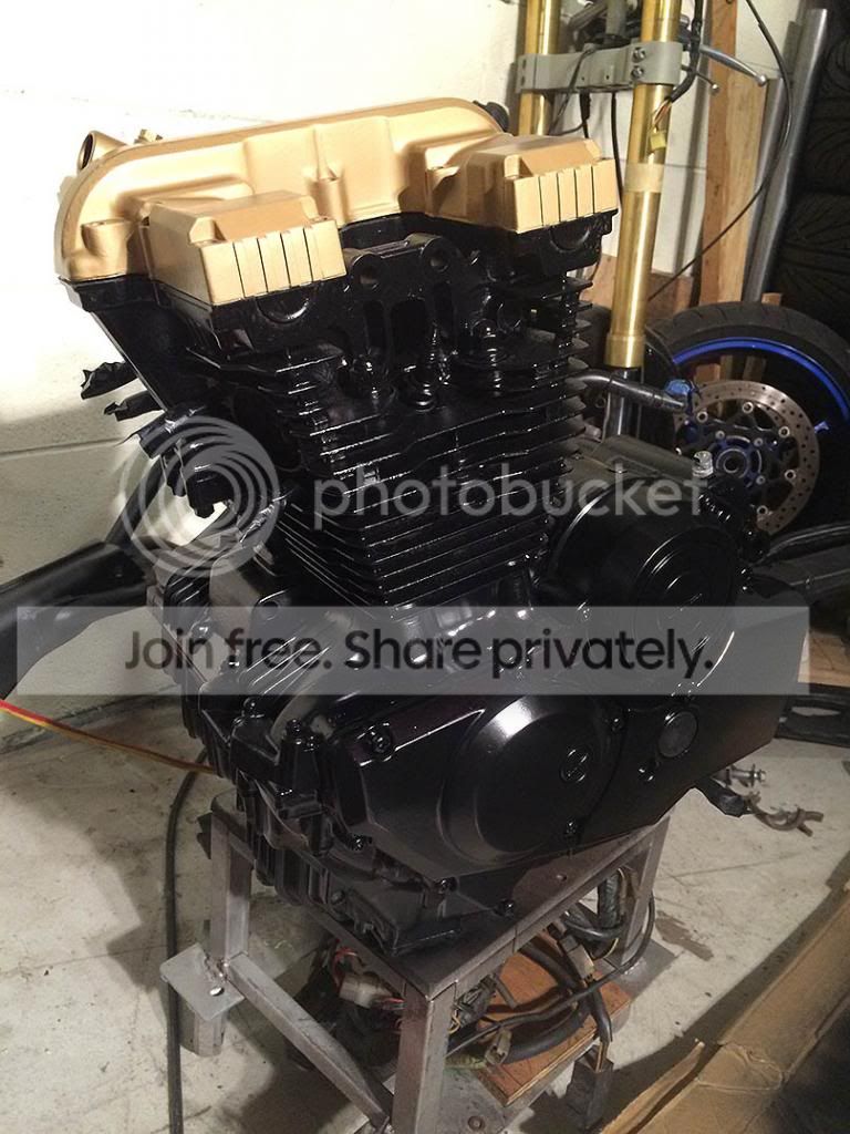

You might have noticed the engine looks a total piece of crap. Years in the weather and who knows what has meant it's corroded and nasty.
I started with a full high pressure degrease and then wire wheeling as much as possible, including inside the fins. The goal is a satin black finish -I toyed with the idea of then sanding off for silver fins like so many do but have decided against it. As part of engine preparation, and because this thing is becoming pretty much it's own entity, the Yamaha badging needed to go, so some metal filler and prep and the logos are gone!
Carbs of course needed a big clean up - both inside and out. Actually inside was OK, not too much junk, so I'm more confident this thing will run when I'm ready. This model XS uses different main size jets in each carb due to some vagary of the airbox, so new jets are on the way in a few different sizes too.
You don't see too many black carbs but I'm liking the look. The gold tops will actually go - I have a different finish in mind already.
You will note some of the gold bolts on the carbs - I'm using a lot of gold titanium on this build :-)

I think I missed this key pic which should have been further up - the key and challenge to getting the late model swingarm to work was not just width, linkage, and geometry, but chainline, particularly with a 180 tire.

Anyway in less important stuff here's a shot of the engine freshly cleaned up and painted, although again the gold rocker cover will change in future..

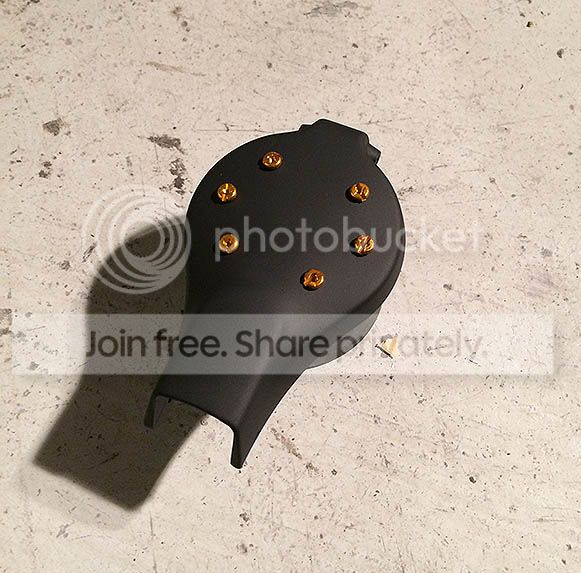

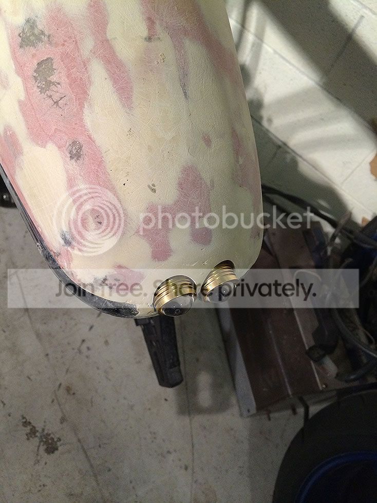

Here's a quick example of some detail stuff I tend to waste too much time on! The fuel cap is another item like the triple trees that I really want to look right as I'll be staring at it a lot! Rather than switch out the factory cap (which would have needed me to weld in a new bung I think?) I spent some time on the stock chrome piece. First strip the chrome and prime, and drill some even holes for detail. I also fitted a new rubber seal to the mechanism.
And then a coat of flat black PPG and the holes are filled with gold ano spoke nipples I had laying around from a bicycle project.
I think it came out neat :-)

The engine has come in for some detailing and is wearing it's final colour coat. High temp satin black with a coffee brown satin urethane cam cover. Gives some idea as to the final colour scheme of the bike too. carbs have also been sorted and finally assembled.
The engine has also been fitted with a lot of gold titanium bolts, both for appearance, anti corrosion, and sort of fits with the lightweight theme to this build.

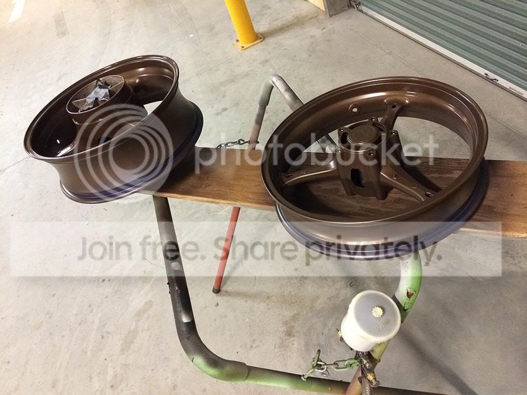

The wheels are also now flat coffee brown. Urethane base coat followed by DNA paints flat clear. This shot was taken right after shooting the clear, which is why it looks glossy. It dries flat.
