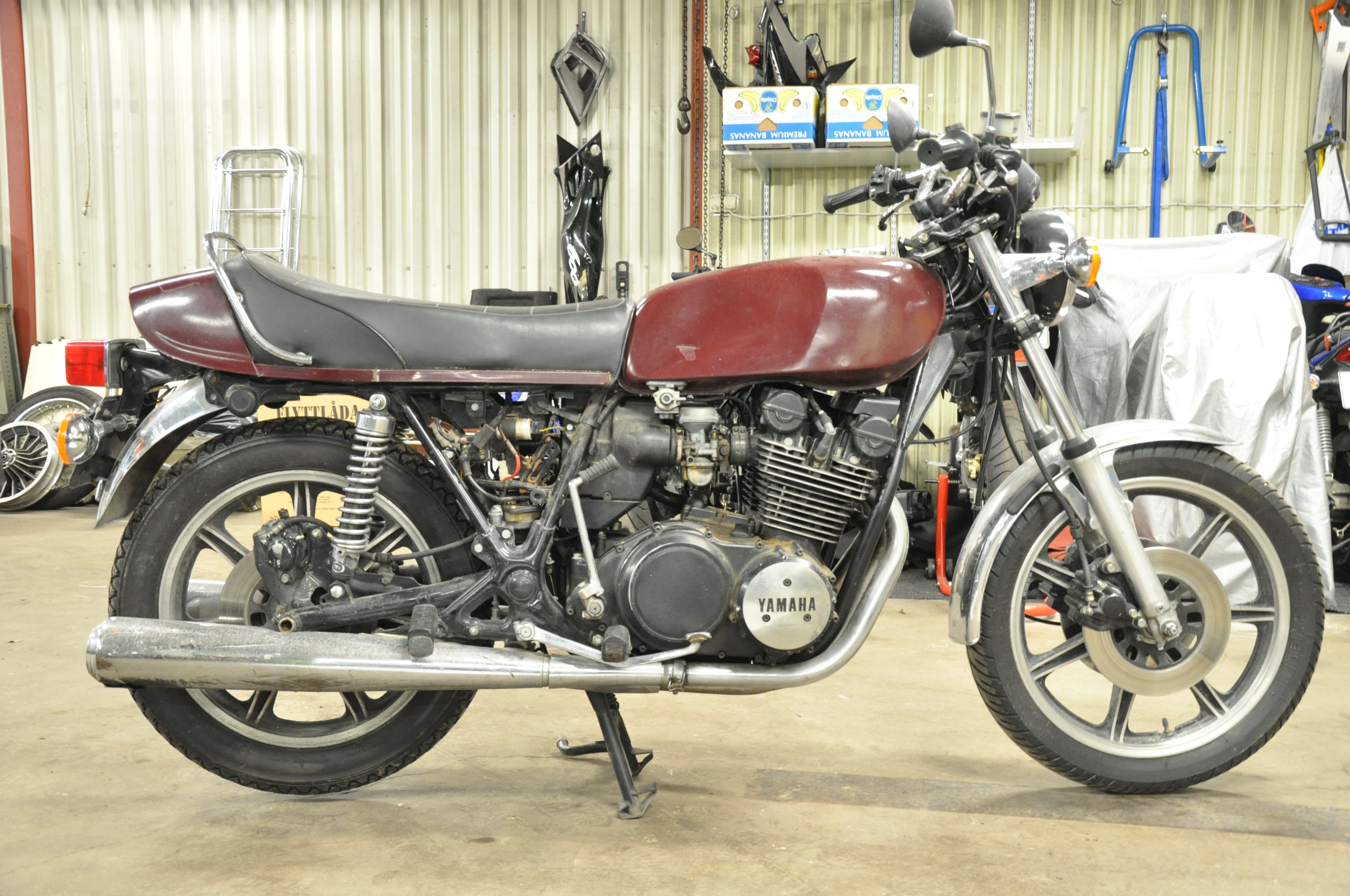

Been surfing around on this forum for a couple of weeks and really like it so I decided to make a build thread here as well. When I took my racing license bought an rr-bike and started Roadracing I decided not to ride bike on the streets at all. But then after a few months I changed my mind. I bought myself an old Yamaha XS7502D-77 with 33000km on the ODO for 270$ in April.
Here is the starting object.

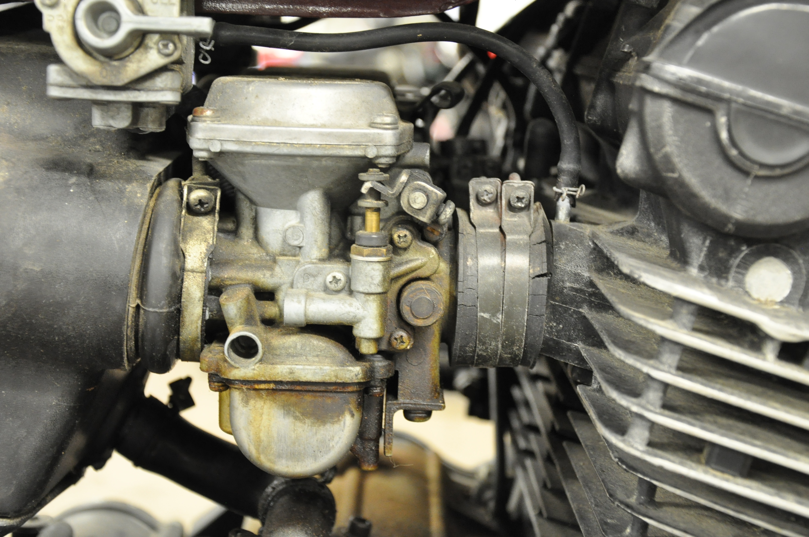

Then when I got better I started with cleaning the carbs and ordered new inlet rubbers.

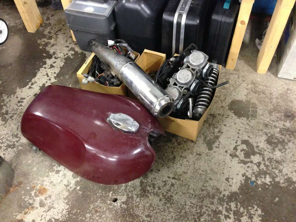

I did become a member at the Swedish Triples forum and got a phonecall immediatly, there was a man who was interested in buying or swapping my 3-2 original exhaust and headers. We swapped and I got 3-1 Motad exhaust. Much nicer look and I can change muffler or build whatever I want on those headers.
attachment.php
attachment.php
attachment.php

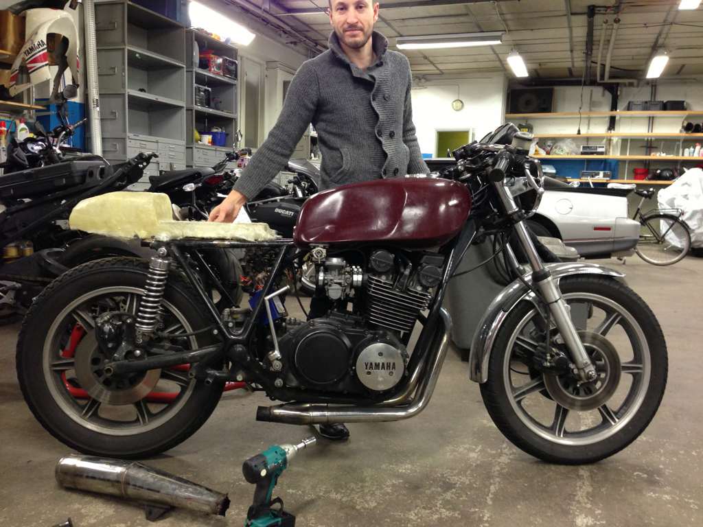

I made a battery box out of sheet metal by hand (without special tools, just a hammer, pliers and a vice), but I think I am making a regular seat pan and mount the battery under the seat instead after som DTT-surfing.
attachment.php
attachment.php
Then I started forming the cafe seat.. and this is where I am right now..

Did some fibreglass today, first time.. I think I let it to someone else in the future.. It going to take a lot of bondo to make it even look acceptable... Well you gotta try.
yeah seat building is not as easy as it looks. But you learn alot by trying things. Gonna get heavy if you use to much body filler. Maybe just paint it with a couple coats of resin and see if that smooths it out first.
