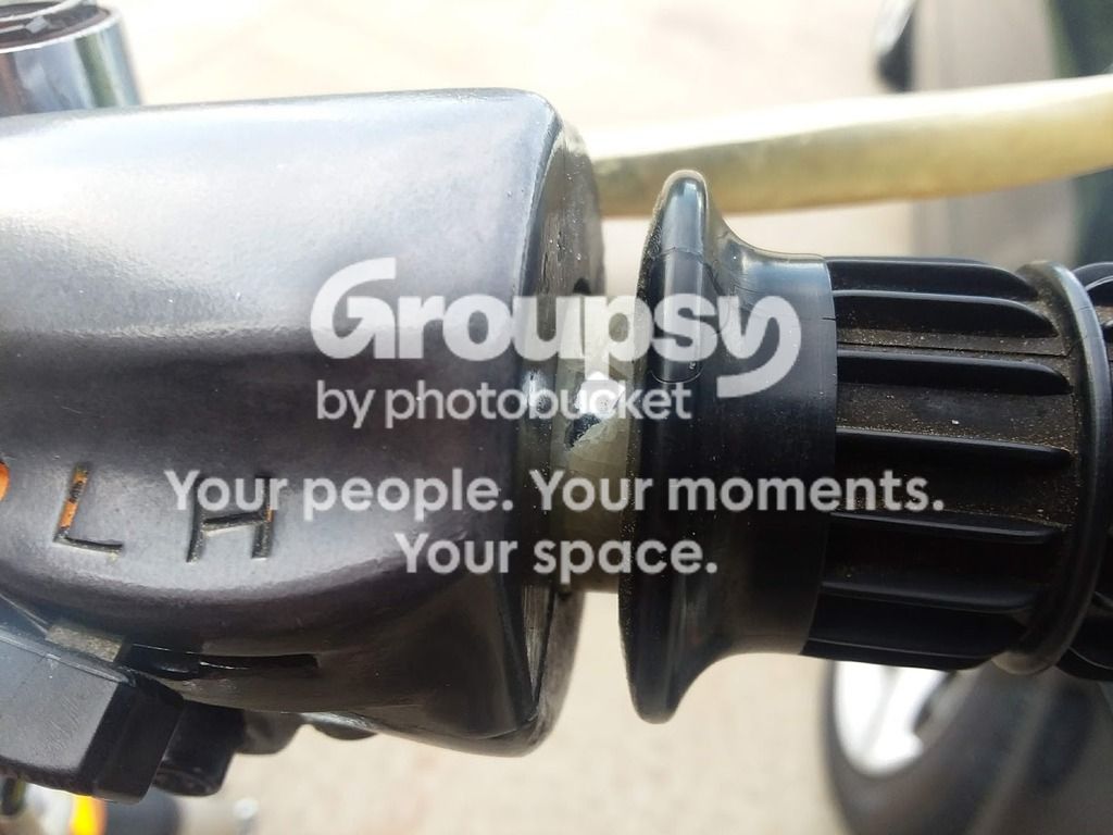

I did see a cracked throttle tube that I will replace. But...again...not sure it's the culprit.
