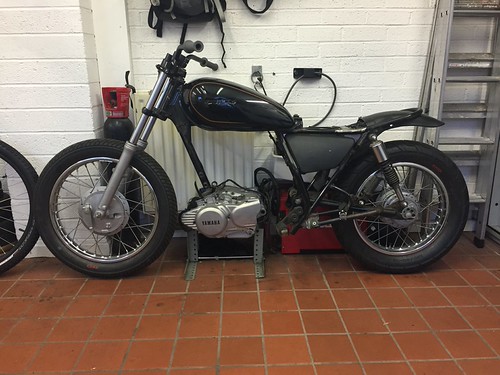

GN250 side panels, and tabs for the panels, fitted over Easter. Tank Lifted, front bobbins lowered & Battery box next on the list.
Please ignore the crap welding, it's just me tacking the stuff into place, off to a mates who will be doing a much better job.
Standard rear mudguard fitted but moved forward, and this allows for the plastic liner to still fit in front of it.

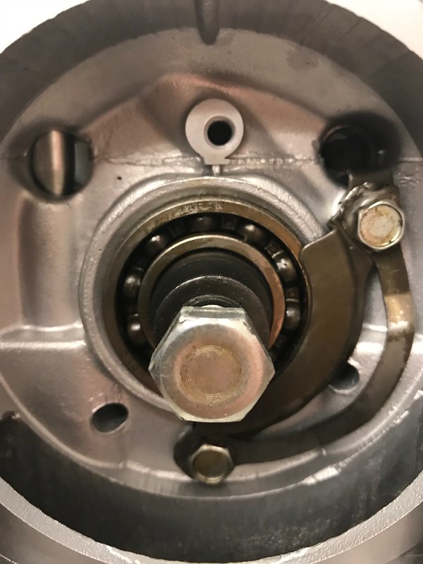

Firstly, the hole in the threaded head above the crank centreline, does anything go in it?
Untitled by eastham_david, on Flickr
and 2ndly I seem to have two bolts left over. The problem is I bagged a load of them up and sent them all for blasting and plating, silly mistake.
one looks like M4 and the other is M5, can anybody shed a light on where they go?
