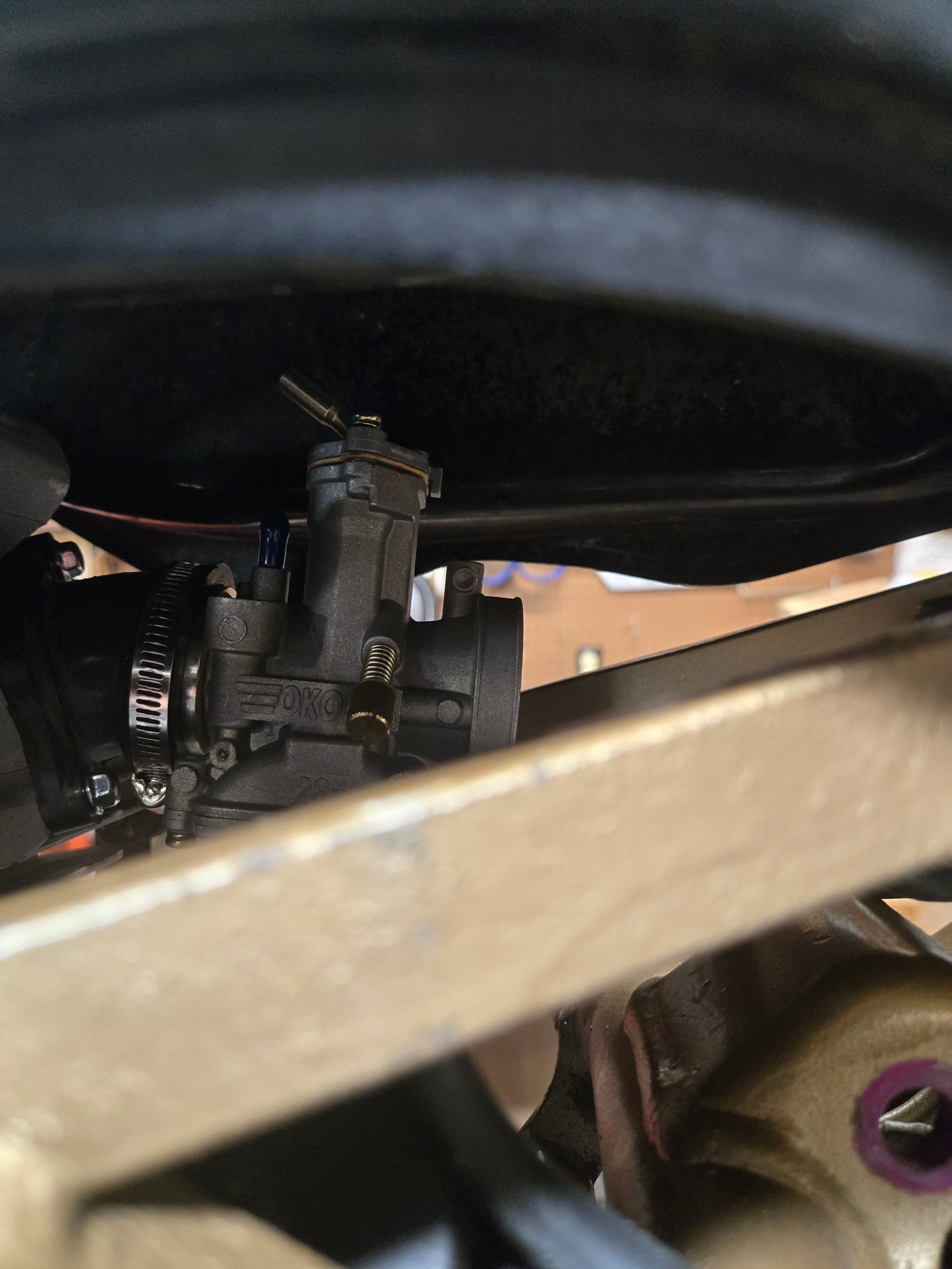

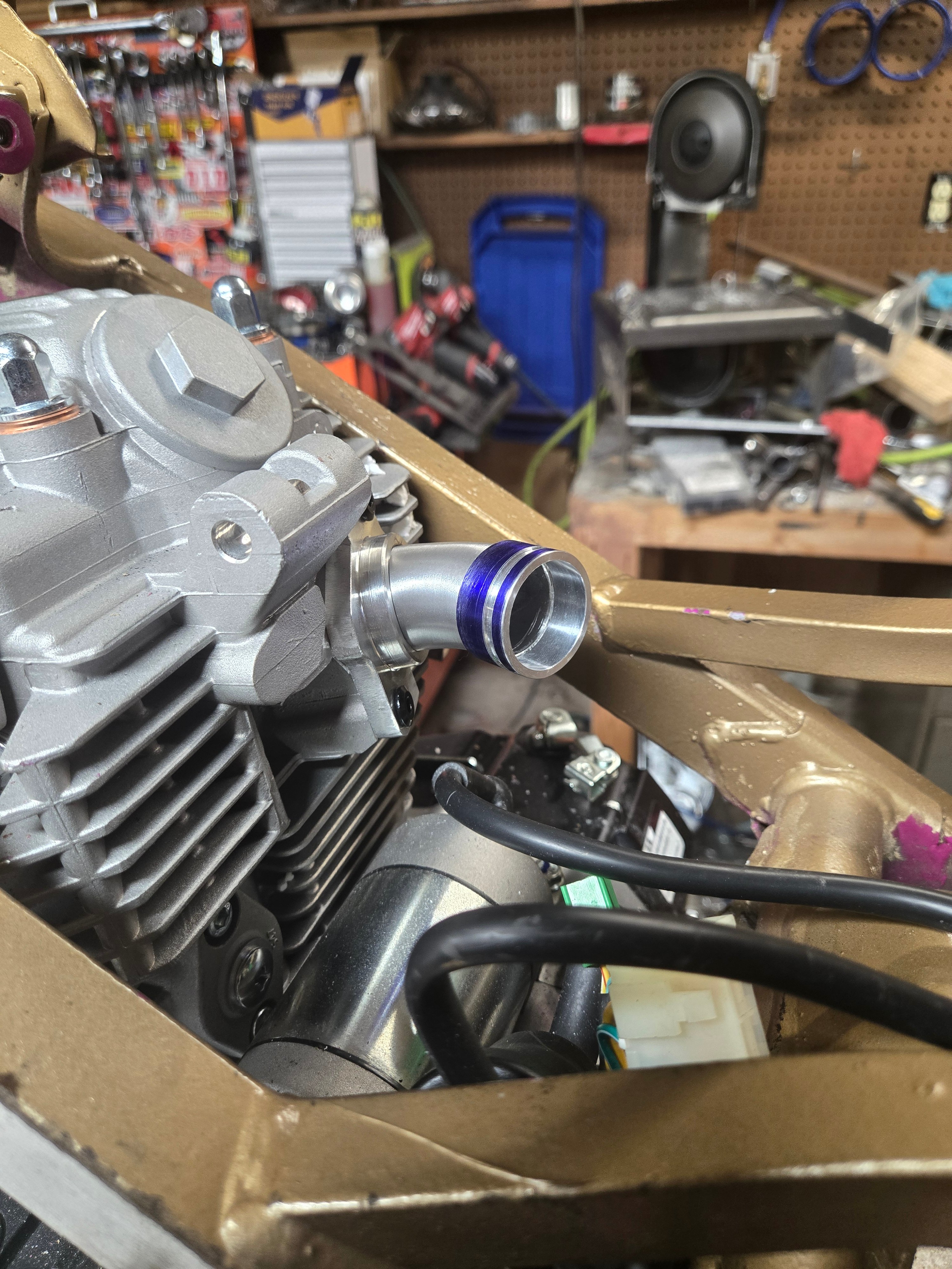

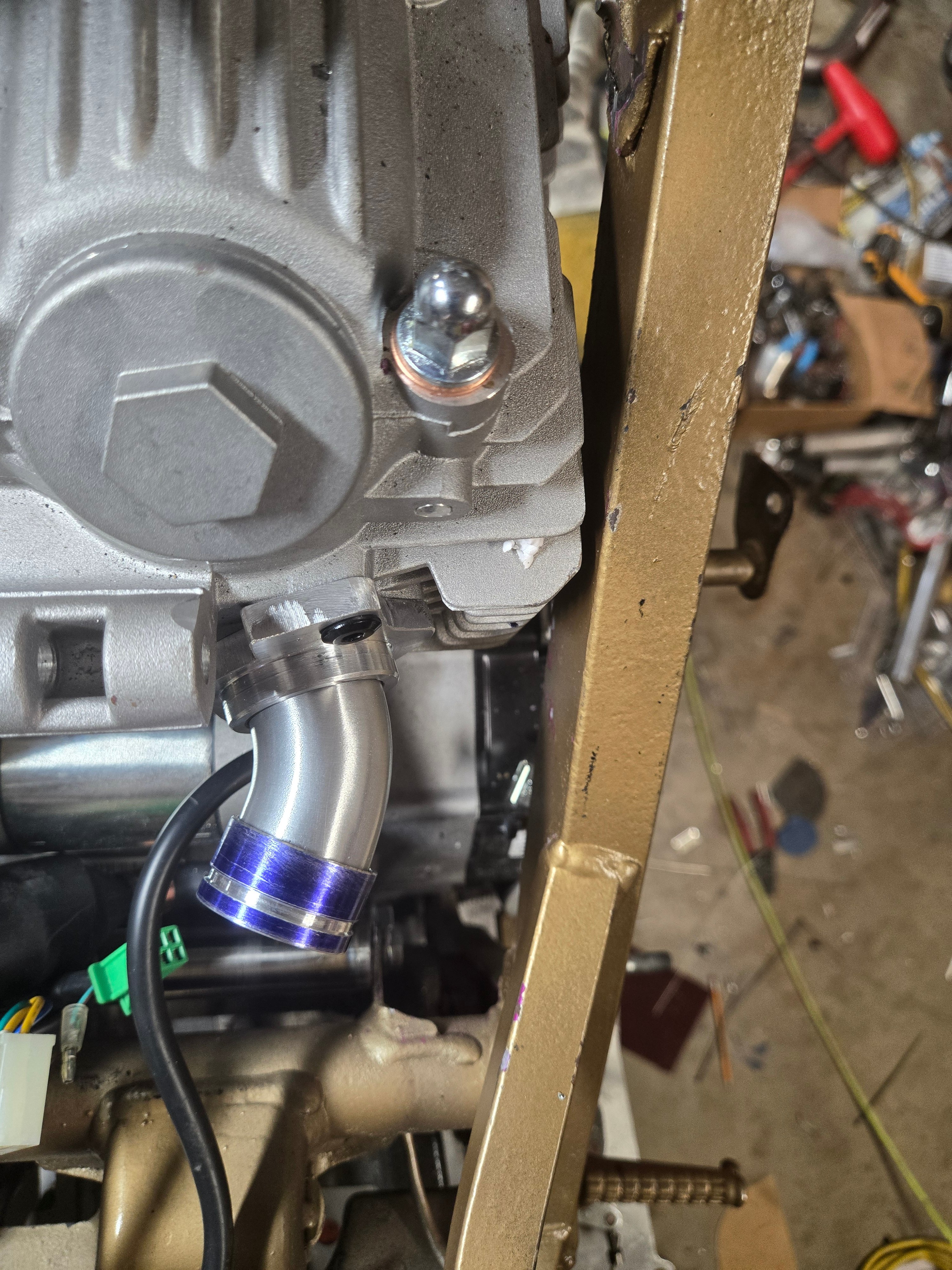

Stuck a PE30 carb from nibbi on. It seems to be the go to for these engines. New intake lets the carb sit level and leaves room for a filter.

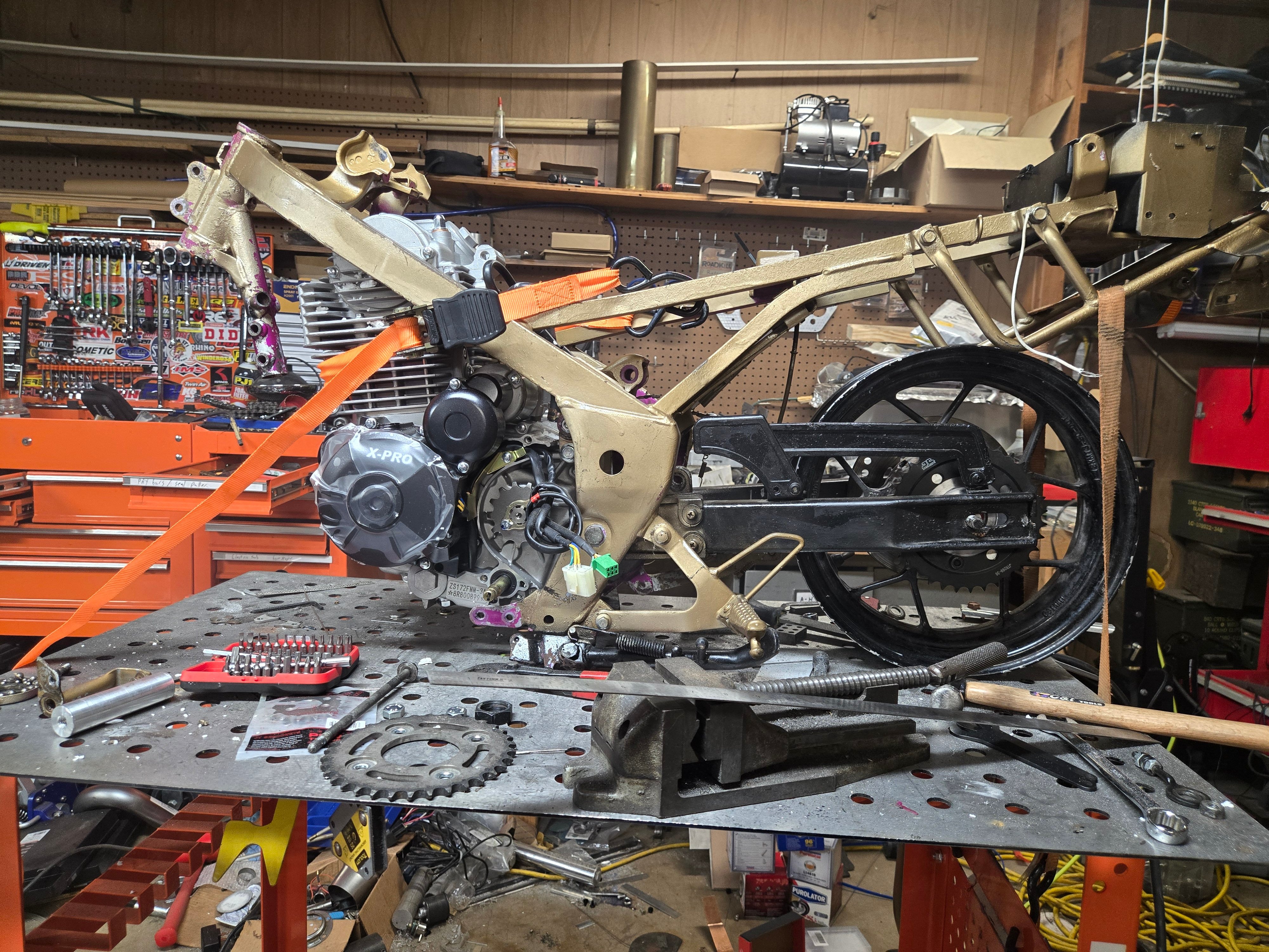

Lol, thanks. It should be fun. I'm planning on a 3 inch extension on the swingarm, it'll help make it a little more stable, the rear wheel will look better placed, and it'll help keep the front down. With roughly 4x the power it'll probably benefit from it.
That should help. We're pulling all the groms from our MSF fleets here because they are so unstable that accidents keep happening in exercises like cornering and emergency braking, a few inches of wheel base would make them way better.

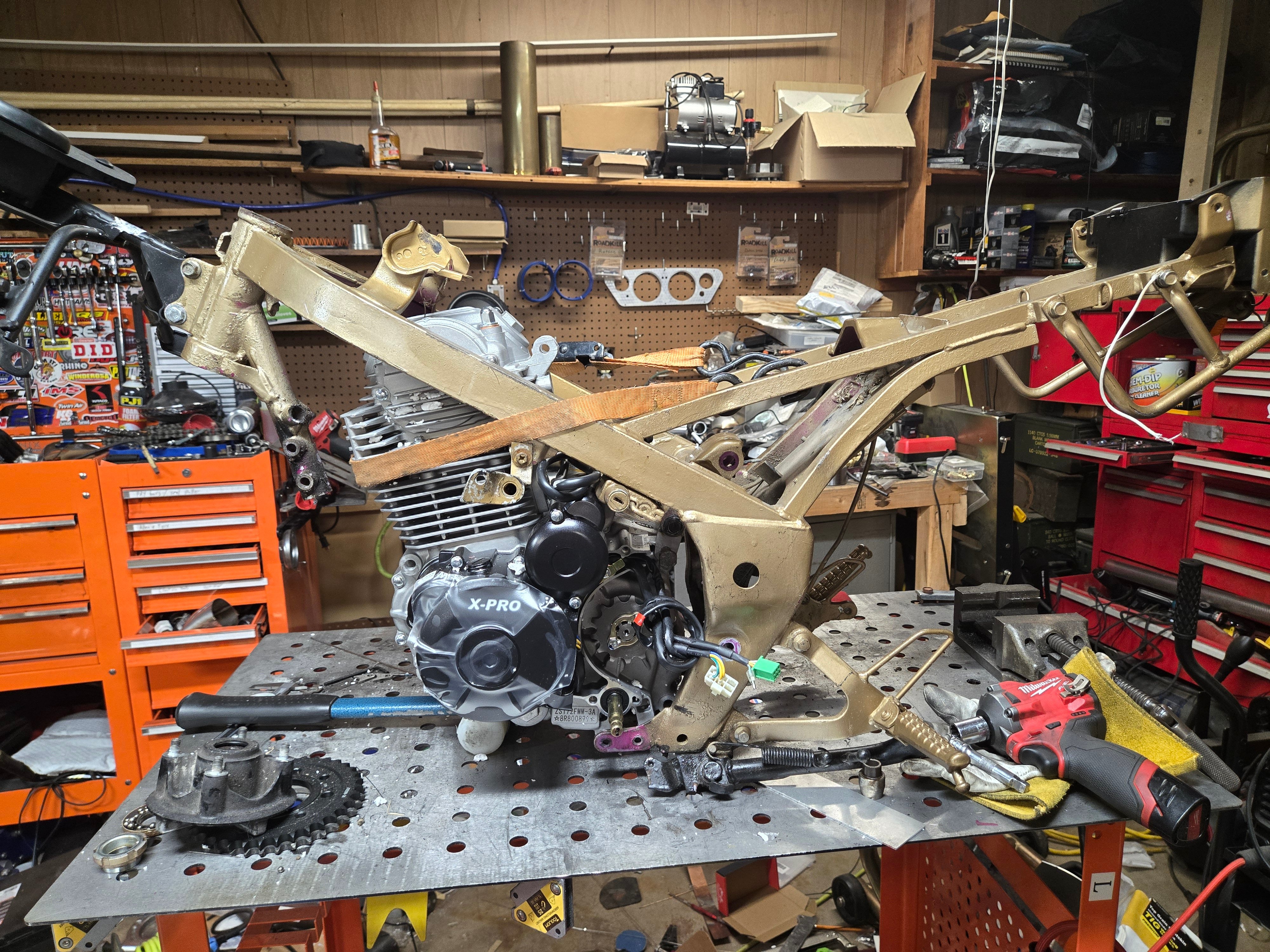

Slowly working on things. Replaced my tool cart with a 42" box, so the cart is being turned into a welding cart. Made a fork disassembly tool for the grom forks. And finally making the permanent caliper bracket.

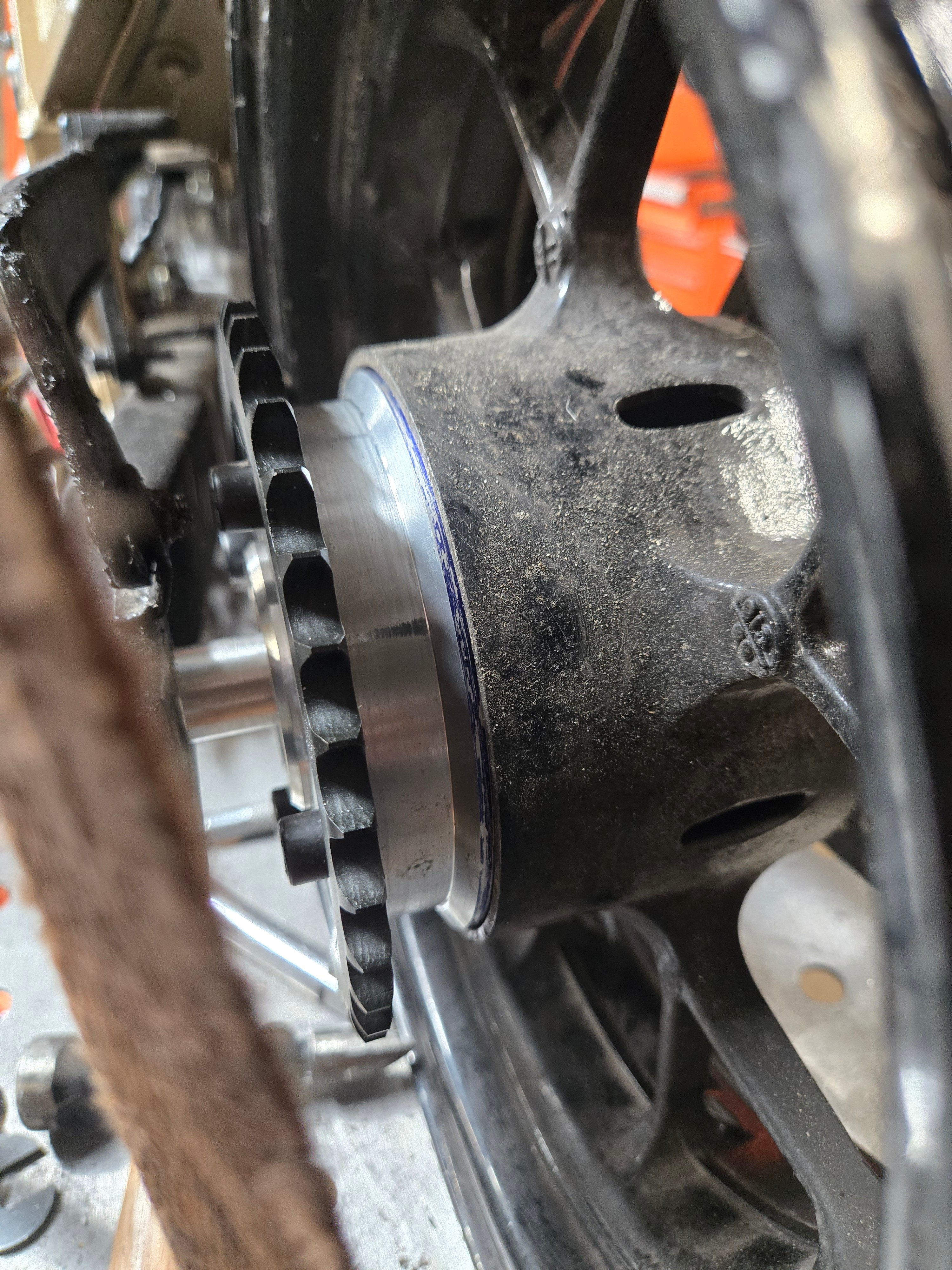

Caliper adapter is done. Picked up the wheels from powder today. I'll mount tires and double check chain clearance before finishing frame fabrication. Then the frame will go for power, it'll be silver.
