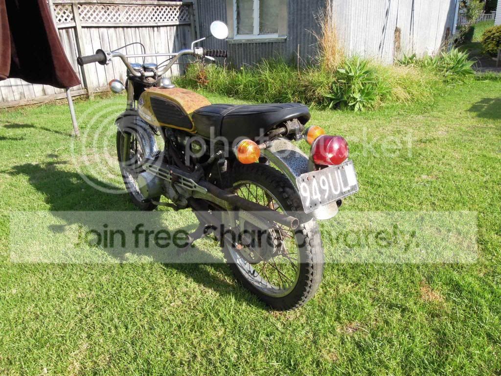

Picked up this on the weekend. An early 70's Suzuki T125 Stinger. It was a $150 bike so I wasn't expecting much, but underneath the heavy patina appears to be a very original and complete bike. Don't know what the plan is yet, as it was just an impulsive purchase. It will need the top end done at the very least to get going.

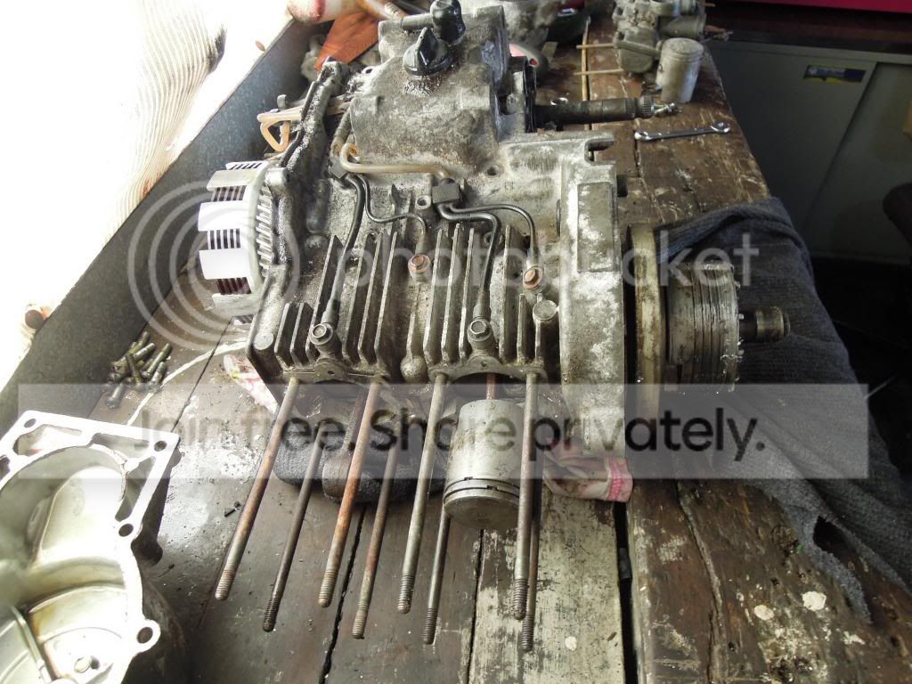

Engine pulled:

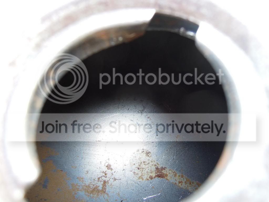

The right side bore. If only the sparkplus were left in before it sat, I'd say this thing would have fired up.
VonYinzer said:
Oh man. Those jugs are rough... Looks like a great start to a restoration though.
Should be easy enough to do the top end, however there's a bit more to it as I just found out.

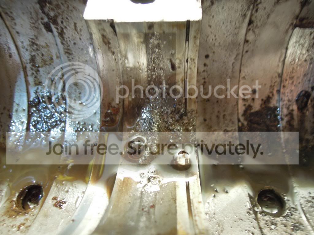

Split the cases and...
...looks like catastrophic main bearing failure on two bearings.
Bearing cages are gone!
The centre bearing:
Metal filings:

There is some wear where the left side bearing sits. I don't think this was caused by the failure, but rather was the cause of the failure. You can see in the pic a slight edge has developed behind the locating dowel. This gives a bit of play to the outer race. I'm thinking I can just shim it, though it may need machining first.
