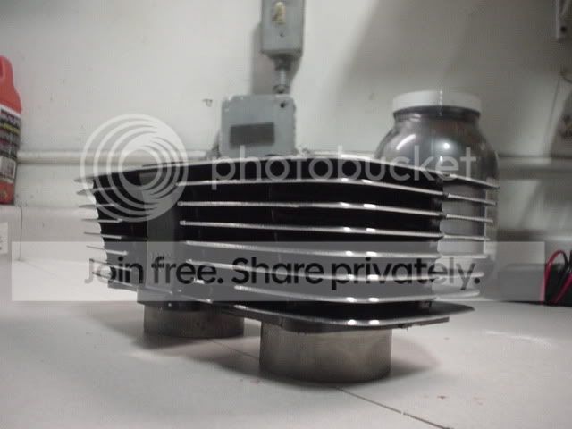

Just finished powder coating some of the engine cases! Should have the engine back together sometime next week along with the wheels.

you bastard, stole my idea for the cylinders!!!!!!
gah, i knew i should never post my intentions online. at least i know it will look good.
is it high temp powder or something? polished the edges and then powdered or vice versa?
Haha.. Actually I own a powder coating shop and I have been doing this for many years. It does look awesome. I powder coat the part then polish the edges, makes a nice clean edge. Its standard powder, which is good up to ~450+ degrees. If the cylinders get any hotter than that I have other problems.
Re: CB200T Cafe Build
sounds good. hand polished or wheel? i would think that the wheel would put dull spots into the powder near the edges that your polishing.
how much would you charge for that? im looking to get it done but want to see what cost im looking at.
....For a the 200 you are looking at around $100.00 for the cylinder(s). Its quite a lot of work, blasting, masking, powder, bake, then polish. Its so worth it though. Just getting ready to do the same to the head, should look great! Will post pictures when im done.

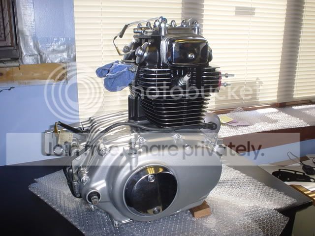

Well I just got my engine back together after giving it a nice powder coat and polish treatment. The engine didn't even have 3500 miles on it and looked brand new inside but it was pretty dirty and very stock looking on the outside.
Here is the before shot:
And after shots:
