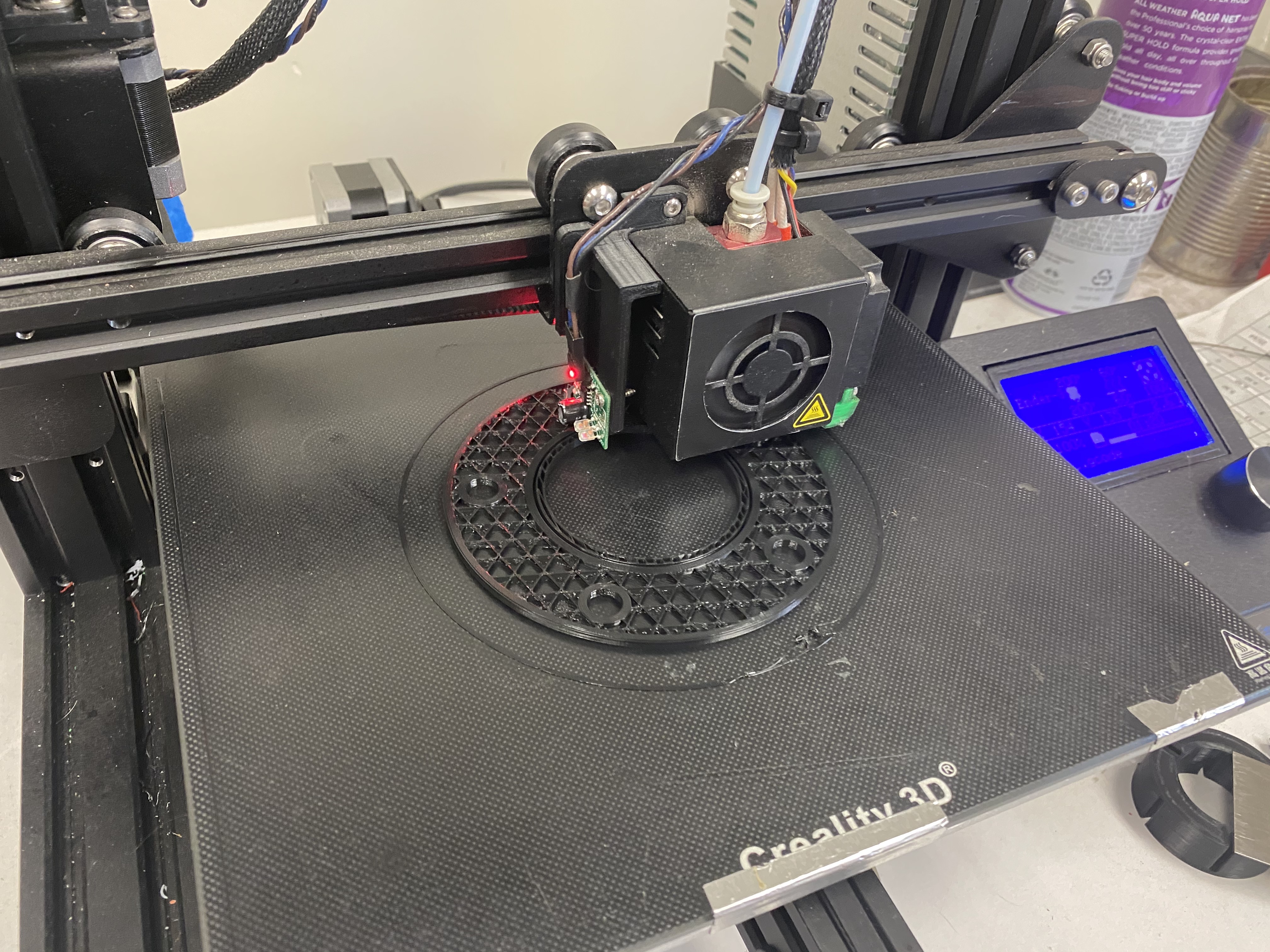

Prototyping a sprocket spacer on the 3D printer. I got the spacers made up for the brake side of the the rear wheel. Left side is gonna be tricky. There’s very little clearance between this 130 rear tire and the frame. Getting this sprocket and a 130 chain to work and clear the tire is gonna be a close call if it works out. There’s a chance I’m going to have to switch to a narrower tire.

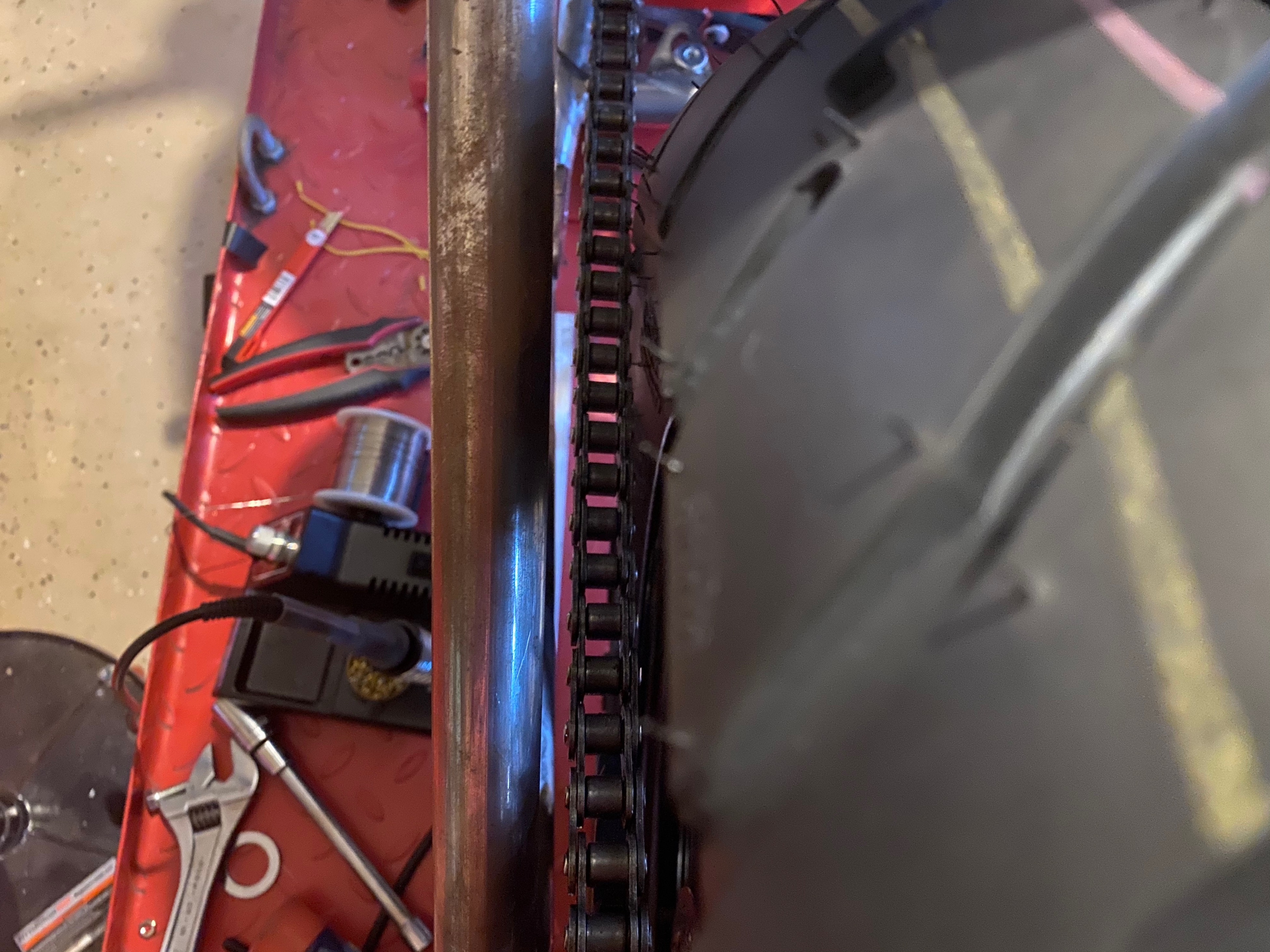

This is all the clearance I have to work with. I’m very close to lining up the sprockets with a 1/4” spacer on the sprocket but I’m not clearing the tire. I’ve got another 12mm thick spacer printing now. Which is about another 5mm. Will see how that goes. Definitely not gonna get an off the shelf spacer. Will have to have one made.
Brake side is looking good though.

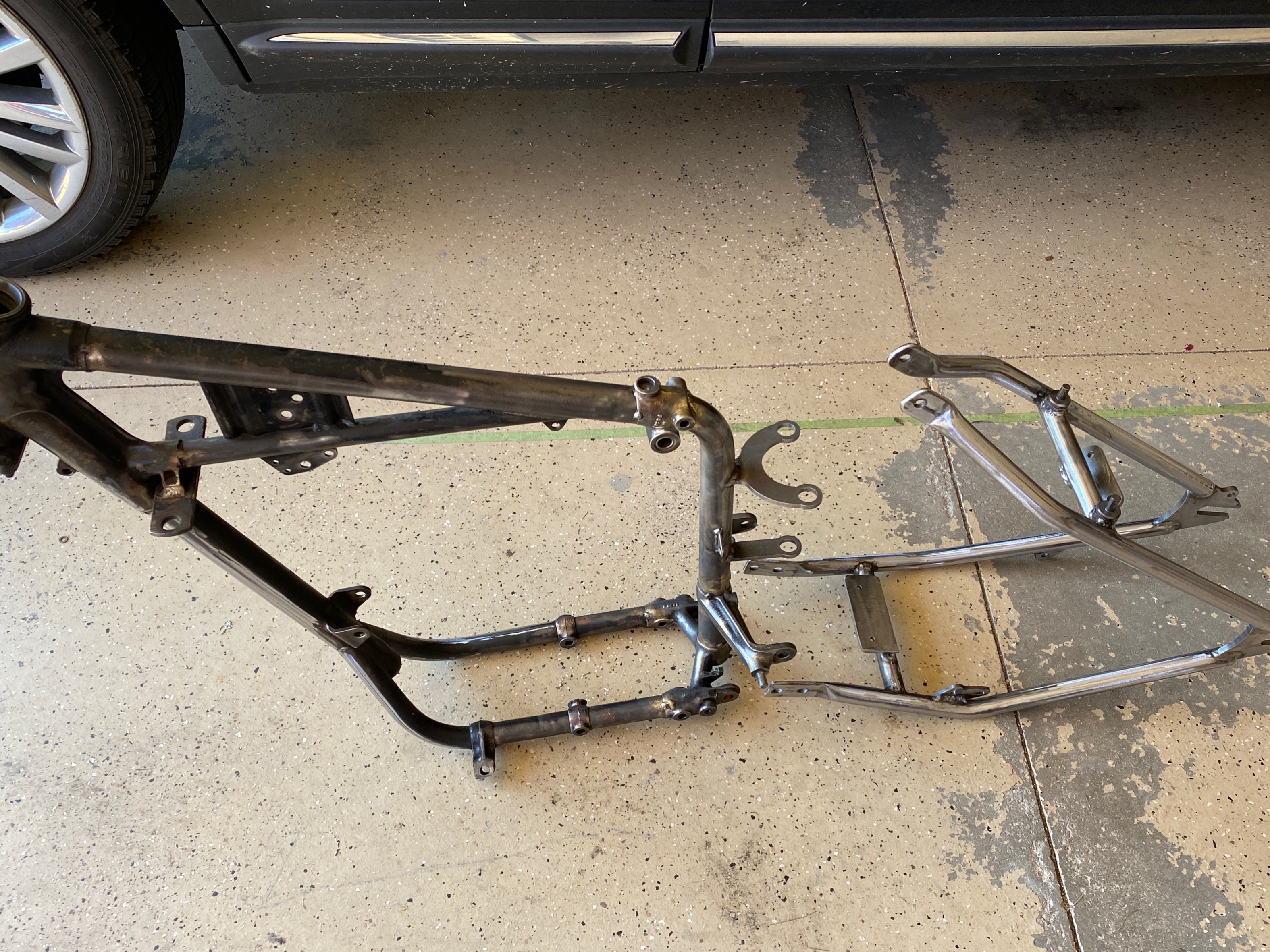

Got the rear sprocket and spacer shit worked out. Chain clearance is tight but it is clear and the wheel is centered. The brake caliper doesn’t bind. Now, between last night and today, I went ahead and tacked up the rear fender mounting bungs and made up the struts. I’ll finish welding them up tomorrow morning. That should wrap up all the welding I need to do on the frame. I still need to weld up front fender struts. I need to put in an order at McMaster Carr this weekend for some fasteners and spacers to
Make that work.

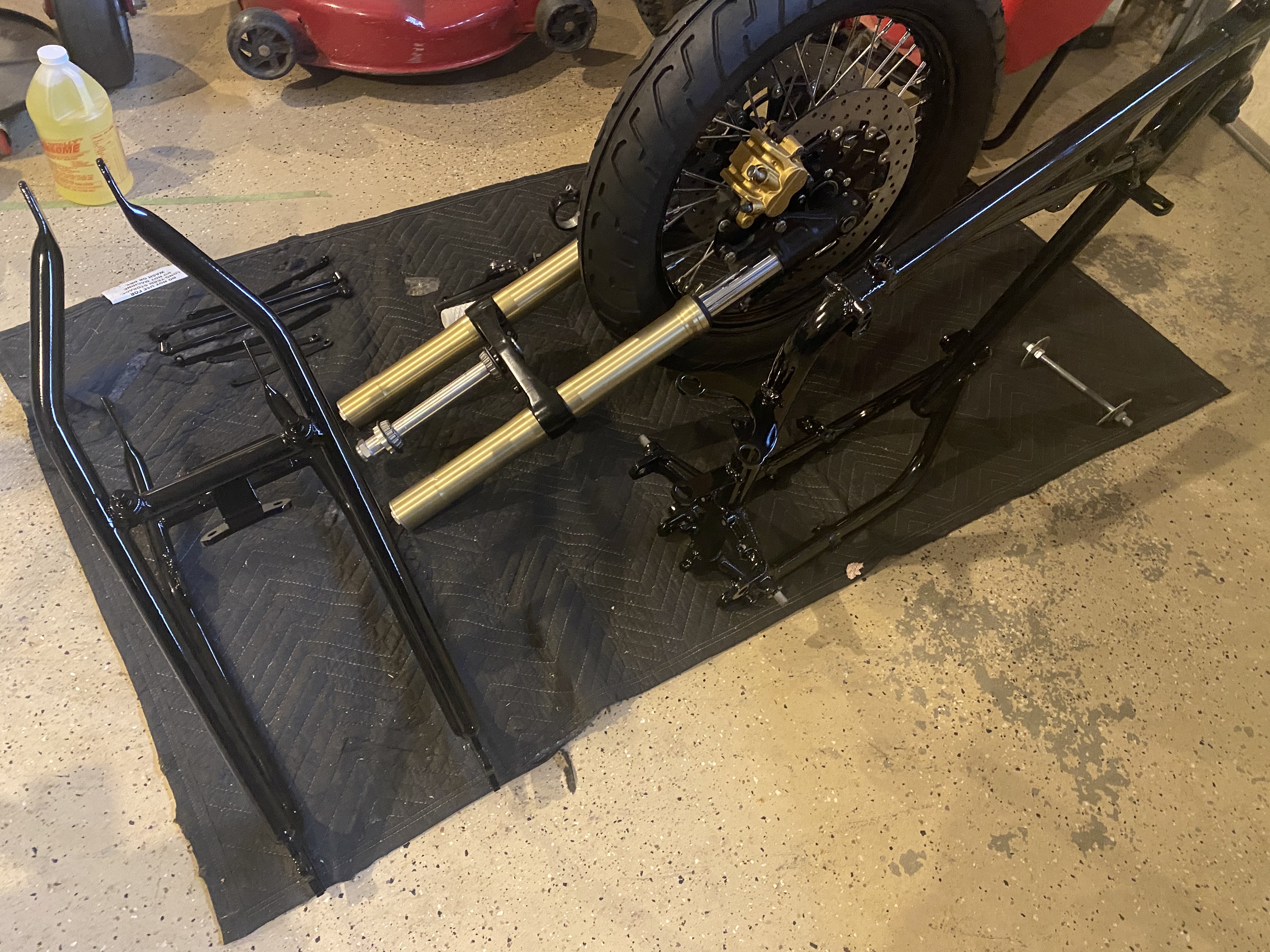

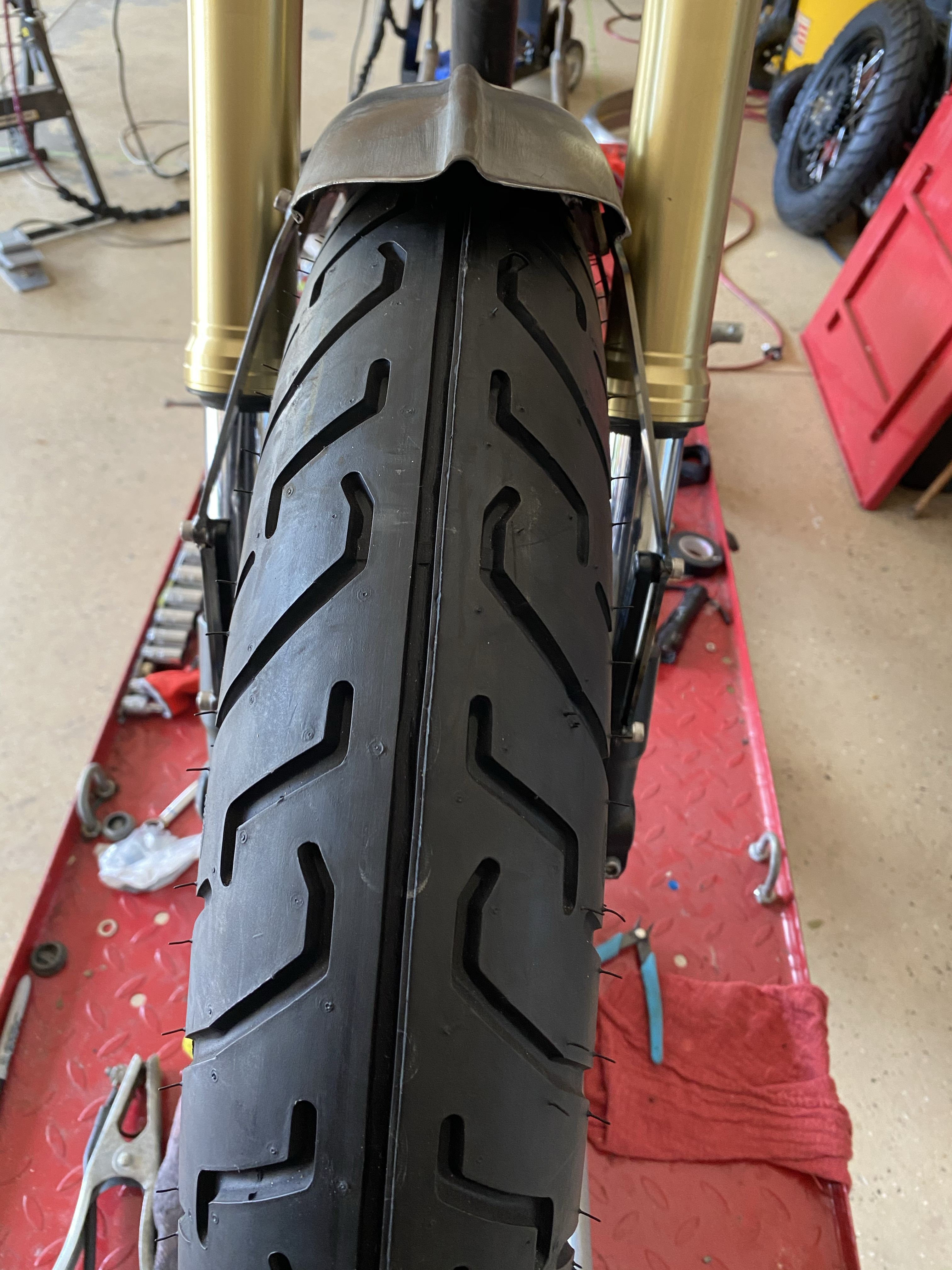

And today I managed to get my front fender struts fabricated. Pure pain In the ass. They’ll look good powder coated when it’s all done.
I finished up my welds broke the bike back down and dropped my frame off for powder coating today... I should have it back by the weekend. I’ll powder up my fender struts and get the shop cleaned up so that I can move onto painting in the very near future.

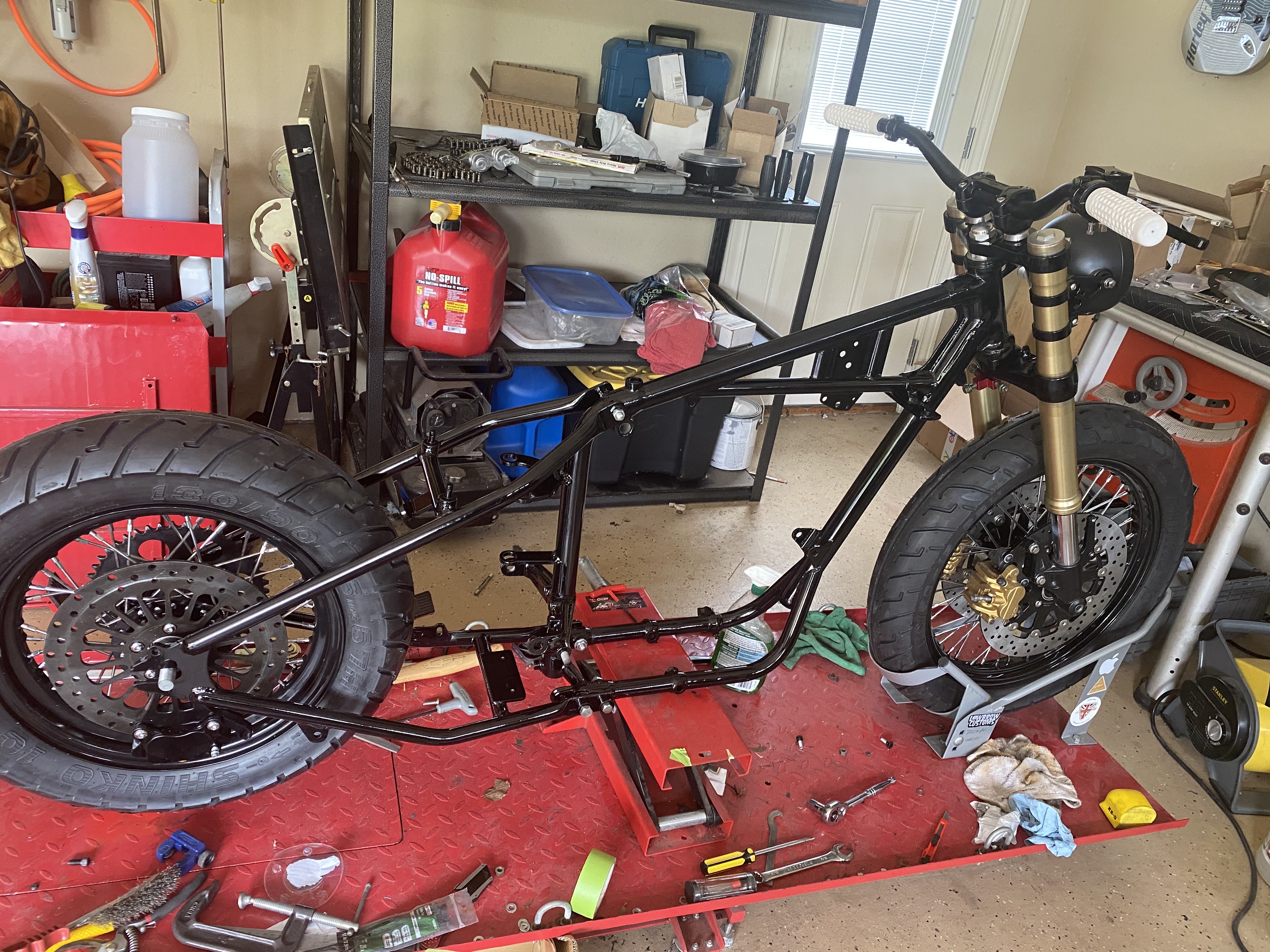

I managed to get the frame assembled and mates back to the front end. I made a few spacers and powder coated them to make up for the thickness differences between a stock rear frame and the hard tail at the bottom mounting points. Gotta use stock fasteners as these are CEI threaded. I also mounted the headlight and ears on the forks while reassembling. Headlight bucket might end up getting painted to match the rims or just gloss black.

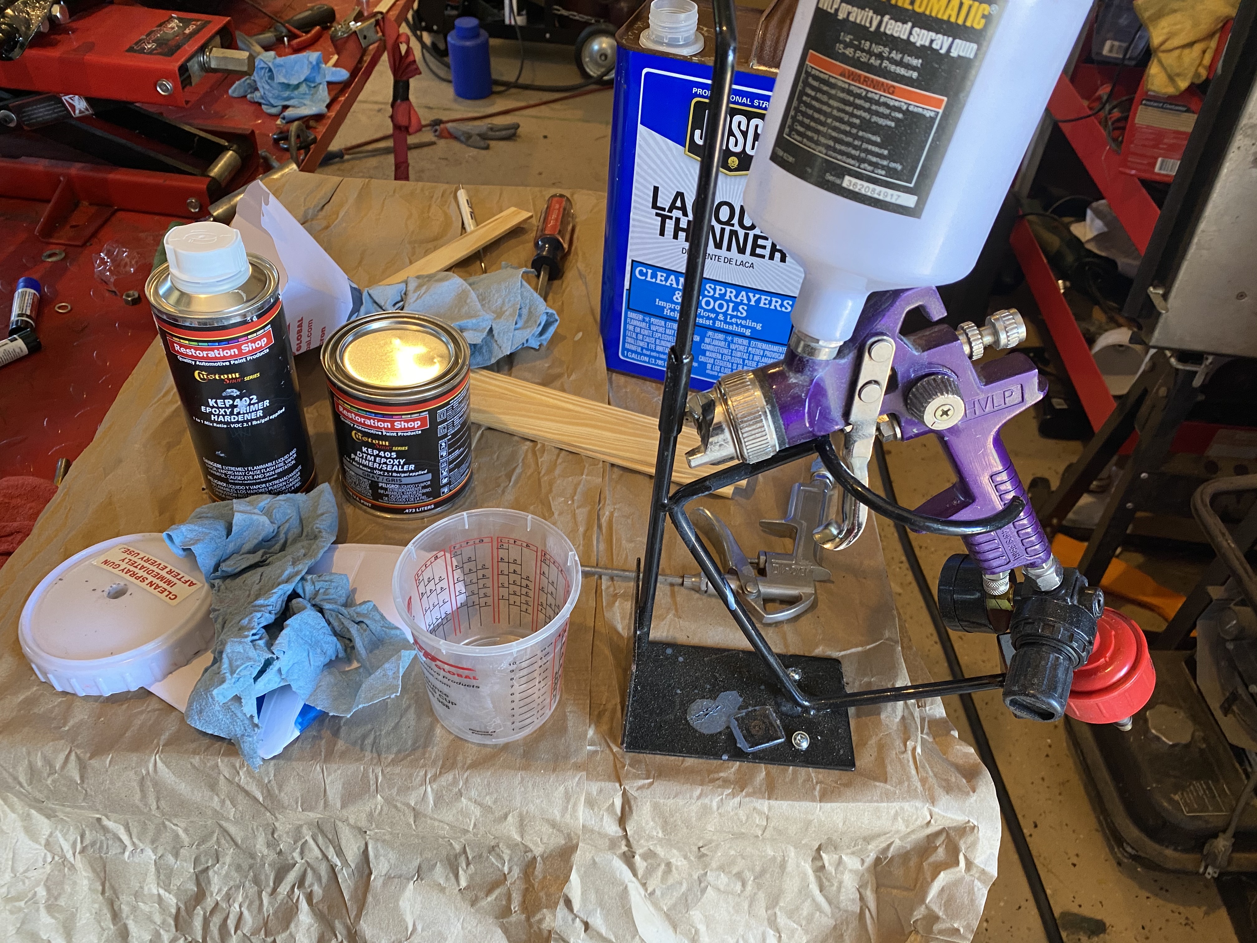

I managed to get the tins primed in epoxy primer, block sanded and primed again yesterday. Will work toward getting prepared to do a sealer coat and lay down some actual paint later this week. I need to order a set of carbs and my exhaust so that they will be here about the time to really start assembling this thing.
Love the cheap HF guns for this type of work.
