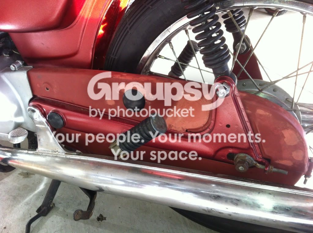

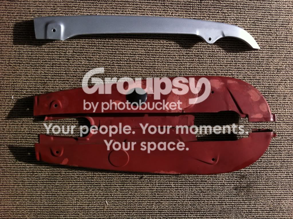

As promised, some before and after pics of the chain guard:
Thanks for the comments on the new guard guys.

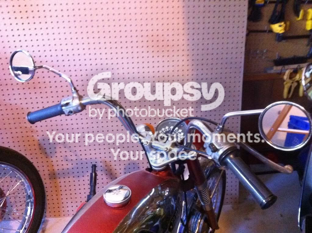

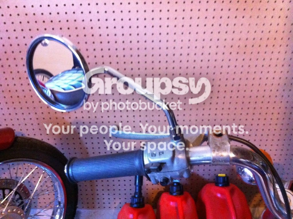

Well, a small box arrived from China in the mail today. Like a kid at Christmas, I could hardly wait to see if it was my carb filters. Nope, it was the mirrors. Well $hit, guess I'll have to wait a little more to get that motor dialed in. At any rate, I put the new mirrors on (even though I'll be changing the bars when they arrive) to see how they looked. Actually, I was pretty happy with them. Much nicer looking than the big stock ugly one, and the quality was much better than I was expecting (especially for the low price)
Some pics...
Original and new:
And the new ones:
Ha! "Quadropheinia scooter". Those mirrors add a bit more style to watching the coyote disappear into the distance behind you.

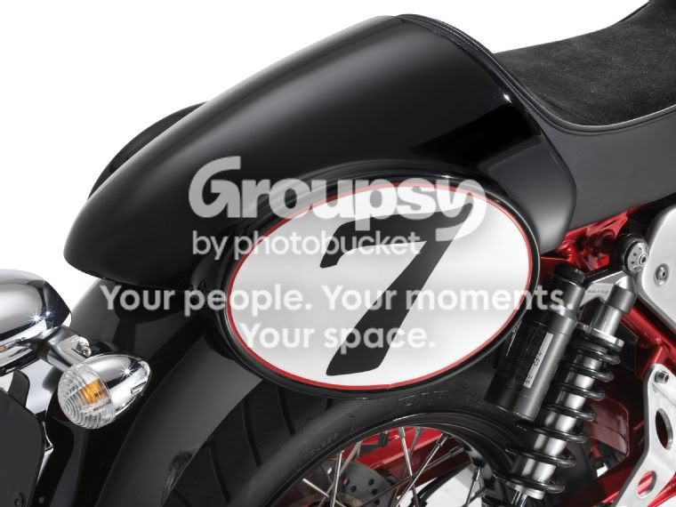

Some inspiration for the front end...
And some inspiration for the rear end...
OK, and again without the distractions...
Actually I kind of like the look, and it should not be too hard to replicate the seat/fairing (not the girls). If I could replicate the girls I would not be wasting my time fixing up this old YL1 LOL
It was like Christmas here today - the bars and air filters arrived. I'll take some pics and post later. Not sure if the filters will work - its gonna be a real tight fit so you never know.
BTW - no comments on the pretty girls? I'm dissapointed in all you guys. Not even any ladies piped in to call me a sexist pig or anything. ;D I went to far lengths to get those photos. Do you think the V7 fairing is a good idea or not?

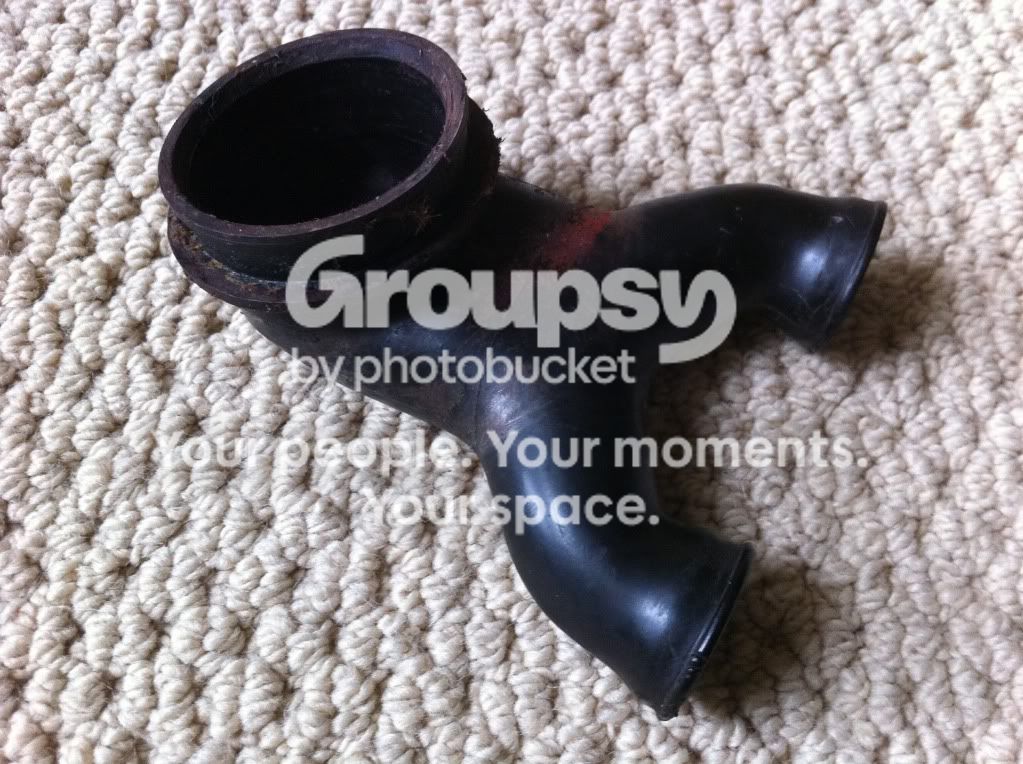

First off I removed the old rubber air intake Y-manifold. Well its supposed to be rubber but has turned into a hard plastic. Which is why I cant get it to seal on the carbs
With it out of the way, I test fit the air filter assemblies I got from China. Just not gonna fit - clearance issues with the frame, not by much, just enough to make them not useable. Into my ever expanding spare parts bin they go.

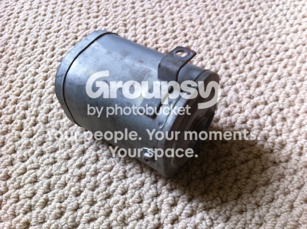

Back to plan B, use the NOS Y-manifold. But the stock air cleaner has some issues. First of all, the replacement filters are obsolete, and the canister that holds it looks pretty restrictive.
So I'm thinking a plan C. Use the new Y-manifold and try to adapt a less restrictive air filter. Better for performance, easier to get replacements. Since the manifold has a 50mm opening, I'll start searching. Its got me thinking...some sort of ram air intake in the side cover might be possible, especially if I make a fiberglass duplicate of the existing cover.

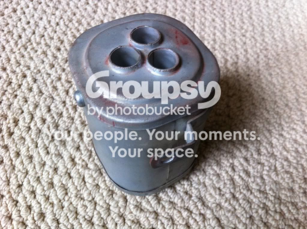

eBay is coming in pretty handy, except every time I buys something it takes 1 - 2 weeks to get stuff. At any rate, I did some measuring last night of the compartment that holds the battery and air filter canister, and found this:
Looks like it will fit inside the space previously occupied by the old canister. While I'm waiting for it to arrive, I'll need to fabricate some adapter to mount this and the Y-manifold together, and to secure it in place. This should solve the air filter issue, and help to solve the restriction of the stock canister. Speaking of restriction, I am going to have to do something with the side cover to allow some fresh air in there. The stock configuration has the engine trying to suck air out of a closed compartment. The only place air can get in is in a little bit of space around the Y-manifolds entry point into the frame, right behind the motor. Like breathing hot air through a straw. If I can find a side cover on ebay I'll just modify it; otherwise I will make a fiberglass copy of the existing one. Sort of like what Plymouth did back in the day with their "Coyote Duster" air cleaner...

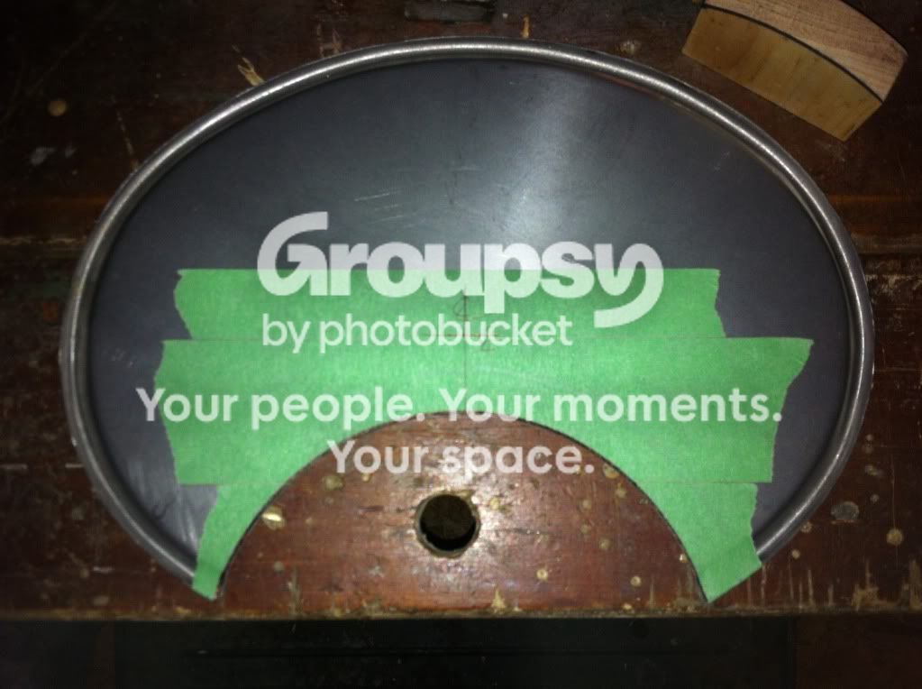

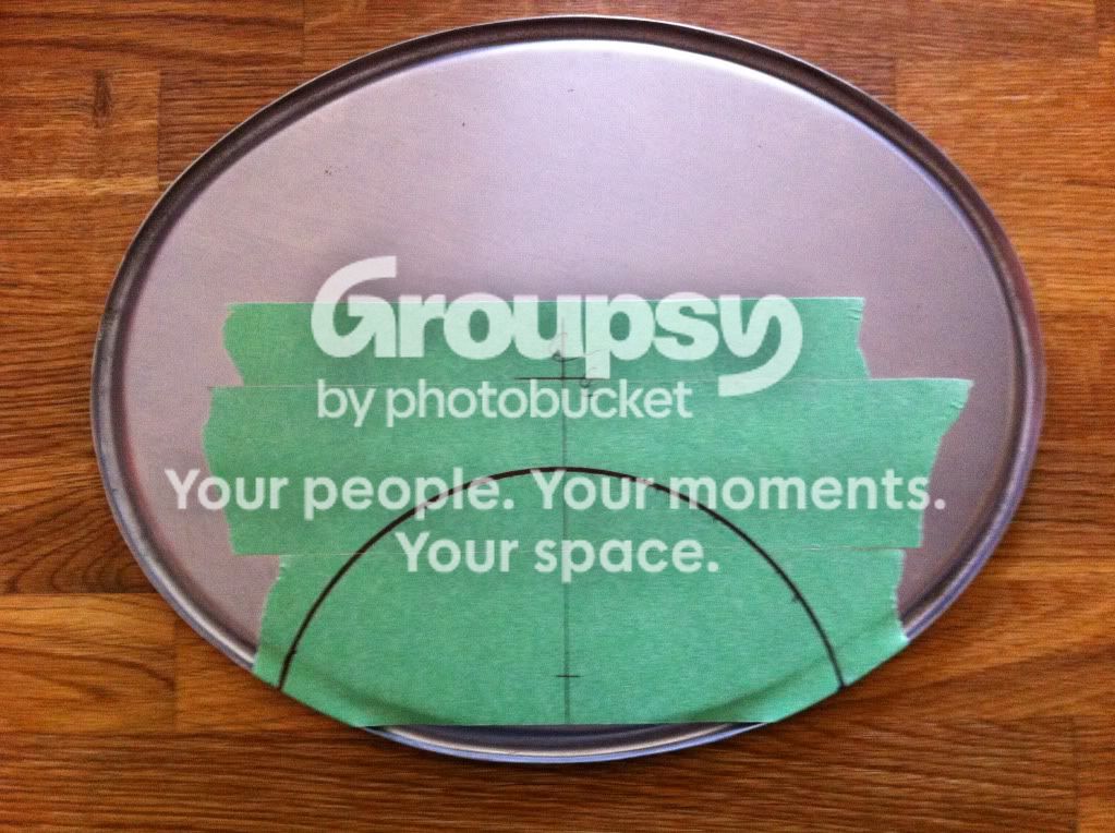

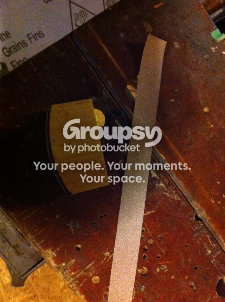

I've been really busy lately and haven't had much time to work on this, but my steel number plate arrived late last week and I transferred my pattern and cut it out this afternoon. I actually ordered 2 figuring it might take a couple attempts to get it right, but as it turned out the first go was a complete success and I'm happy with the way it looks. I did the headlight cutout with a jigsaw and a fine metal blade. I made a sanding block out of wood the correct circumference and used varying grades of sandpaper to finish it. Sometimes when you don't have the right tool for a job it's easier just to make one. Now when my eBay windscreen gets here I can drill the holes for the mounting hardware I'm going to steal from it. Next will be to make the windscreen part - anyone have any suggestions on the best material to use for this? My thought was just to head to Lowes and look for some clear plastic about 3/16" thick. Just need something that is easy to cut and drill. Hopefuly the air filter will get here this week too so I can get the carbs adjusted right.
Ready to cut out - pattern transferred to the rear of the plate.
After cutting - just needs some finishing and smoothing.
And this block sander I made to the same circumference of the cut out made finishing easy by using several grades of sanding paper.

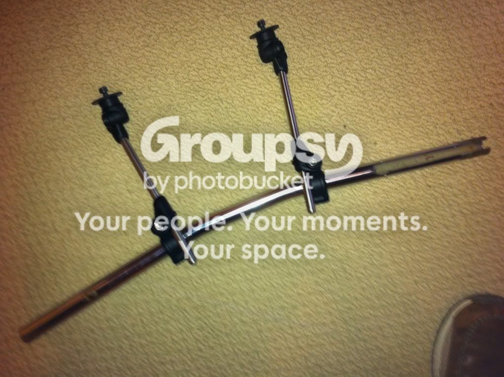

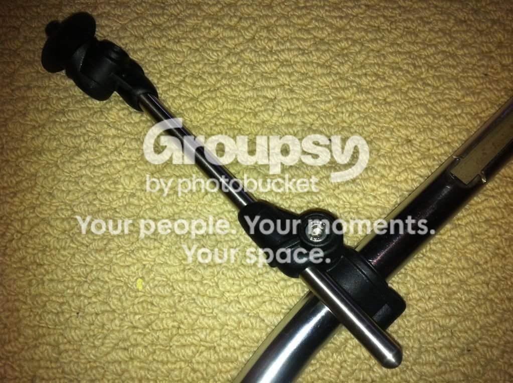

And some pics of the slightly modified windshield mounts mounted to the drag bars.
The advantage of those windscreen mounts are that they are fully adjustable, and are strong as hell. So I'll be able to play with the screen/windscreen angle/placement to get it optimal. And I could ride this thing at top speed all day without having to worry about that metal plate coming off and decapitating me. The disadvantage is they are a little more clunky looking than I'd like. Who knows, if I don't like it I'll fabricate some mounts with the optimal angle to fit to the headlight bucket turn signal mounts at a later date. :-\ As i said at the start, I'm just plugging away at this in between all the other crap going on in my life and I have no plan. We will go wherever this little beast takes me...
