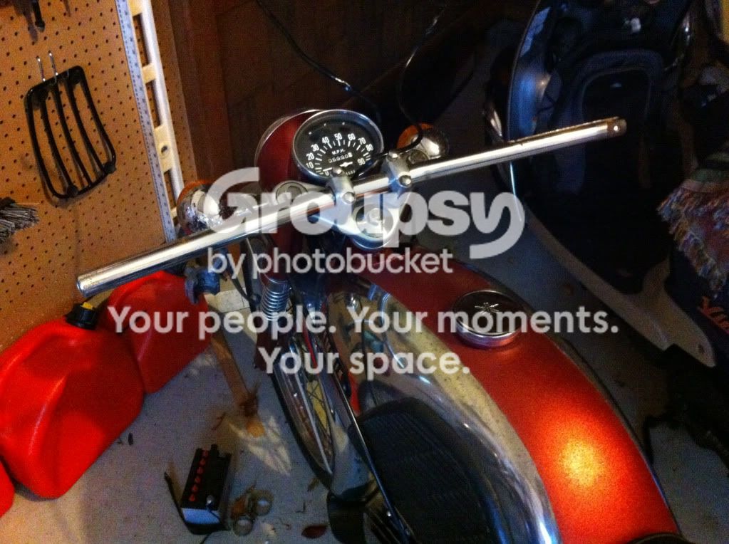

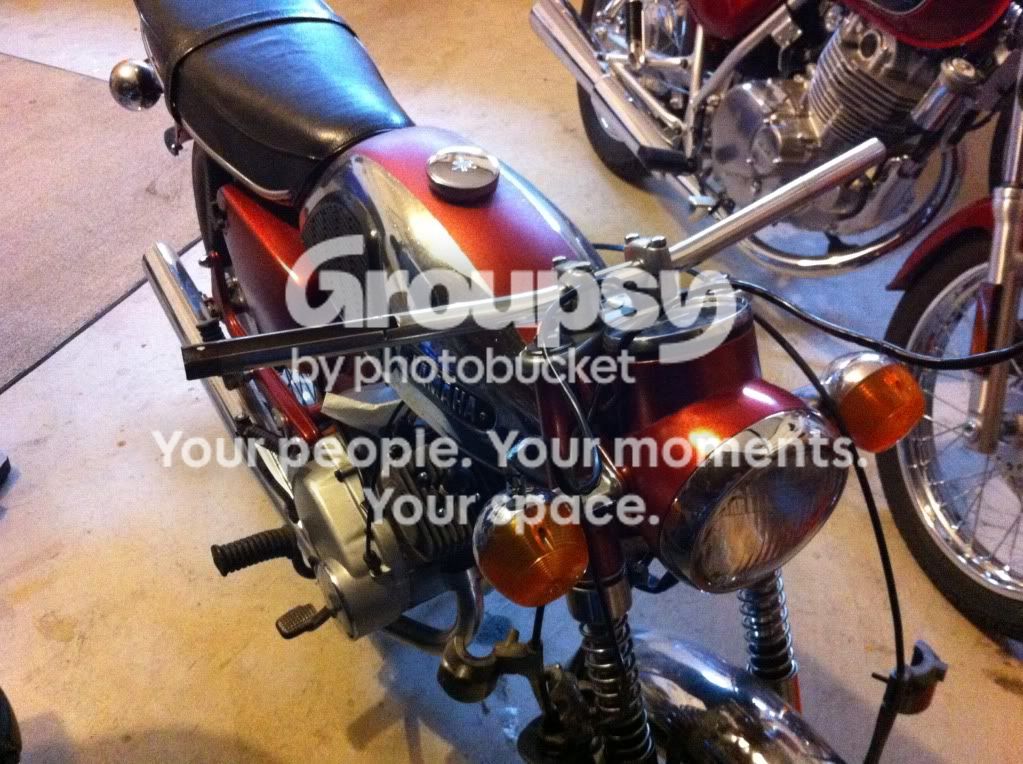

I was at a Halloween part last night. It was fun but today is not. Dr. Frankenstein is hungover like a dog today. Even so, I dragged my ass out of bed at noon and figured I would tackle getting the drag bars on. It took several hours which was a lot more than I had thought. Perhaps it was because I felt so bad, or perhaps it was the fact that the wiring runs through the handlebars. The wiring cover tubing was very brittle and stiff from age and was difficult to get out. I ended up spraying some cable pulling lube I had for work to get it out. Basically I had to disassemble the turn signal and high low-beam switch and feed the connector contacts through the bars as well. I bolted on the new drag bars and they definitely give the bike some "attitude" and they are reasonably comfortable too. It looks like clearance with the tank will be OK - but it's very close. I'd say about 1/16" with the brake and throttle. The clutch, throttle, and brake cables are way too long, so I'm going to have to do something about that. An added bonus, my mounts from the windshield look like they are just going to fit, with about 1/16" of clearance. It's almost like I planned it that way but the reality is it was just plain good luck. I'm too hungover to operate a camera so I'll get some pics posted tomorrow before I head out of town on a sales trip.
