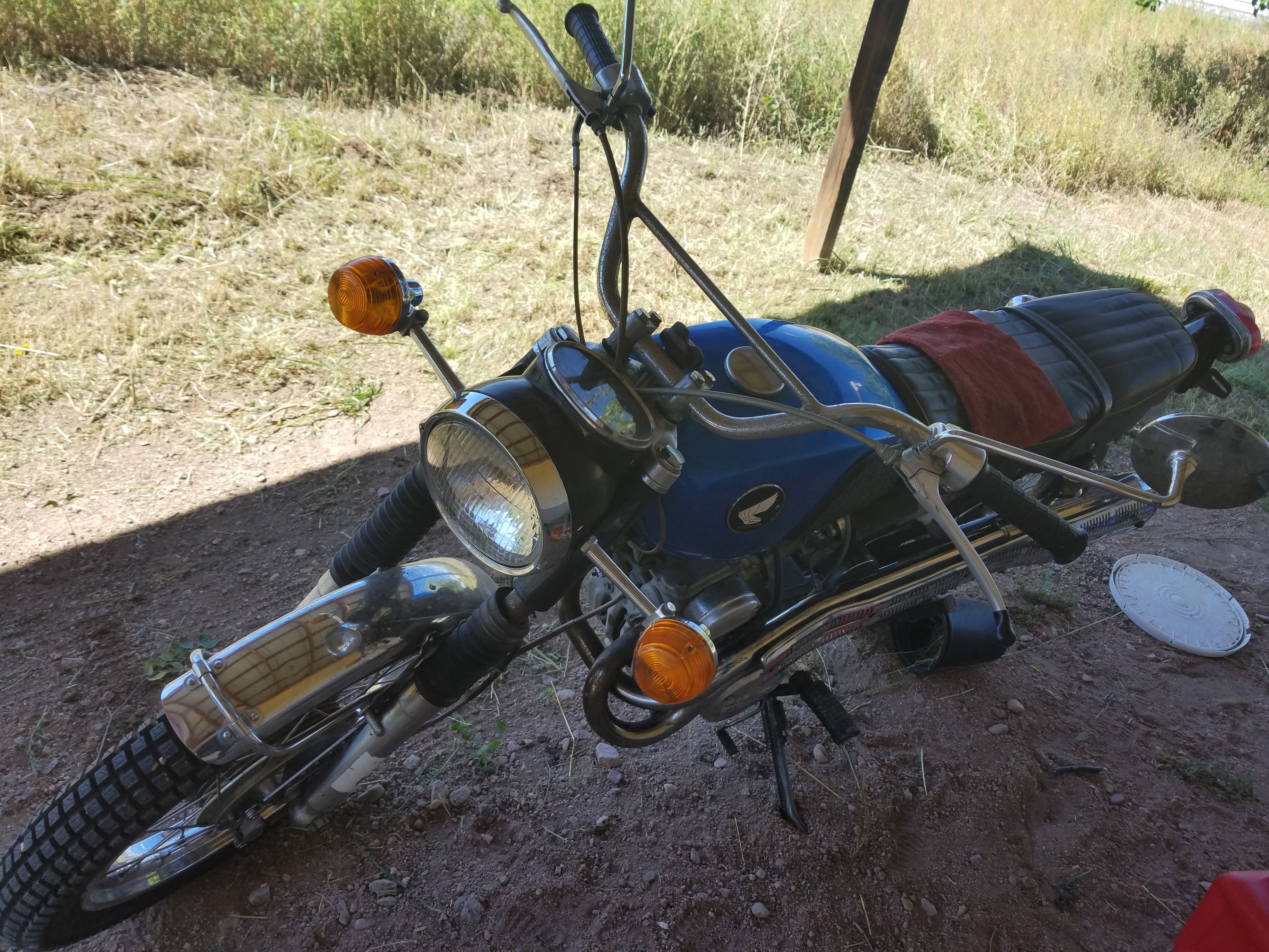

I just bought my first motorcycle, a 1968 CB175. I guess it's a sloper according to the year and the title, maybe someone can confirm with the only picture I have right now.

Yup. "Sloper". Note how the jugs angle forward instead of vertically. Great bike. TONS of info online as they are super popular machines in the vintage road race world. I actually have a 68 175 sloper motor and frame. May have to do something with it someday lol.
Looking forward to seeing what you come up with and welcome to DTT.
Re: 1968 CB175 repair and build
How can you tell the difference? It's titled as a CB, so it'll end up registered as a CB and I'd prefer to correct that if I can.
CB...
Different tank, low pipes, etc...

VonYinzer said:
Check the VIN on the frame neck...
Agree, check the VIN against the numbers shown on this site: http://www.motorera.com/honda/index.htm#y175
Also, based on the little bit of poking around I did, the CB175 wasn't built until 1969, but the CL started in 1968.

About the model designation, it may actually be a CB. They're were some CB's that were dressed out as CL's by dealers as an option. I don't know if that was offered by Honda due to a parts surplus or not. The vin should start with a B if it is truly a CB.

It's a CL after all, I checked it out on the VIN decoder page that was posted.
