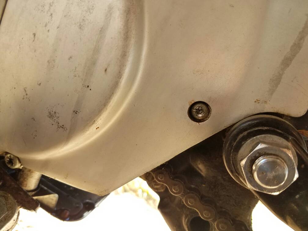

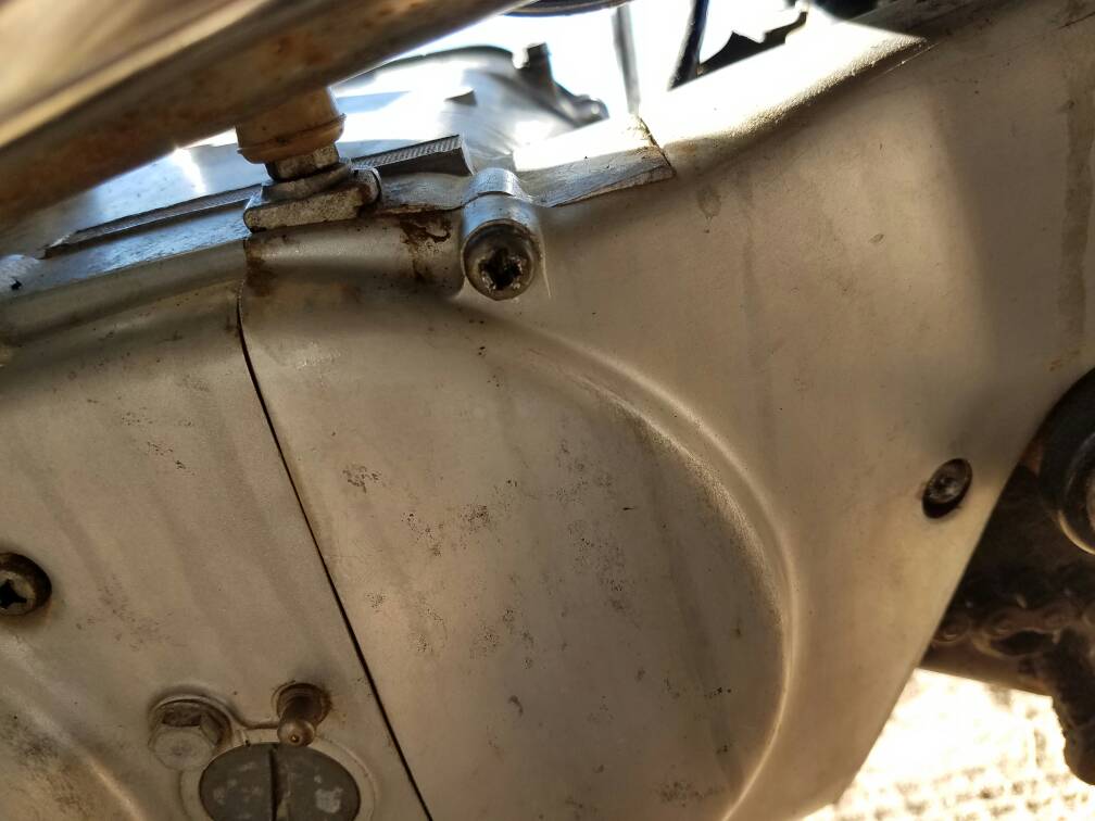

All three of them are destroyed haha, gonna grab an extractor kit and see if that works, and if not I guess I'll have to drill them out and cut new threads in, which I hate doing.

Get a drill bit that's just a hair bigger than the 6mm bolt shaft, and drill through the head of the screws until they pop off. Take the cover off, and I'll bet the rest of the screw will come out by hand. If not, vice grips.
That's the plan! Hopefully I'll get enough of one out without destroying it that I can take it to the hardware store and get some nice new black hex hardware.
