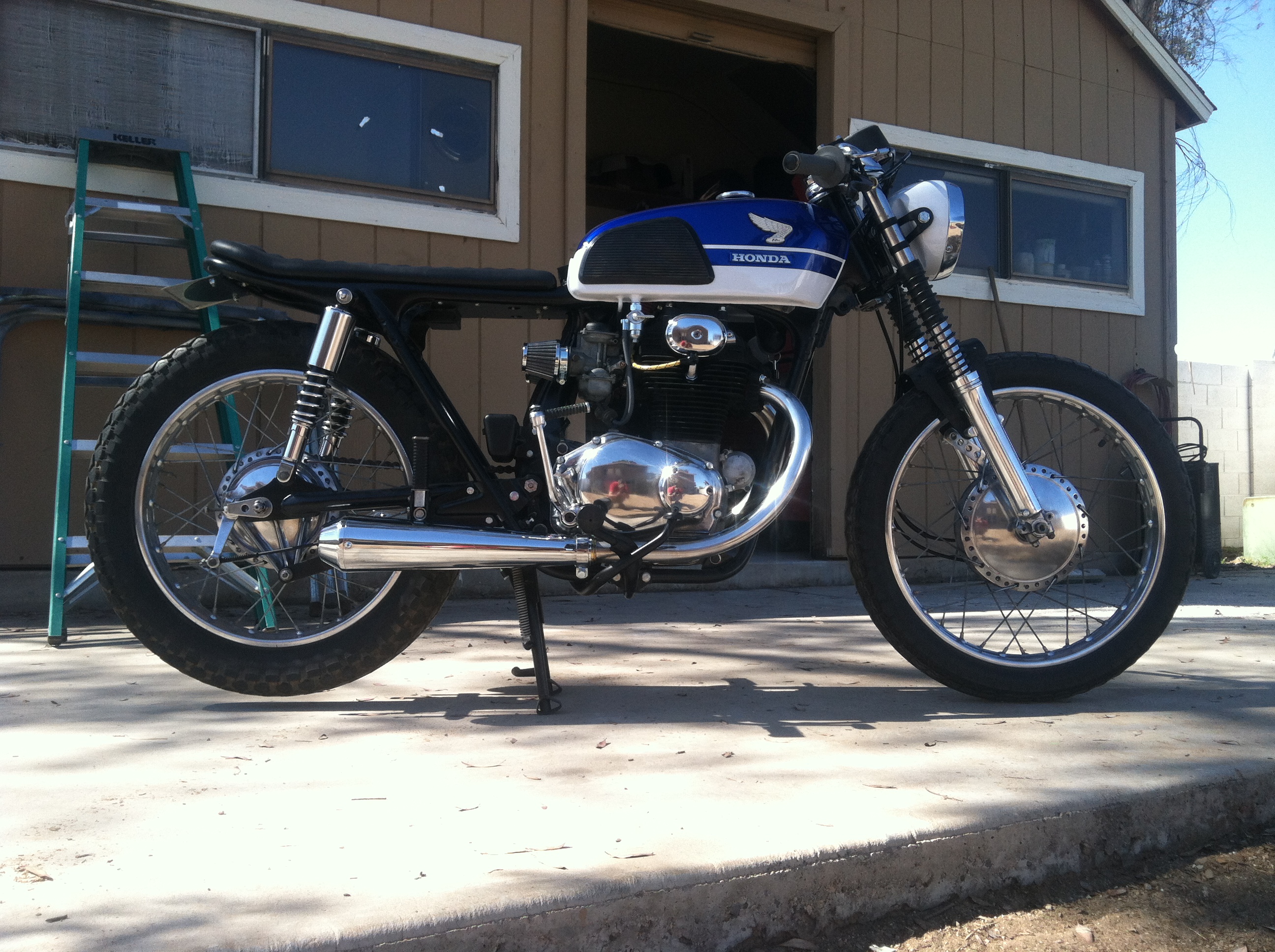

And here are some pics of what i did to the headlight ears i had laying around. I took to adjustable wrenches and bolted the ear to the fork and starting making the bends. Once I had the shape, I used a body dolly and hammer to smooth out the lip around the ears. Then a quick scuff and paint with some VHT epoxy chassis paint and I had the look I wanted in about 2-3 hours.
finally some progress!!! i got the bike fired!!!! She needs some tuning but it felt great to get it running for the first time. And here's some updated pictures. It kinda somewhat put together, just needs some little things done.
