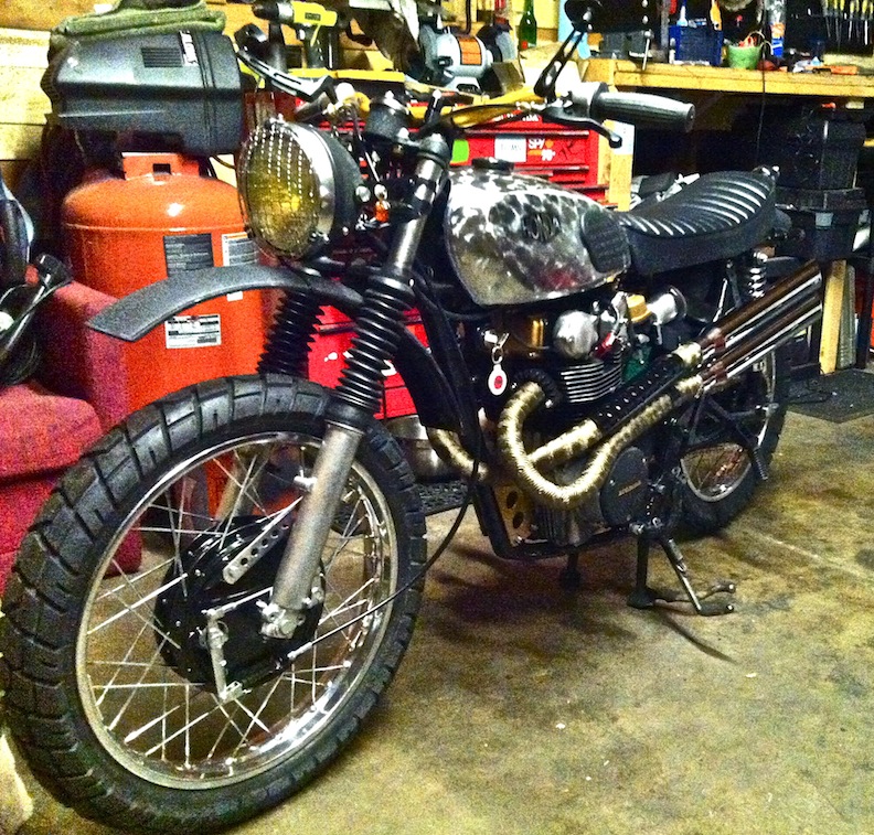

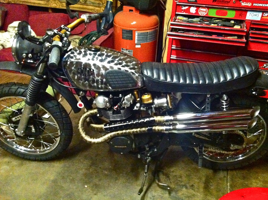

took some pics...shitty ones, but at least they show progress! I still can't get the right cyl to fire...i've confirmed spark, but haven't pulled off the stator cover (as that causes oil to leak) to do the timing yet...but i think i've got the cam timing all lined up, so thats an accomplishment. Also, haven't messed with the carbs, so that could also be an issue causing my non firing right side.
Cheers,
H

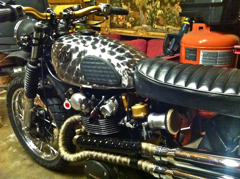

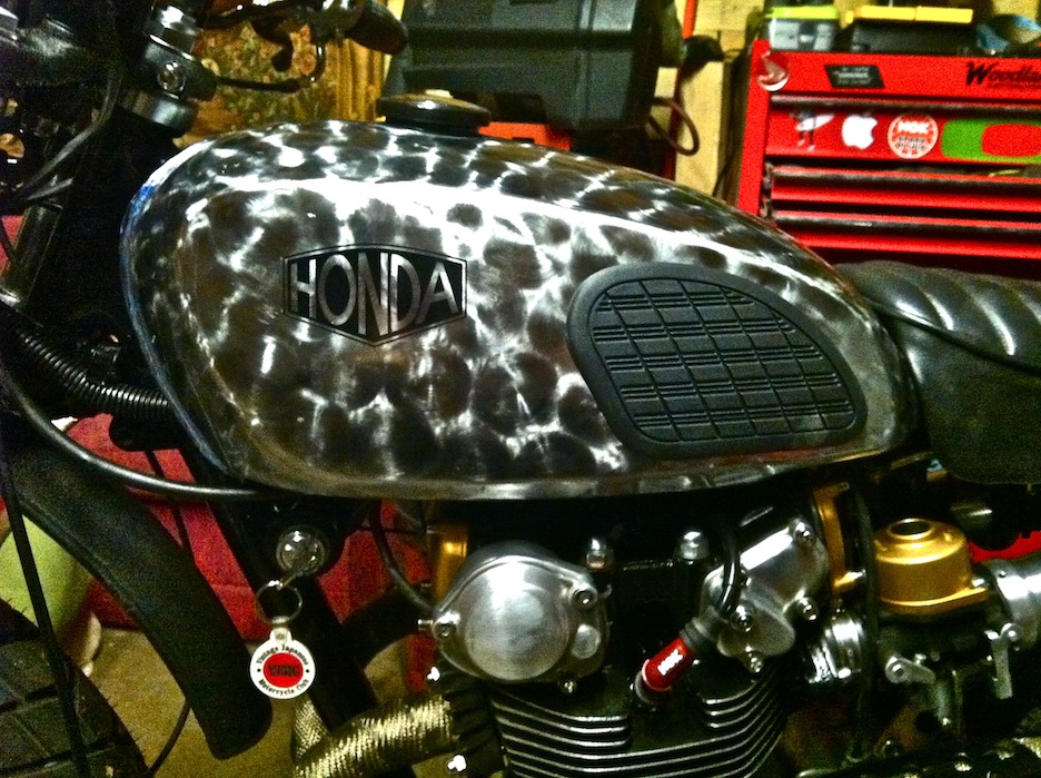

sick build. like the tank, the light and the wrap
can you say after using the spraymax 2k on the tank how much of a gloss increase it gave it vs when it was bare? scale from 1-10
thanks

Re: 1970 Honda CL450 (project kickass)
VHT metallic engine enamel for the plates and engine parts. Gloss on tank was increased significantly when spraymax 2k was applied. i did use the "high gloss"
